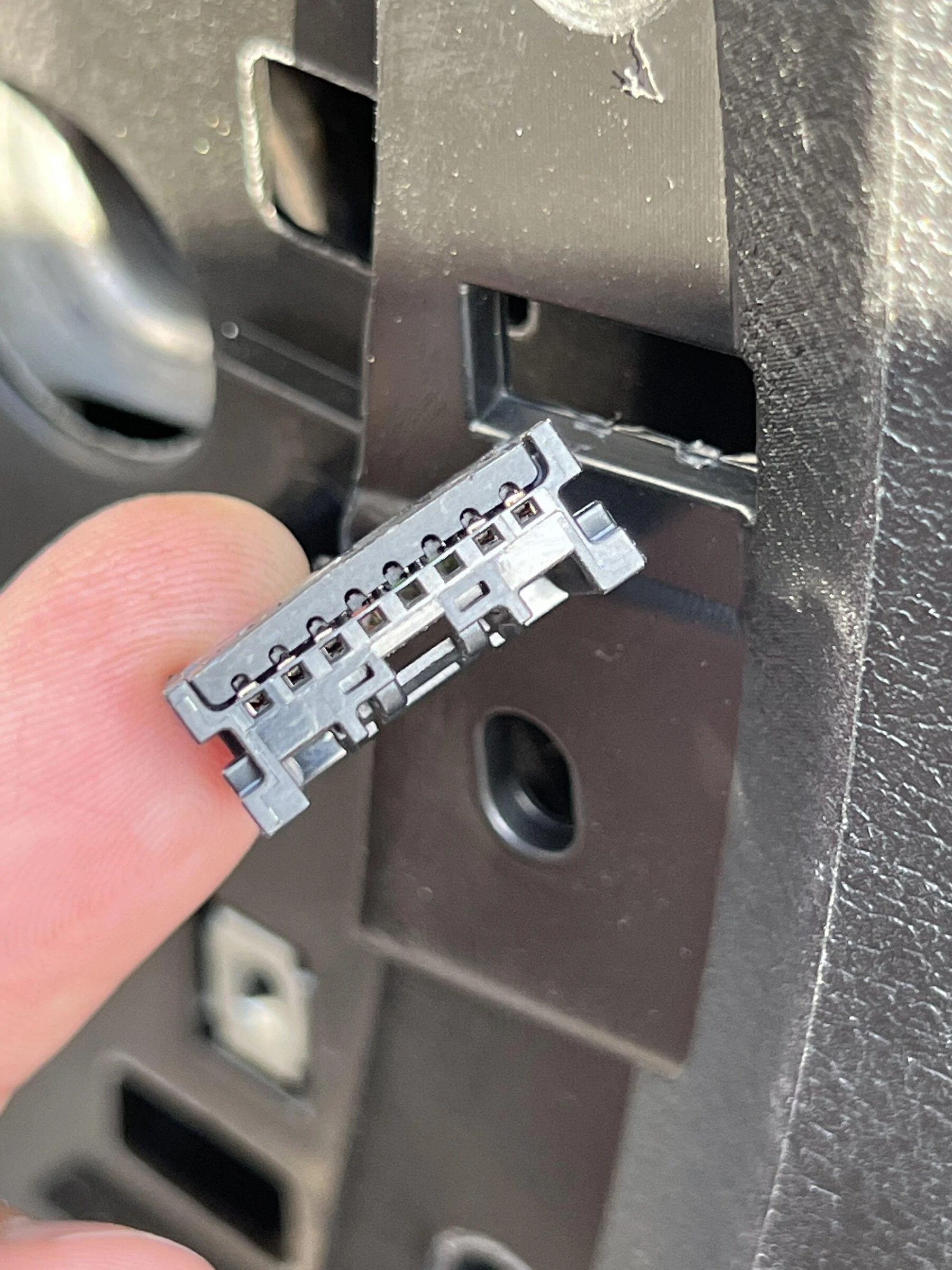

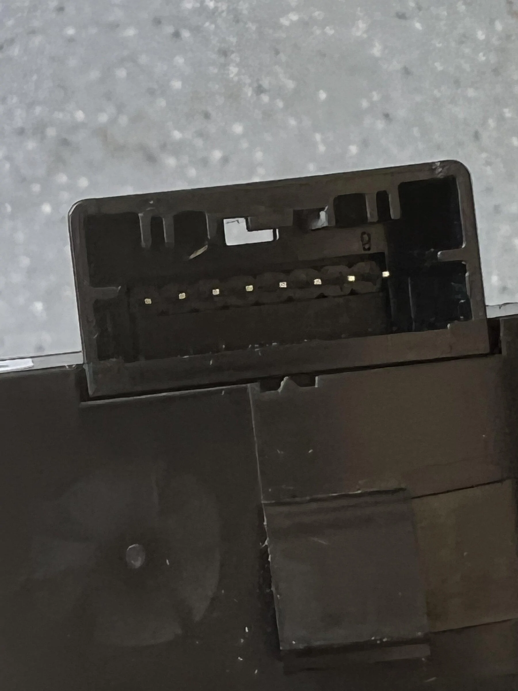

I’ve been patiently waiting for 6NU24TX7AB Headlamp Switch Bezel to complete the 115v AC truck bed power switch. It’s been four months and still no word on when the switch bezel will be available. I’m prepared to relocate the inverter switch (68370049AA) but I’m hesitant to cut and solder an extension. Does anyone know where I can buy a matching 8 pin connector? Thx ?

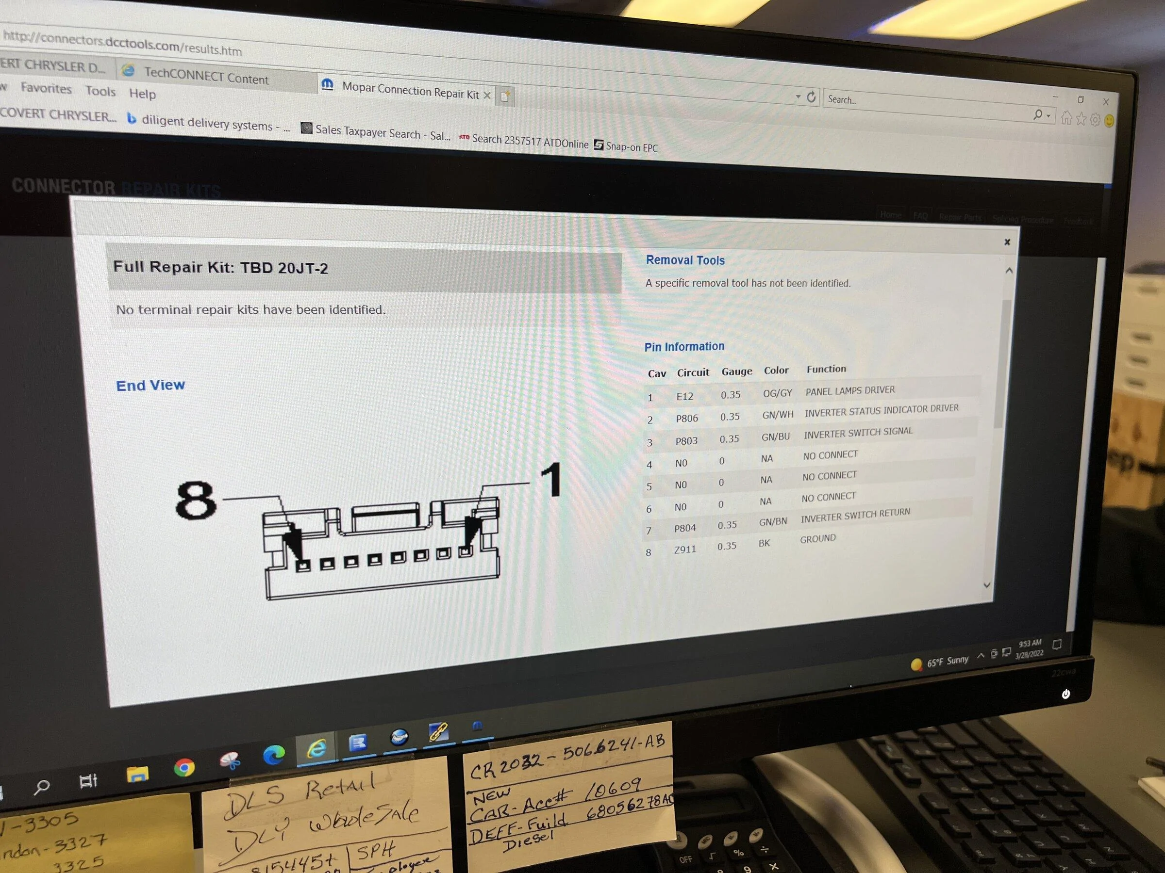

Hopefully today I'll cut and solder to extend the switch. Attached is the pin information for the switch. *I've given up on finding a matching connector.

are there any numbers on that connector? I've been looking through a lot of resources lately to buy some of the special connectors needed for my restorations and while looking, I see things that look similar to yours here and there. Often there are numbers on the connector shells (the plastic part of the connector the pins go into)

Thx for trying. Only a 8 on the face of the connector.

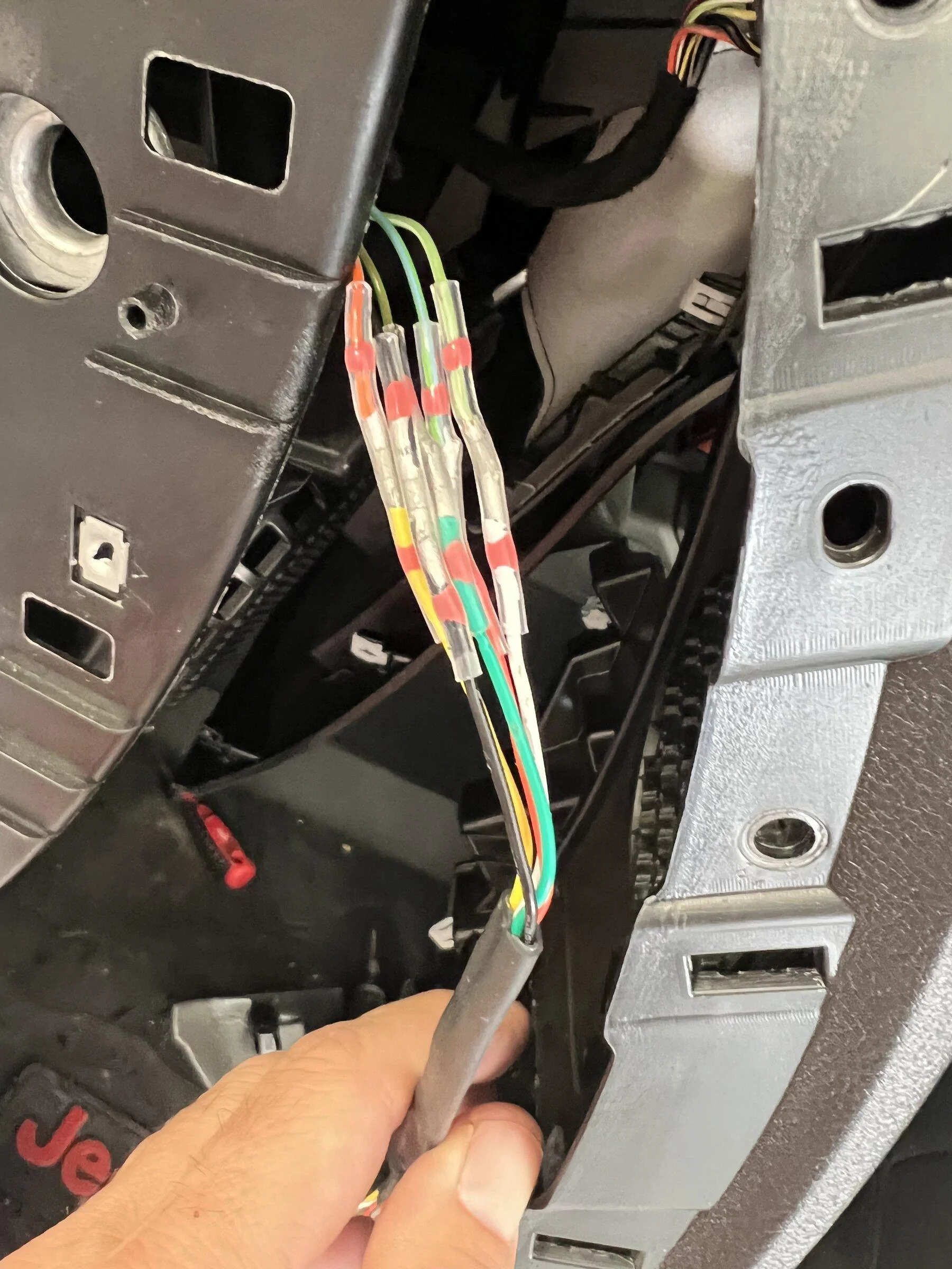

Missed out going to the Moore Overland Expo this weekend. I had motivation to cut and solder on an extension today. It works!

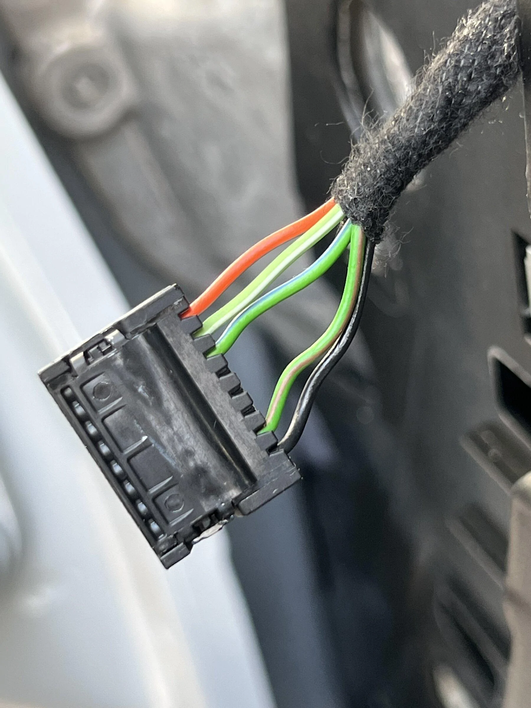

The issue is: the dashboard harness which has the lights command plug, doesn't have pigtail with a plug to be connected to Inverter switch when added below the light command (that pigtail should come taped to the lights command wiring)
I went to the dealer and they said my Jeep came with harness 68525802AC, and in order to have the missing wire and plug, I should have the Harness 68525802AD
The missing plus is 3 wires plug, so I assume it is just an ON/OFF switch
Anybody knows where do I get the power and what should I feed in order to run a line to add the missing circuit?
