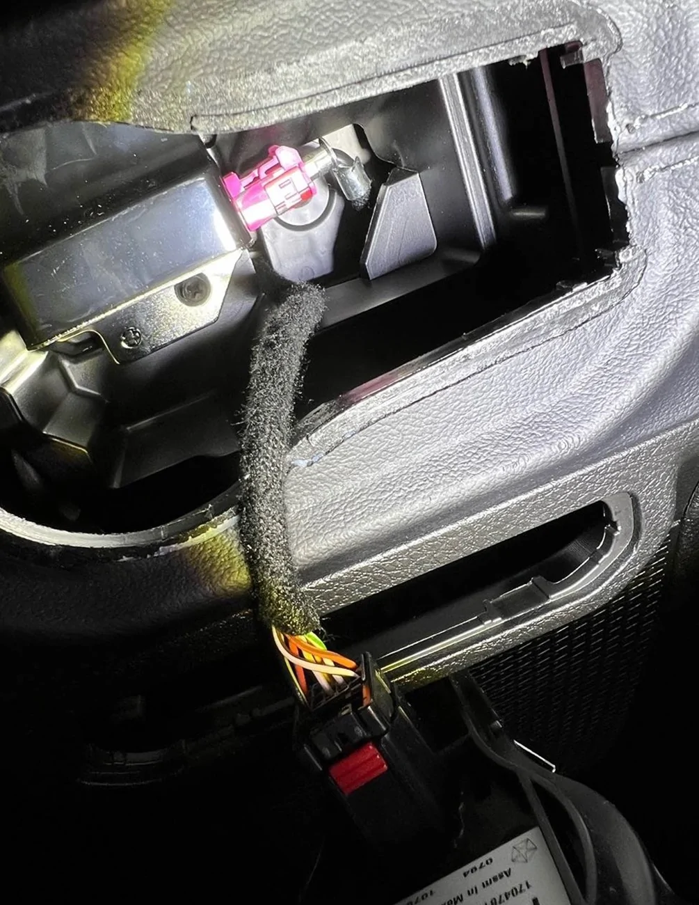

I purchased the 115v 400w inverter kit from Mopar for my 2024 Gladiator Sport S. I got the outlet mounted and the harness connected. But for the life of me I cannot find the harness to plug the on/off button in.
Jeep Gladiator 115v Bed Outlet IMG_0805

Did this a few months ago on my 24 Rubicon. It was tucked way in the back of the speaker, toward to the top. A long needle nose plier helped grab it.
