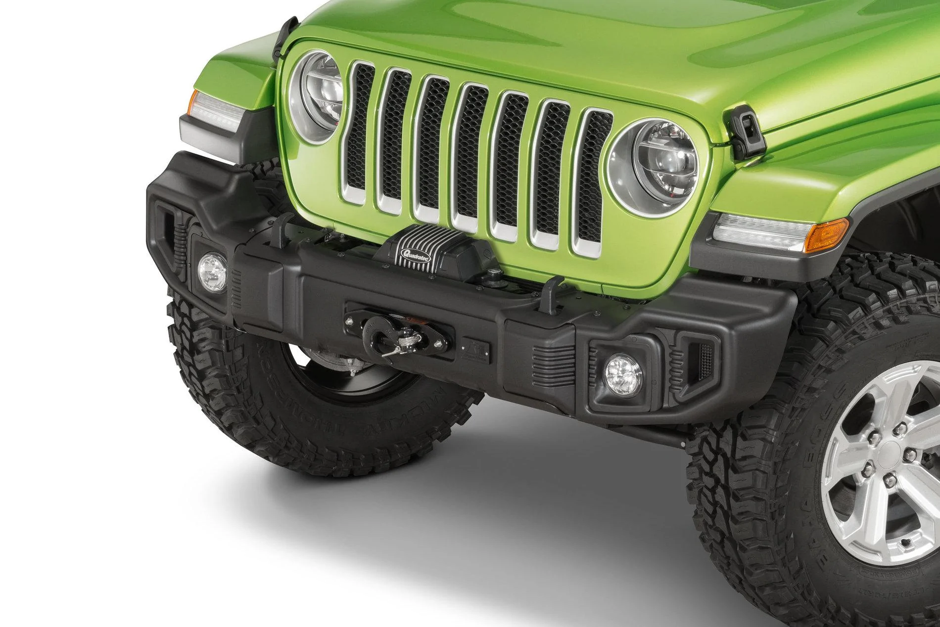

Prime reason why I went aftermarket. I love the look of the Mopar steel bumper for after everything you need to mount the winch AND the price of the bumper, it is definitely cost prohibitive when stout aftermarket bumpers can be had for half the price of just the mopar bumper.
Rugged Ridge mount worked on my Mopar bumper.
I went with the Mopar bumper because when combined with the Smittybilt X20 winch the winch sits below the grill and does not impede airflow at all. The bumper/winch combos seen on other JLs and JTs all seemed to sit a little higher than the bottom of the grill

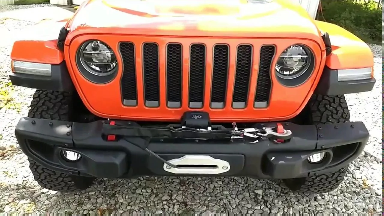

That's what I'm after - LOW profile, not up in the grill, stock look. (Not that it would necessarily cause over-heating I'm not going there), but I still prefer the low profile and would rather not mess with the grill appearance.
The Rugged Ridge bumper seems like it would even sit lower, and close to stock but has poor reviews on quality/fit

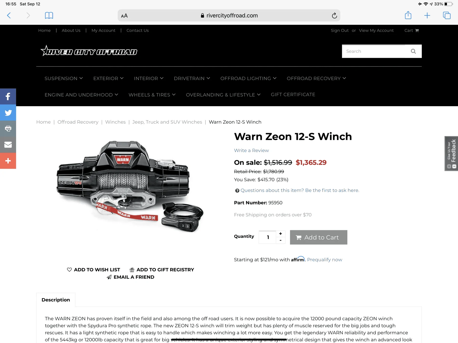

What type of vehicles would a 12,000lbs winch pull. I see a lot fo people with 12,000lbs winch and I’m wondering what are they pulling with it.
My Superduty diesel had a 16.5 Warn on it when I sold it. Worked well and never left me feeling underpowered.
