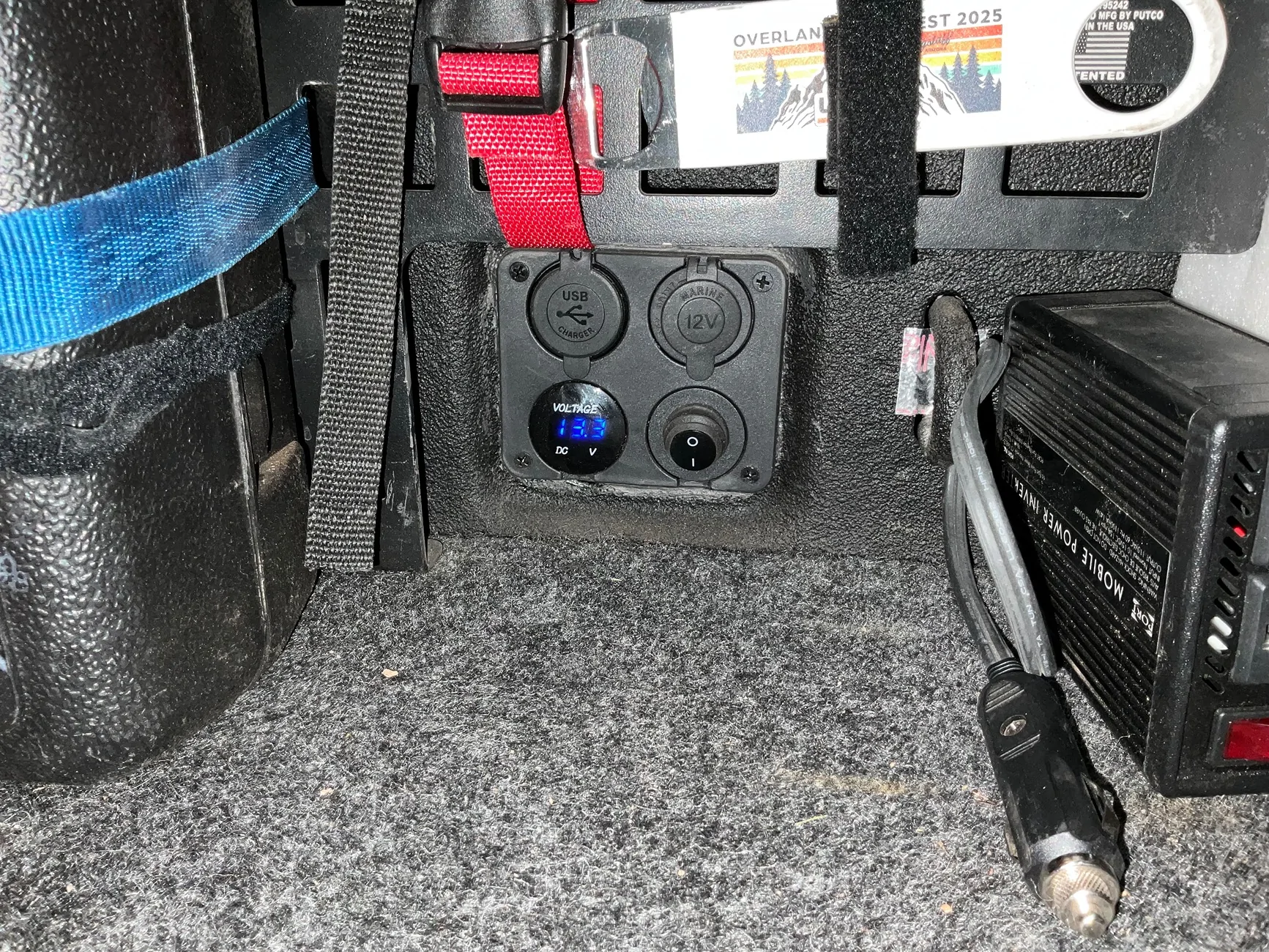

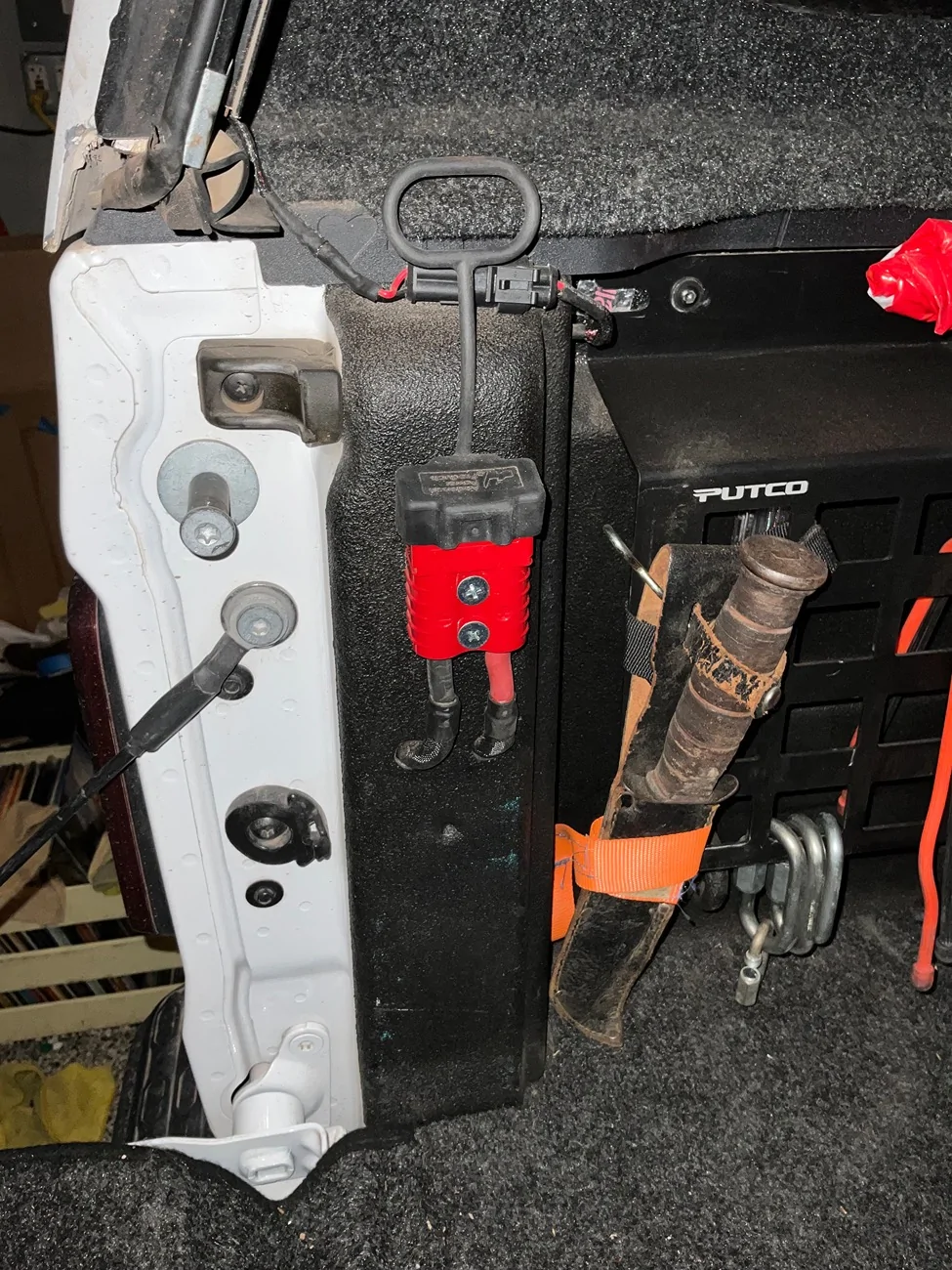

I ran my rear Anderson along the drivers side. Used 4ga, attached to the main battery via a circuit breaker/solenoid. On the pass side I upgraded the Amazon switch/power, mounted in 110v location, with better wire, circuit breaker to the battery.
This is what I did as well. Wire is very expensive and I used all copper jumper cables and cut the ends off for wiring. For whatever reason, buying the heavy gauge cable for this by sourcing from jumper cables was much cheaper. Be sure you read the descriptions carefully and get 100% copper cables.
