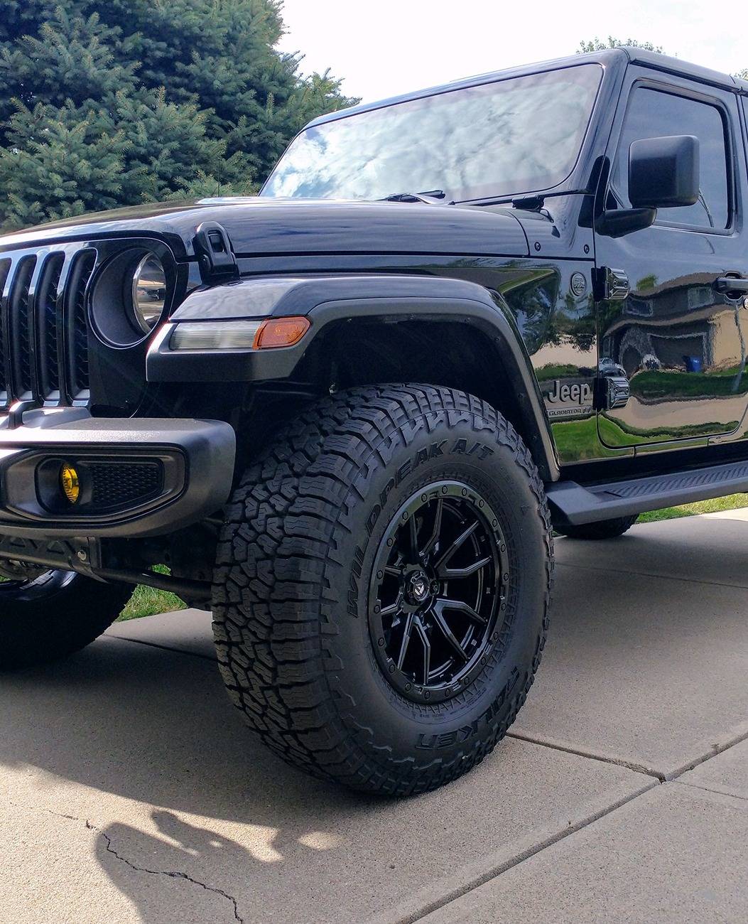

Yes Mopar lift, stick wheels, and 37x12.50/17 work however not all 37 inch tires are true 37, read through some of the other previous forums depending on which specific tire you plan on going with

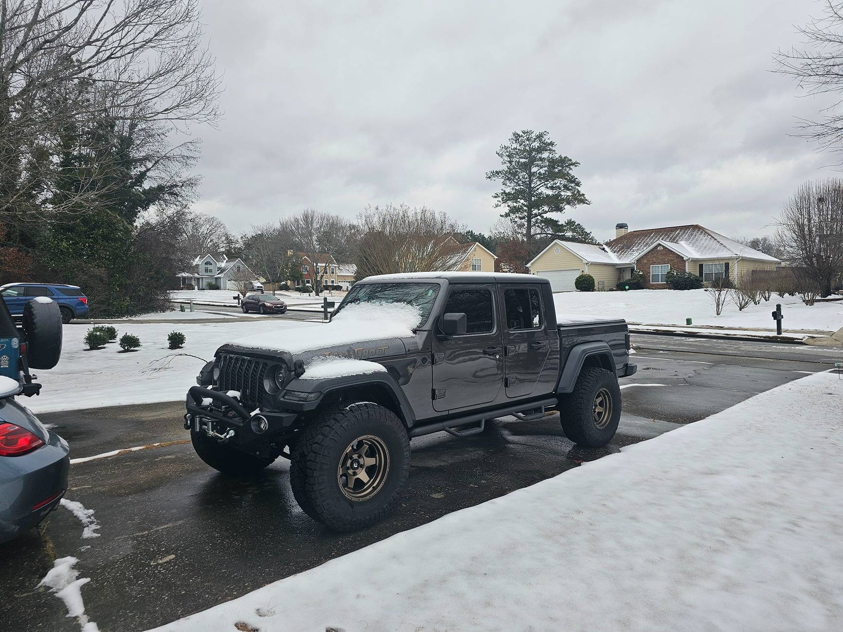

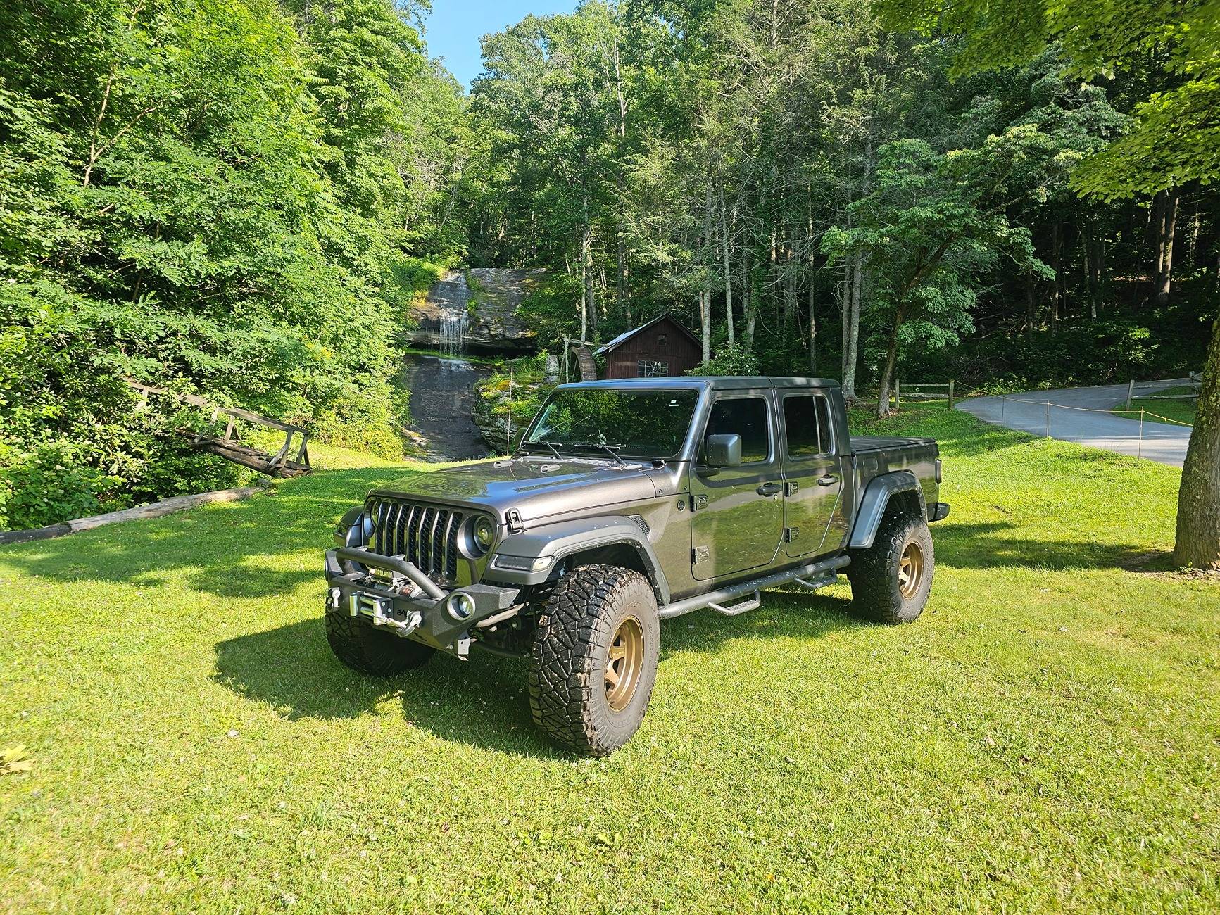

Hi there! Im getting the Mickey Thompson Baja boss AT!
