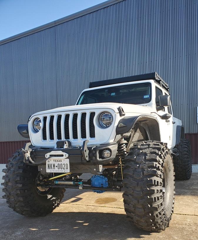

Oh I am very aware of Tank customs and Chris on this forum. He has built some sick Jeeps. I just didn’t know they had a hydraulic steering kit available.

Whao whao whao, we cant be tooooo nice, they haven't sold my take off D44 axles yet ! Hahaha
Thanks!
It’s not our kit, but a WTO kit spec’d to our liking :beer:

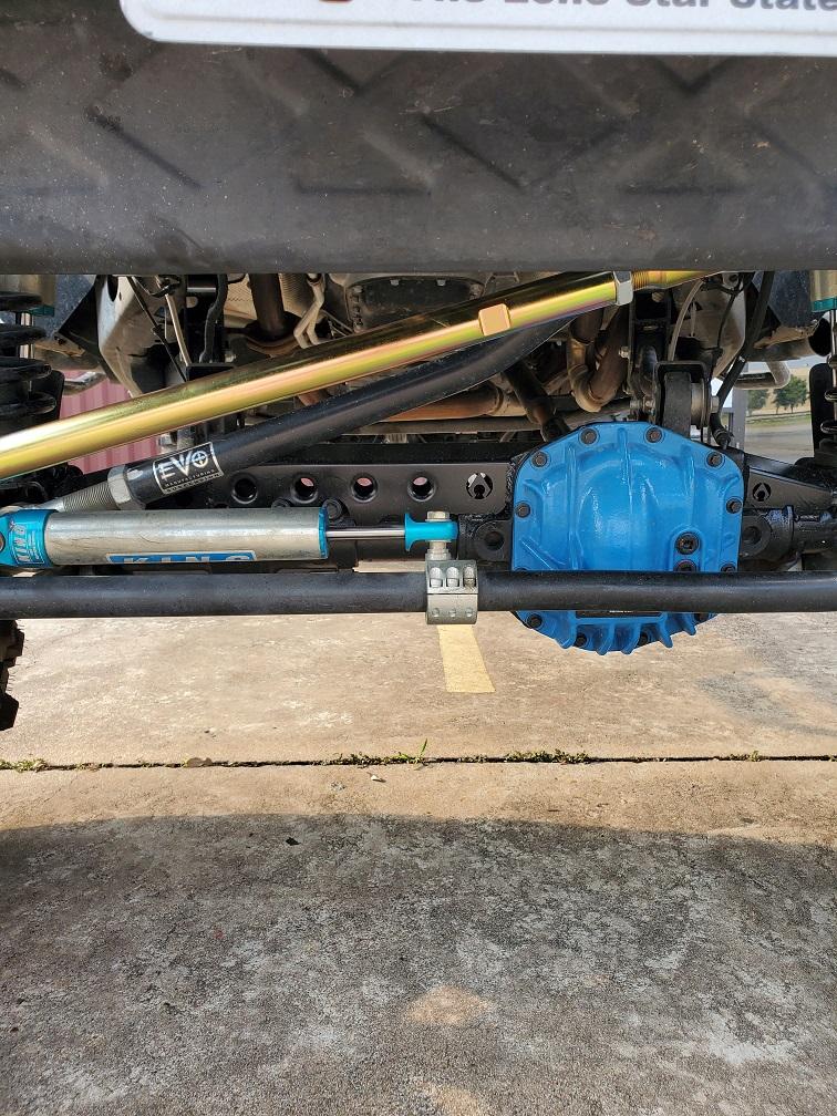

How are you liking the Evo springs? I see a lot of mixed reviews on them with them bowing on the front etc..? Also is there any rake on the rear? I'm looking to swap out my 3.5 MC Springs

No Rake on the rear and rear springs are great. The front springs are not terrible but not perfect. I do have some bowing on the front Passenger side, but the correction pad they sent me fixed it.

I would also add, hydraulic steering has been excellent but make sure someone reputable builds it.

What hydro assist steering are you using? Is it a red neck ram? What steering box etc..?
