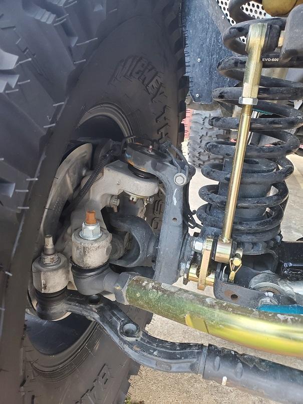

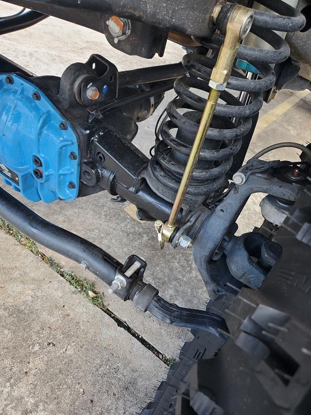

It looks like you are still running a stock tierod but maybe I am mistaken of what I’m looking at, and it could be just the picture angle but it looks like it could be slightly bent. Do you plan to upgrade to a beefier tierod?
Yes, upgrading the whole front. Here is a picture of the current
Yeah I have the RCV shafts, Dynatrac ball joints, and the Reid Racing steel steering knuckles. I’m pretty sure I’m going to be good.
Haha ! Yes, I think you are good ! Very nice

Just looking through your pics, I noticed the drag link and track-bar are not quite parallel. Do you have any bump steer? It could contribute to the death wobble perhaps. I went through it on my other Jeep due to the steering setup I was running, but eventually changed things and fixed it. Hopefully it is gone with the 60's.
Yes, have bumpsteer. I do appreciate the input. I'm sure it is at least contributing to the wobble. I am currently just sucking it up and not driving the truck until I have the 60's and everything else put on.
