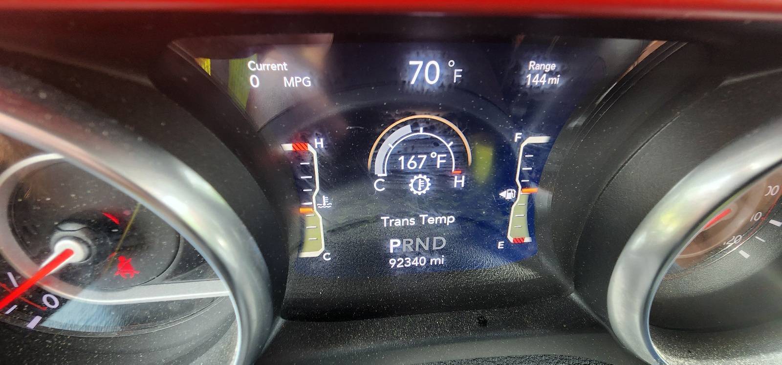

Mine sometimes acts funny when cold . If it is cold outside I shift manually first 3 gears then flop to D and it dont miss a beat after that. But mine has 92,340 miles on it
Mine started in the cold and only the first few minutes, but it kept getting worse. Im at 75k. It started around 70k, but i drive a lot, so 70k was like a month and a half ago.
Are you on factory size tires ? I'm not and I do believe mine is due to the fact I need to get a tazer ? there ya go I brought the tazer back into this mess ?
