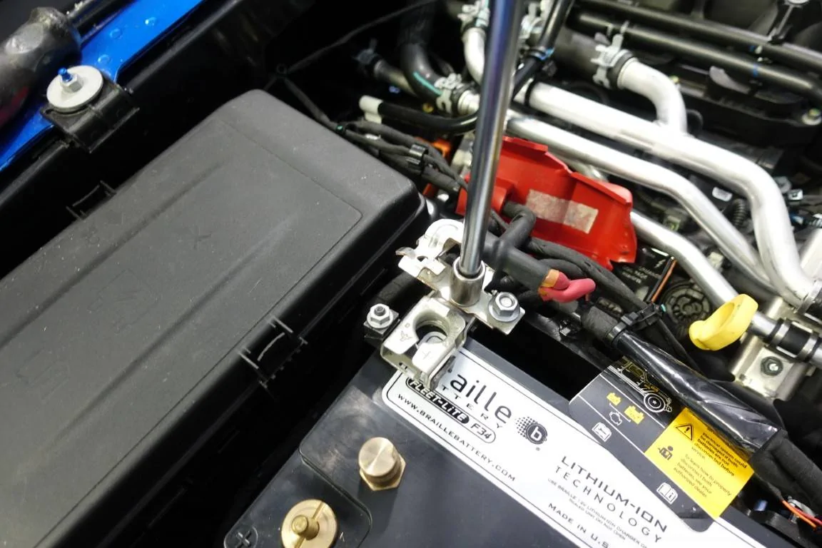

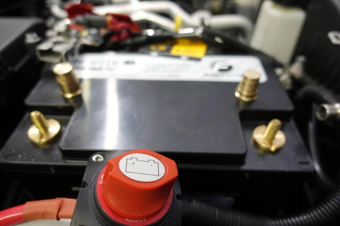

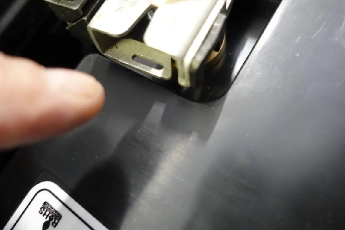

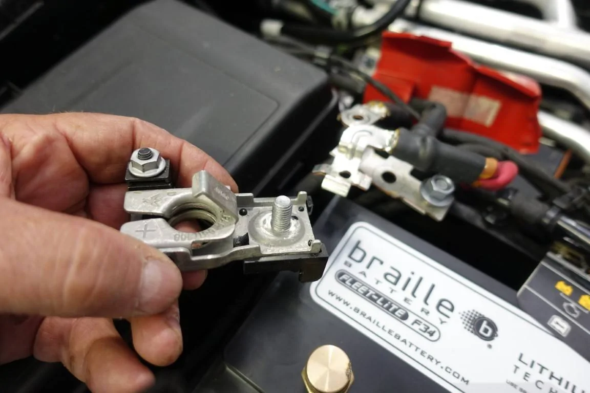

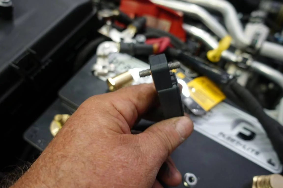

The F34 Braille shipped to me has the posts reversed and on the opposite side of the battery.
Not in the H7 configuration, but that's OK.

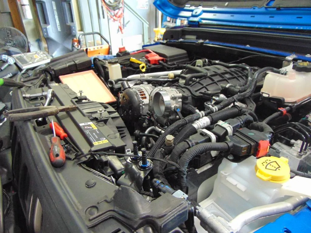

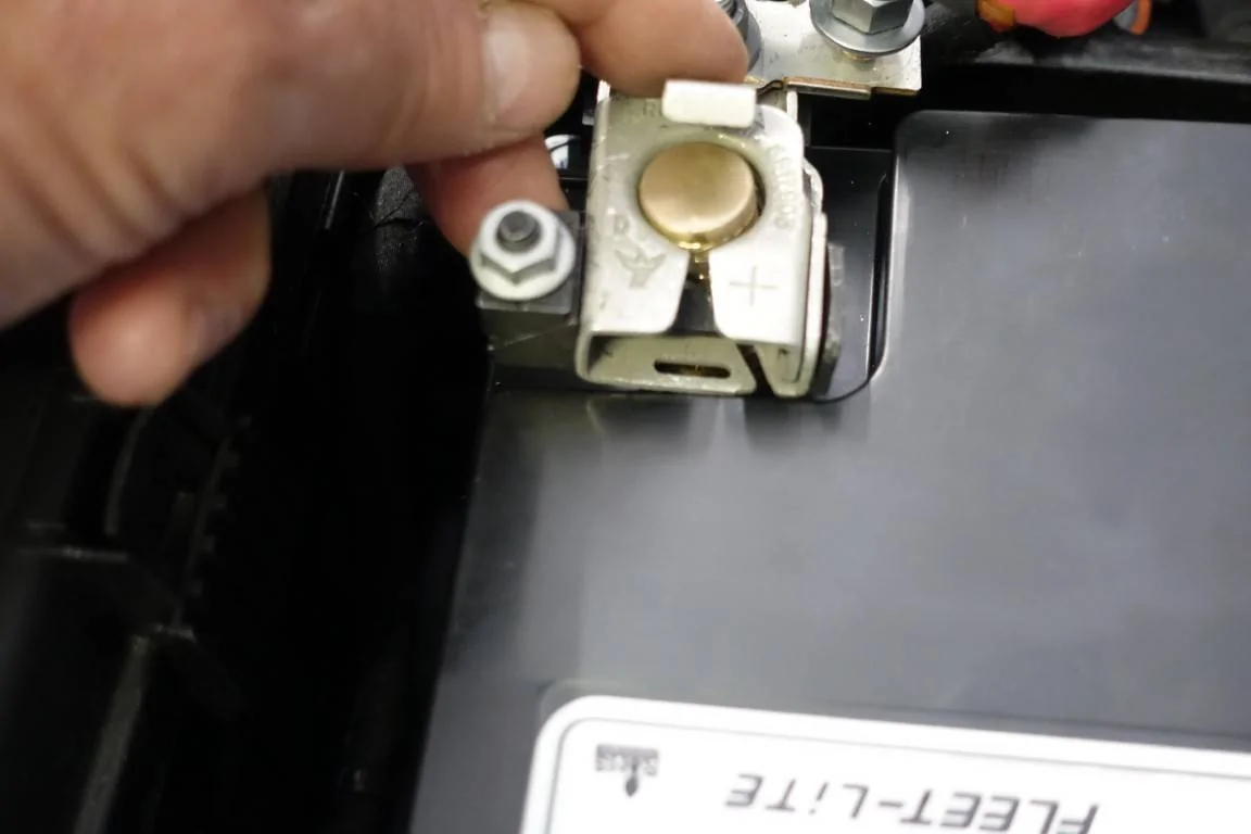

I did take a look to see if everything fit and discovered the factory JT stuff will not physically fit:
(That's a risky positive connection fitted to a negative battery post, without the other post fitted...Or I would been blown up for the second time in my life!)
Jeep Gladiator 2022 AEV Gladiator Rubicon build DSC01157 (Medium)
Jeep Gladiator 2022 AEV Gladiator Rubicon build DSC01158 (Medium)

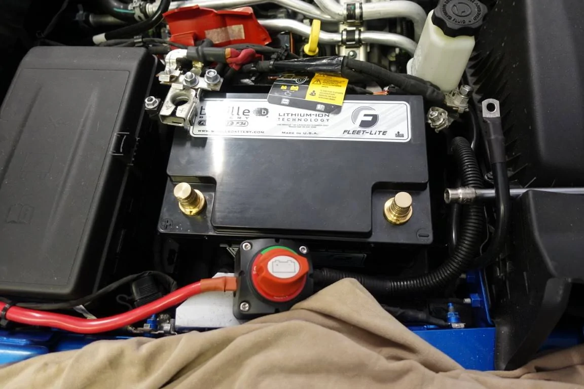

Flipping the battery around gets the polarity in physical alignment:
Jeep Gladiator 2022 AEV Gladiator Rubicon build DSC01159 (Medium)

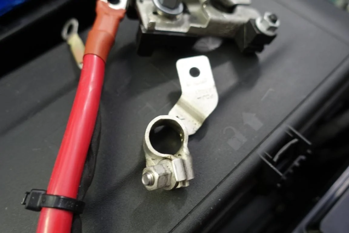

But, nothing will bolt up using the factory configuration, so it was time to change things up some

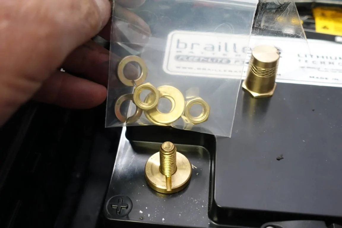

The brass posts unscrew from the battery...
Jeep Gladiator 2022 AEV Gladiator Rubicon build DSC01160 (Medium)

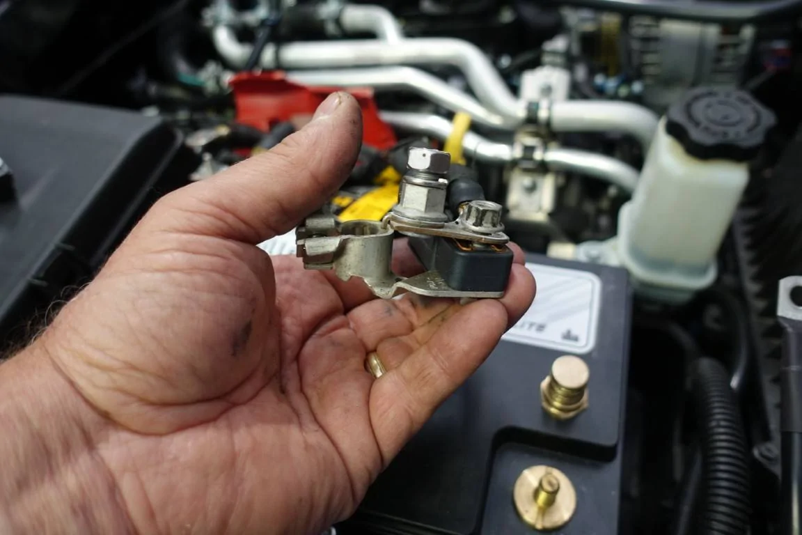

Once I did that, I removed the battery post fixtures from the factory cable assemblies
Jeep Gladiator 2022 AEV Gladiator Rubicon build DSC01161 (Medium)
Jeep Gladiator 2022 AEV Gladiator Rubicon build DSC01162 (Medium)
Jeep Gladiator 2022 AEV Gladiator Rubicon build DSC01163 (Medium)
Jeep Gladiator 2022 AEV Gladiator Rubicon build DSC01164 (Medium)
Jeep Gladiator 2022 AEV Gladiator Rubicon build DSC01165 (Medium)

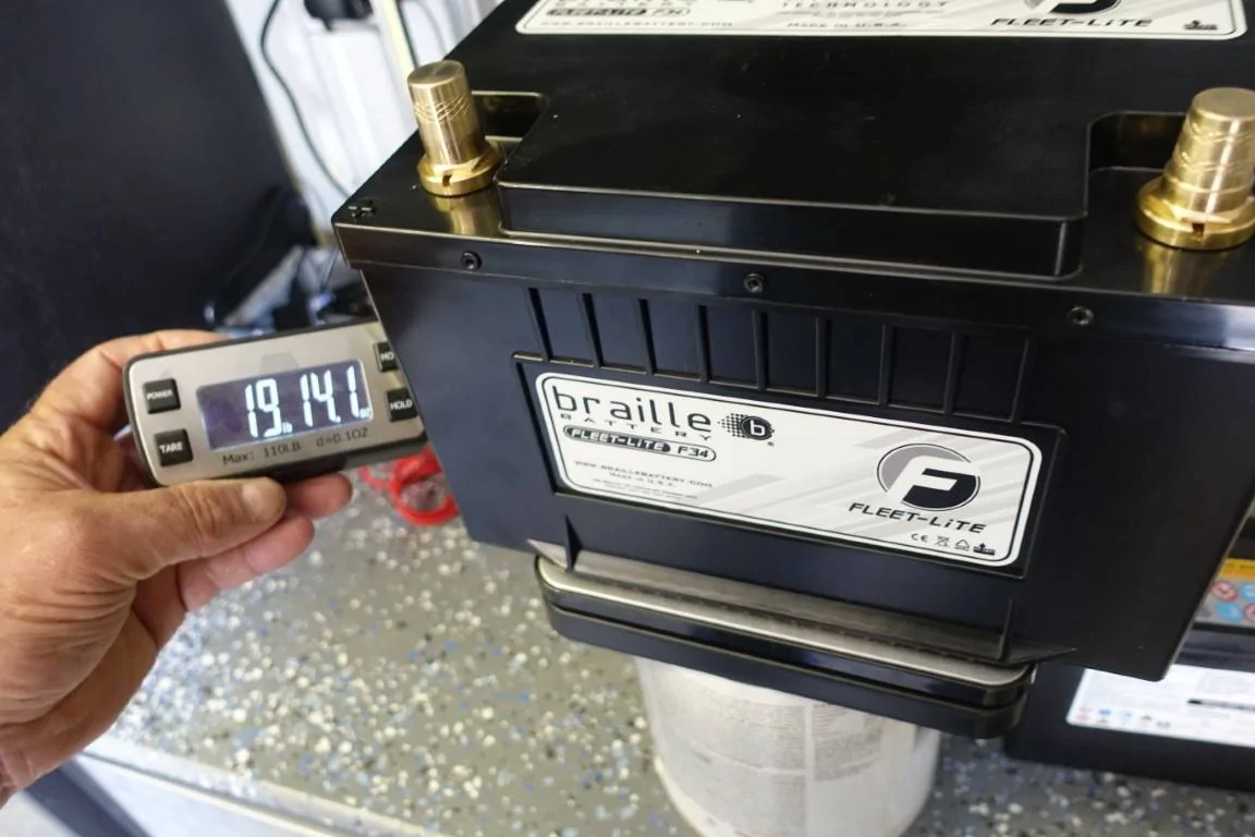

I then weighed those parts which I would not be using
Jeep Gladiator 2022 AEV Gladiator Rubicon build DSC01170 (Medium)

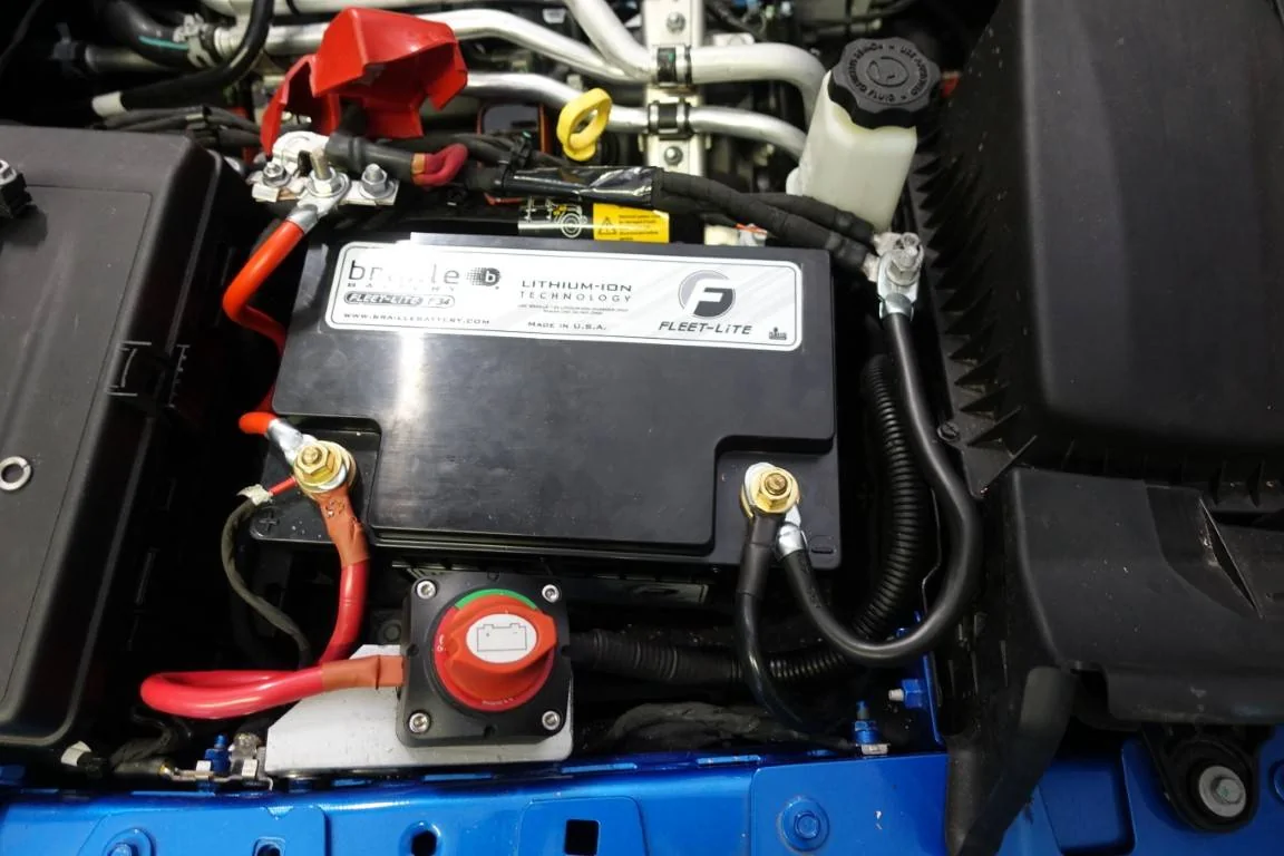

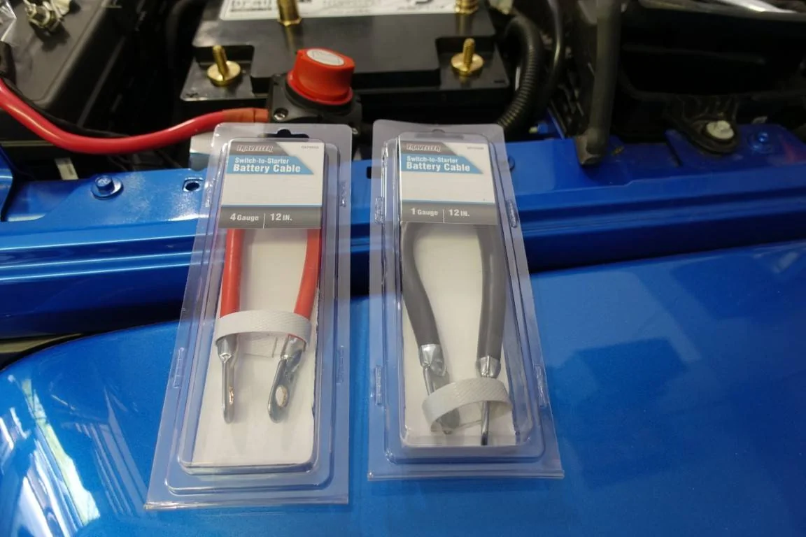

Not too much, but that loss offset the weight of the two 12" cables I had to use to complete the connection
I simply purchased two 12" terminaled cables and connected the respective post to the factory cable, attaching to an original stud...Easy-peasy.
Jeep Gladiator 2022 AEV Gladiator Rubicon build DSC01166 (Medium)
Jeep Gladiator 2022 AEV Gladiator Rubicon build DSC01167 (Medium)
Jeep Gladiator 2022 AEV Gladiator Rubicon build DSC01168 (Medium)

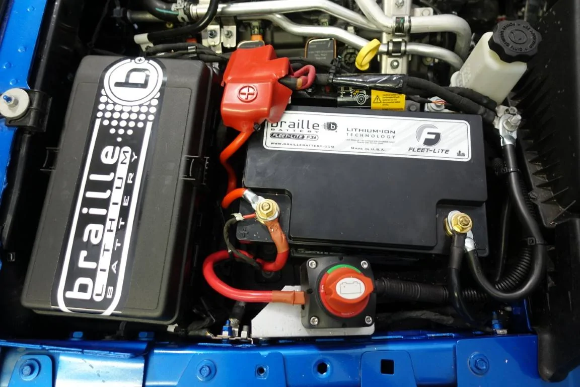

Zip-tied the cables securely into place, cleaned the operation up and placed the 5 horsepower Braille decal onto the fuse panel lid.
All done!
Jeep Gladiator 2022 AEV Gladiator Rubicon build DSC01173 (Medium)

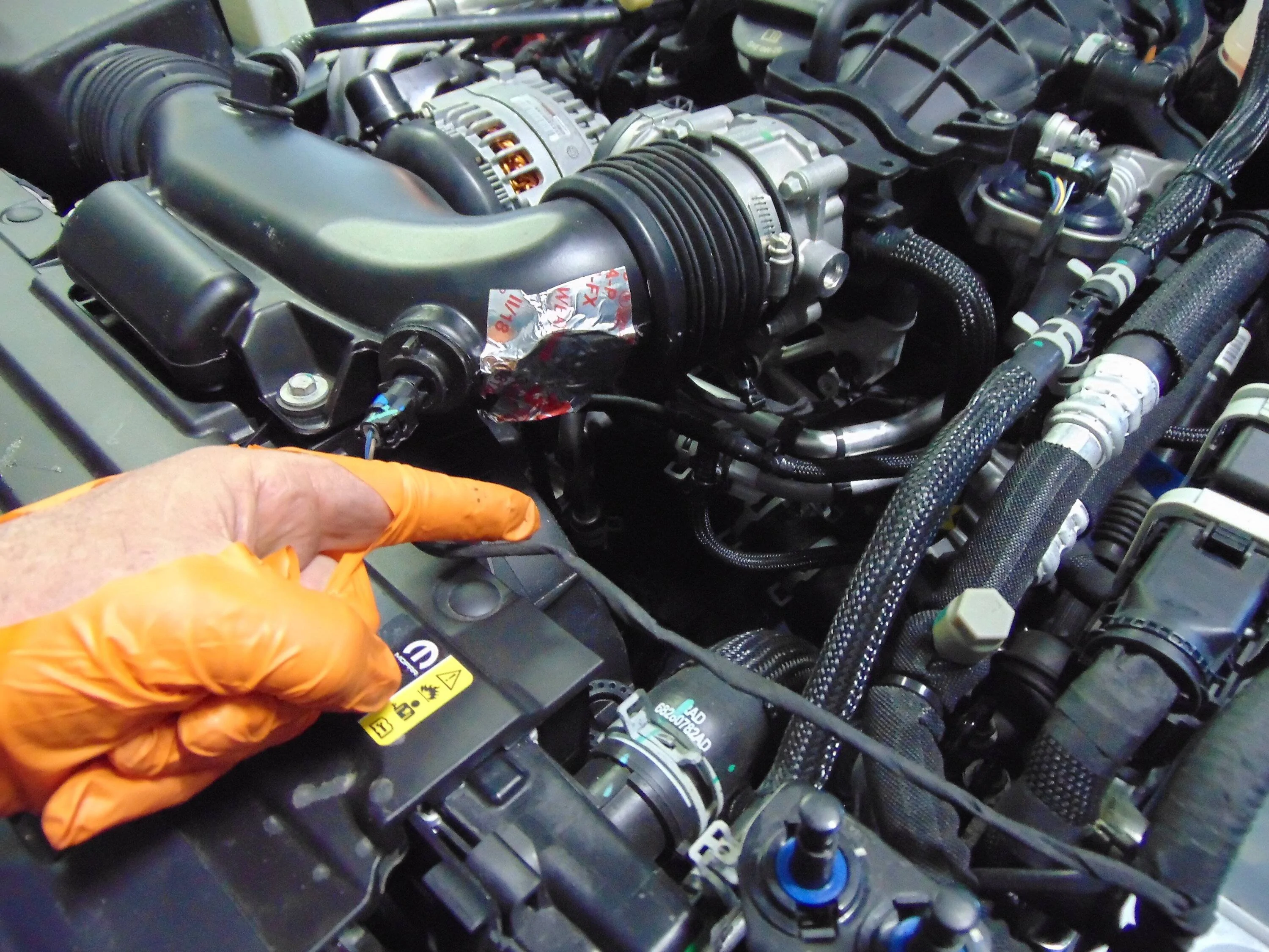

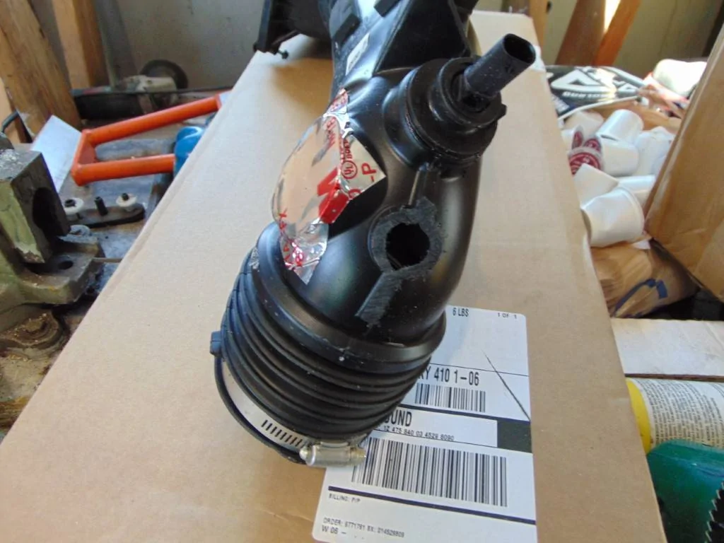

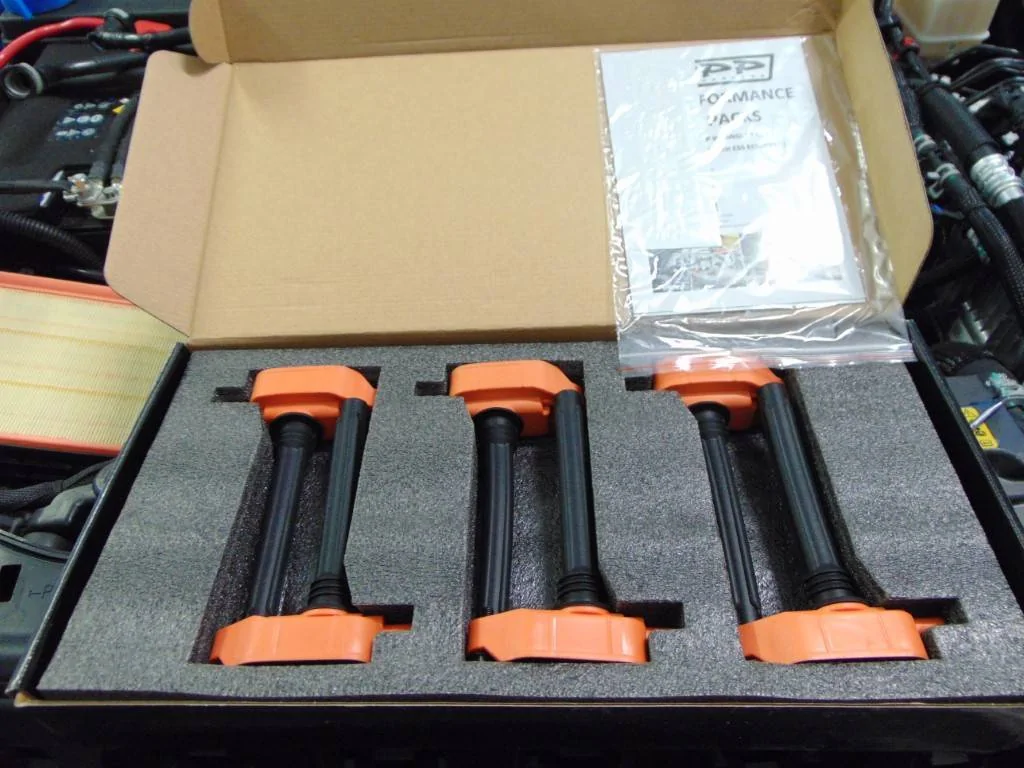

Well, I decided I ought to just supercharge it, but quickly found out I had the GEPC-5 computer and I could not install a SC. But I could install some Ripp ignition coils...So I did
While I was at it, I cut away all those ugly sound chambers from the intake tube, which made that engine sound pretty cool.

Someone may have already asked this later in this thread... but which Ripp coils did you use? On their website, they don't appear to produce them for the JL/JT 3.6L. Thanks.

So, if the truth be known, I did all this yestertag.
Today I drove the Jeep all over while using all sorts of onboard electrical devices. I cold-started it a bunch of times. I drove on the highway, on slow winding country roads, and even in the dirt.
At no time did anything behave any differently than it ever has before. The installation is clean and to my reckoning, so far is a winner.
I will go out on a limb a bit and say, I think the Jeep is feeling like it has more acceleration. Not to do with the battery, but more due to the fact that I have removed nearly 250 pounds of weight from it so far. I am simply pushing one Samoan less than I was before.
