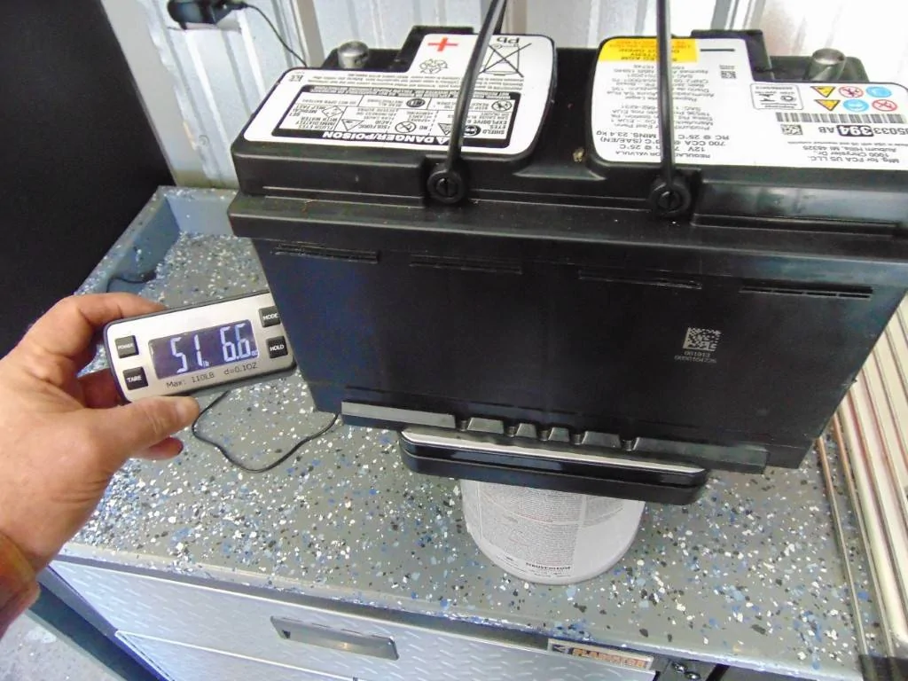

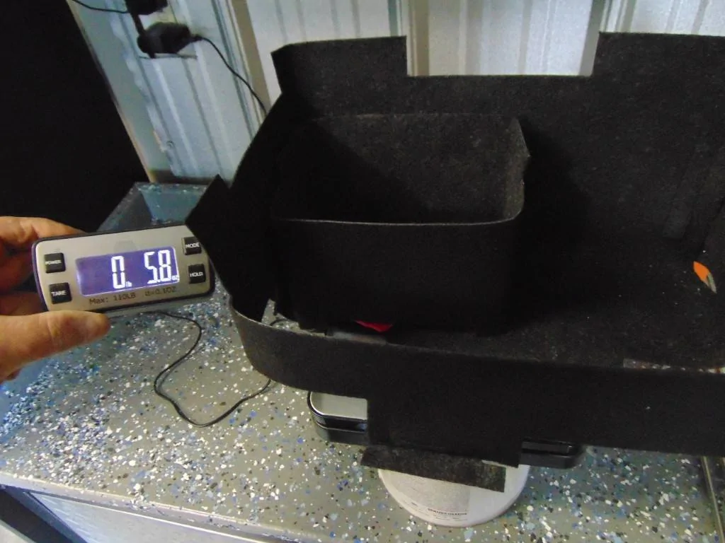

The stock battery is a monster. over 50 pounds!
amd those fabric battery covers are another 50 pounds!
Well, maybe they are like 5 oz...

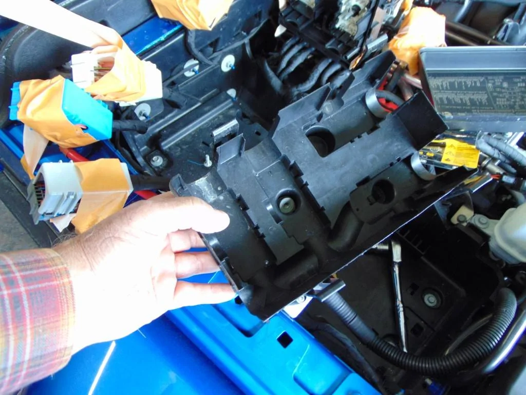

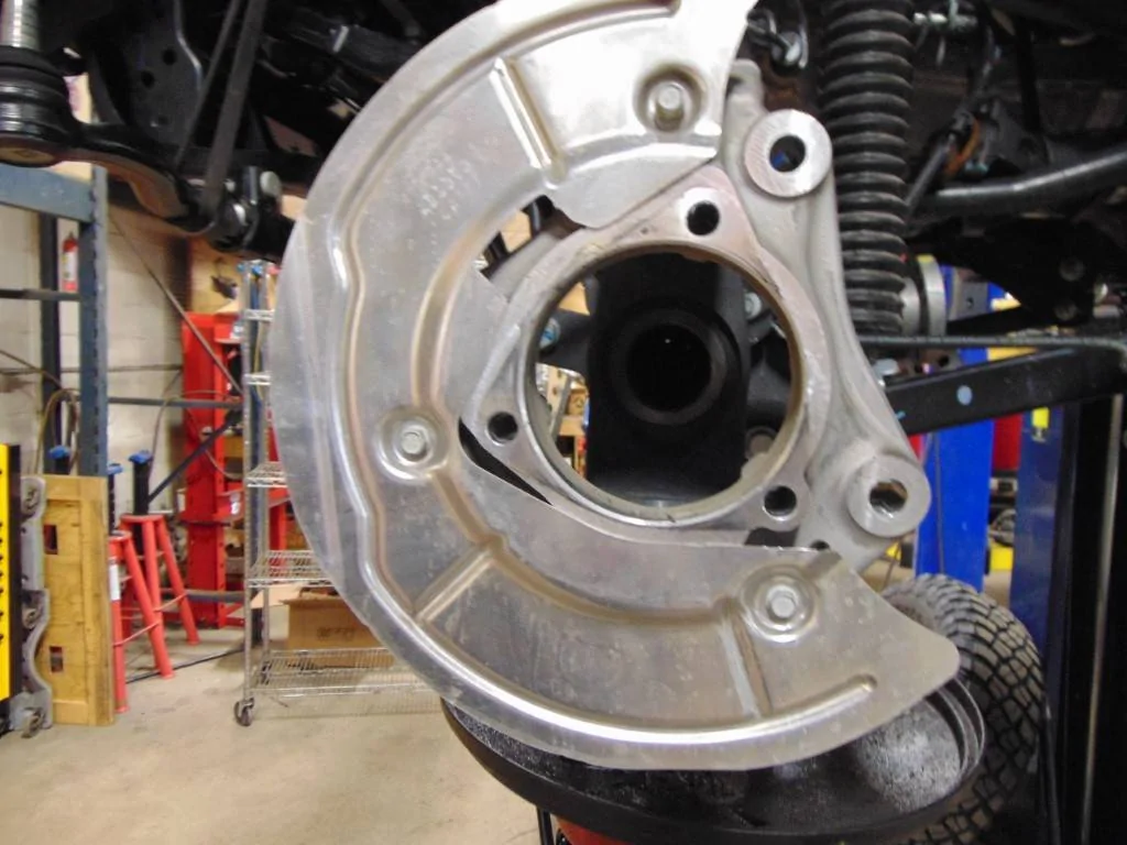

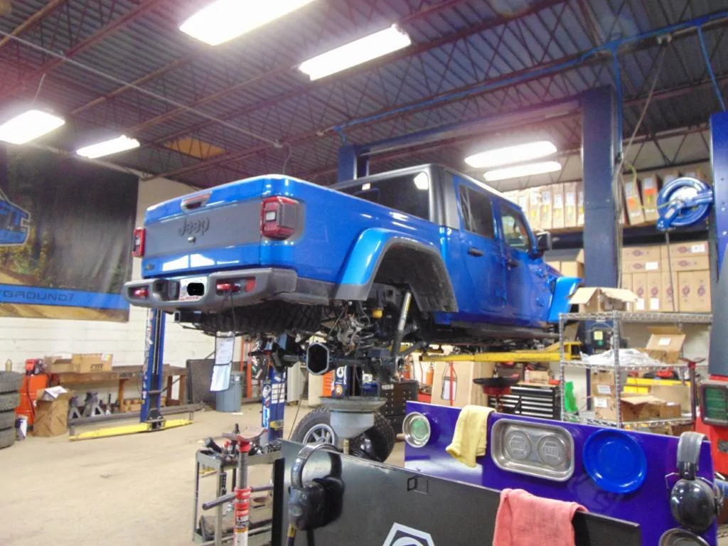

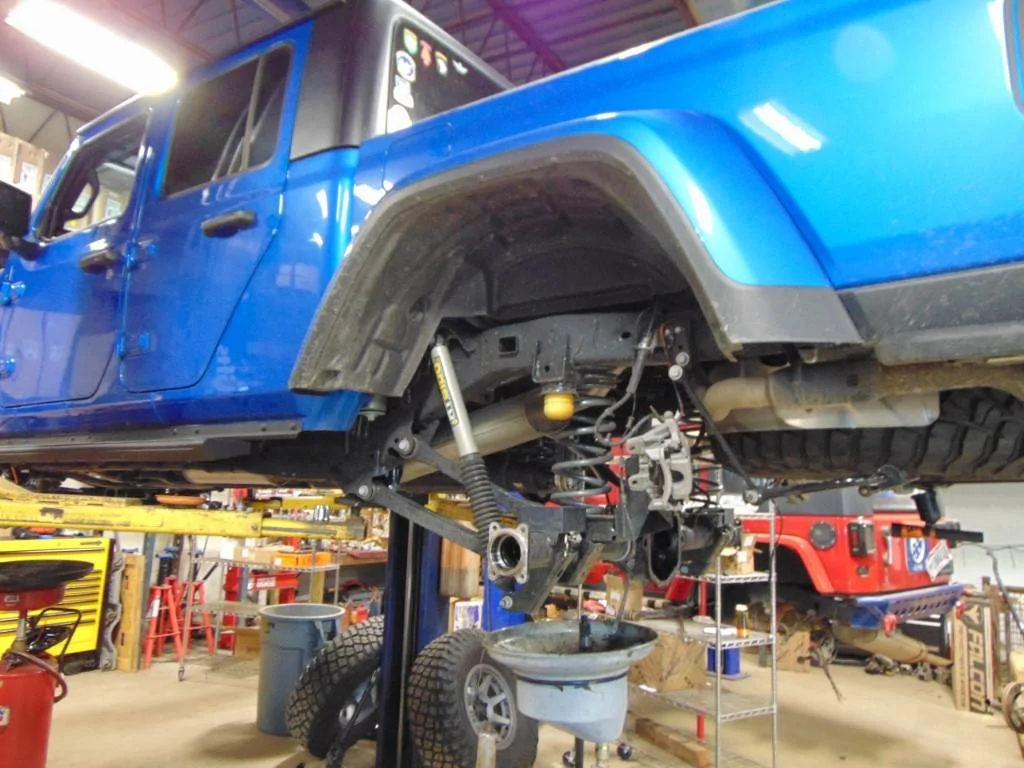

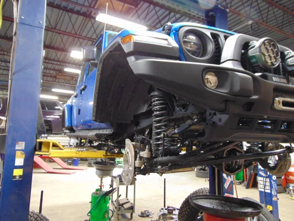

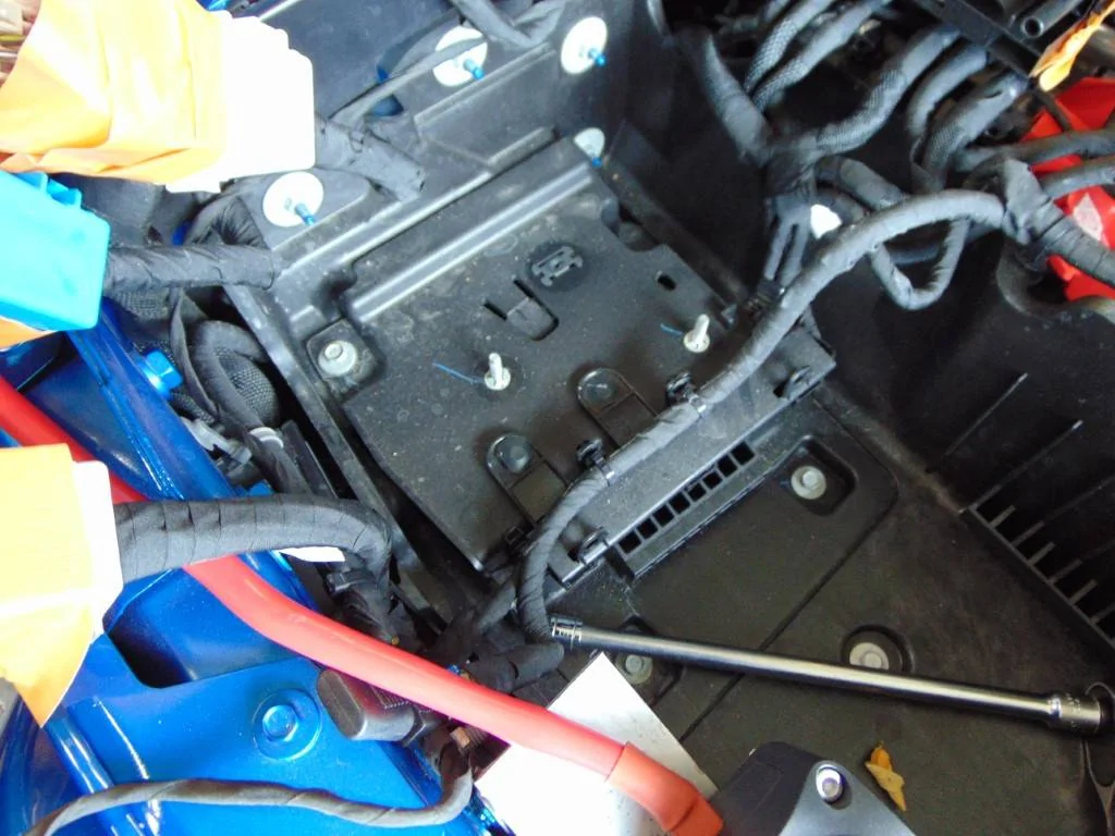

Next everything plus two more parts comes out. You are left with one wheel bearing and a brake pad still connected when you finally get to the motorcycle battery!

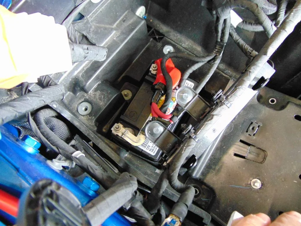

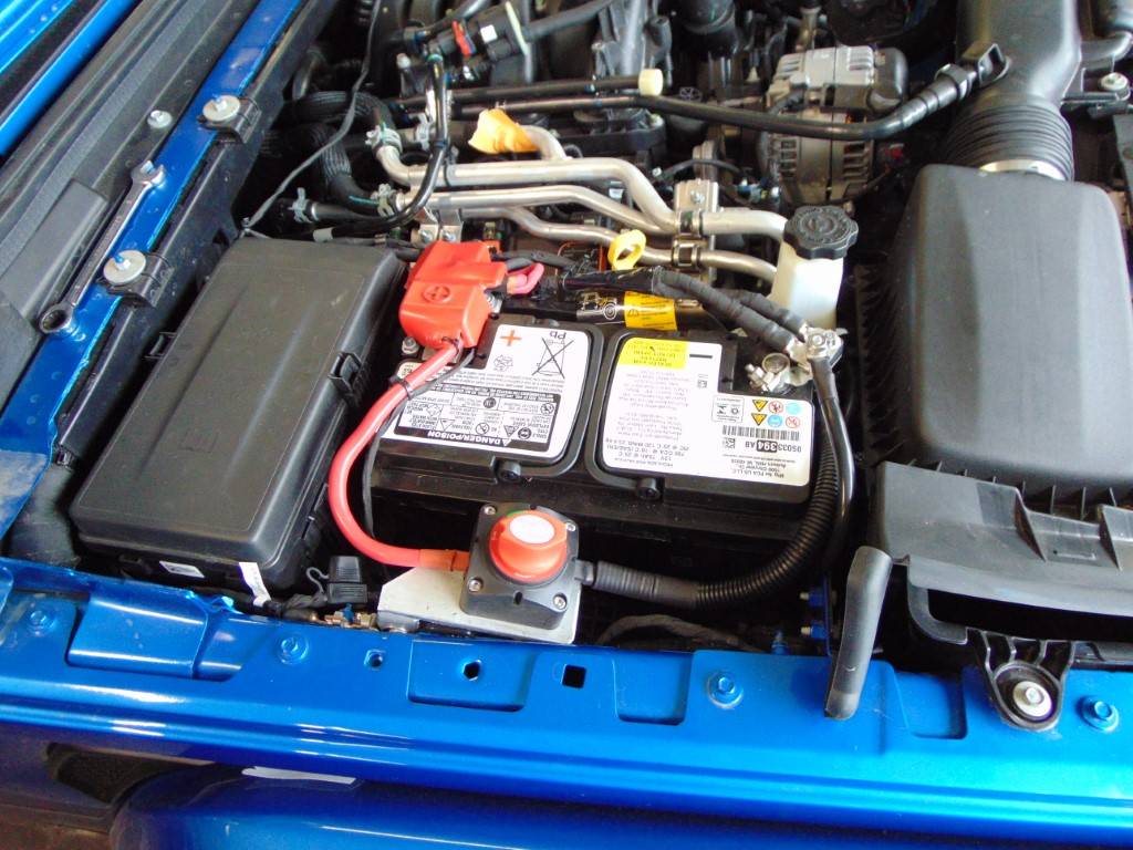

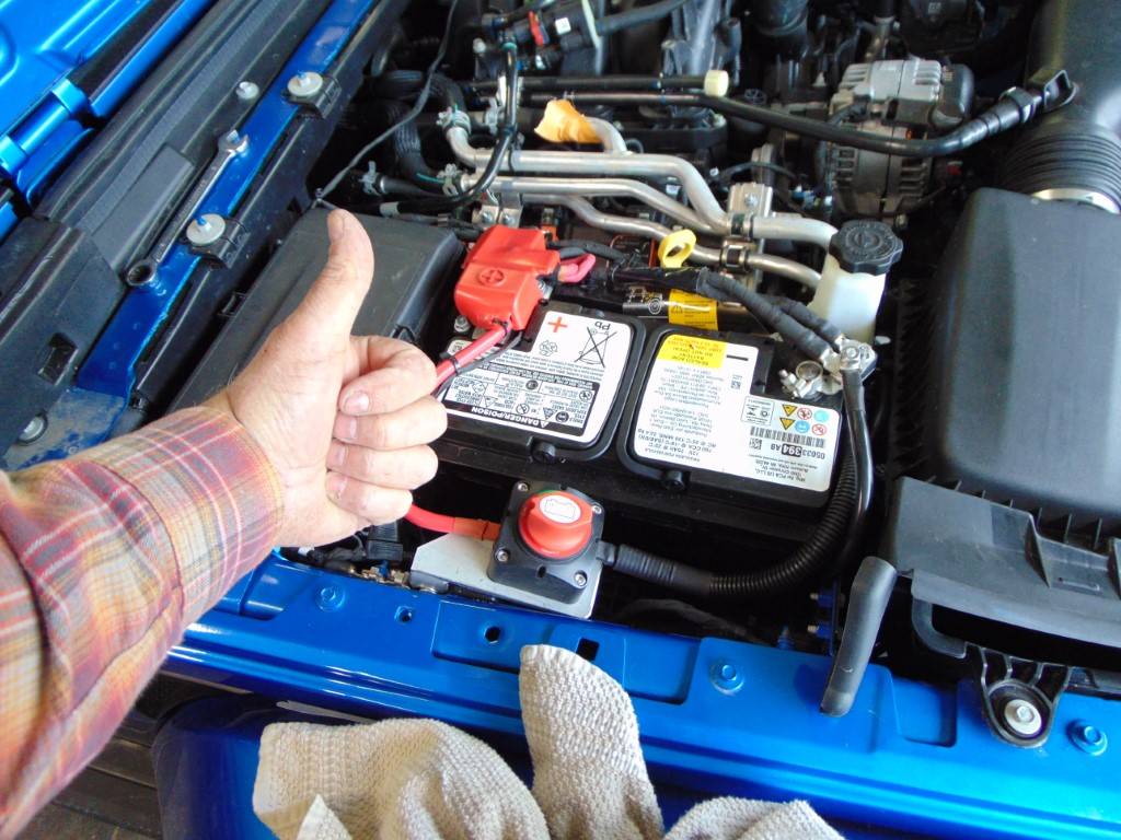

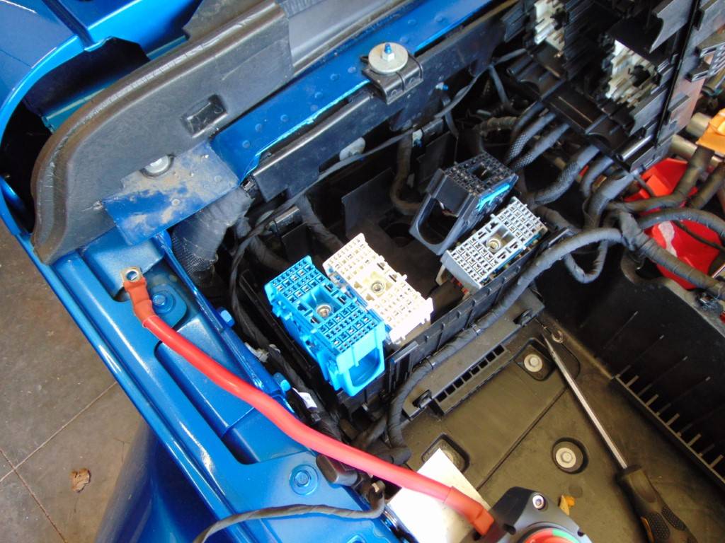

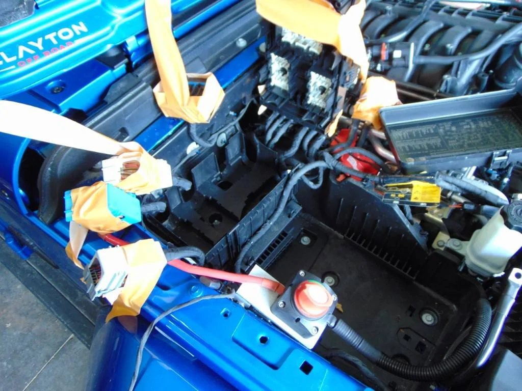

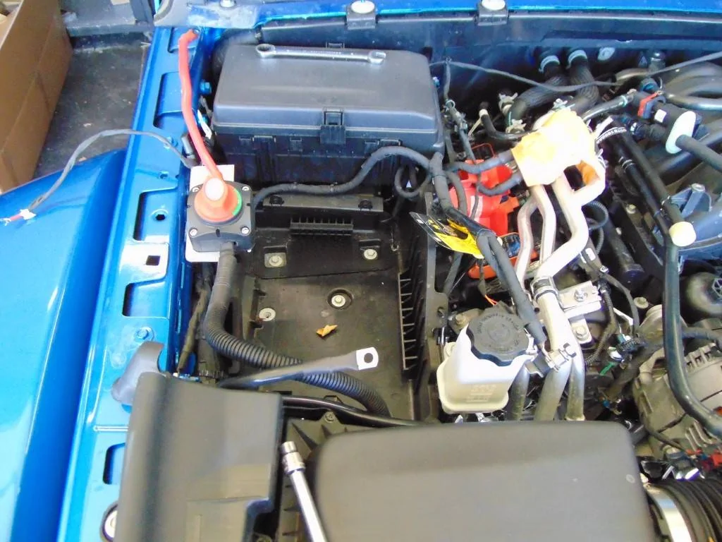

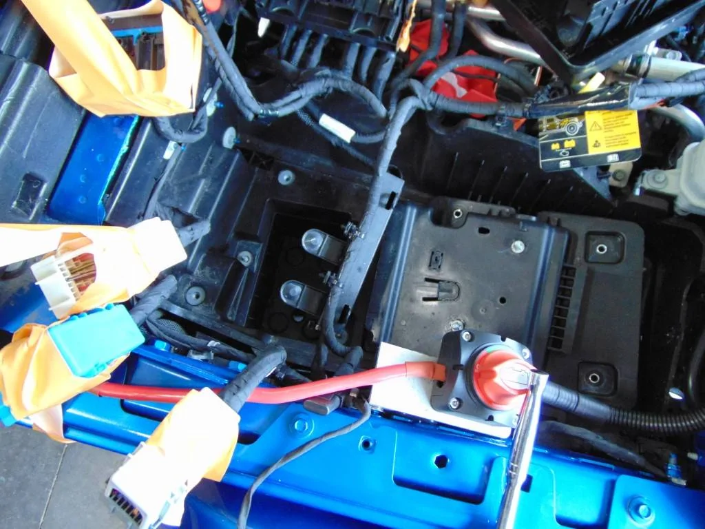

I taped up the ground cable, then cut apart all the tape on the positive cable to the wee-wittle battery. After flattening the mounting lug, I attached it directly to the factory battery stud, positive side, if you don't mind, and I became happy! :)

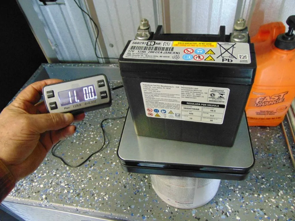

I shaved another 11 pounds off my slowing-thinning Gladiator...YIPPEE!

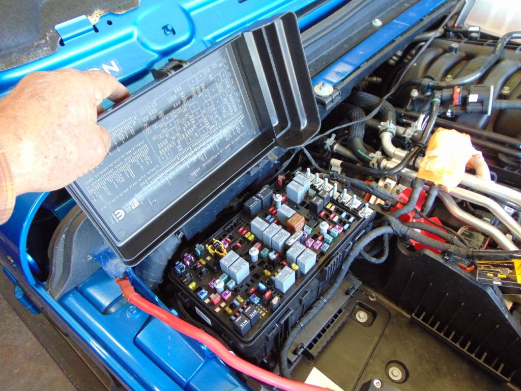

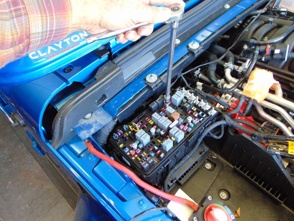

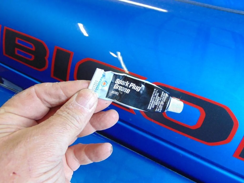

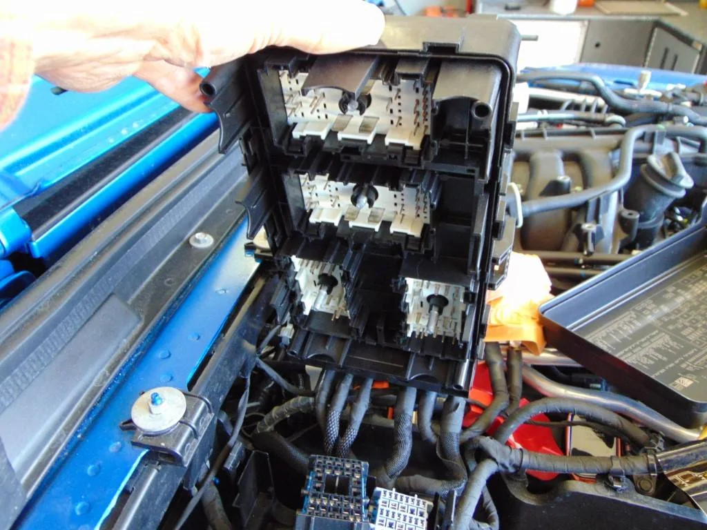

Oh, and here is a tip. I smeared spark plug grease over the end of those four plastic plugs that fit to the power distribution panel/fuse block thing. That made reassembly a snap. Really, it did. when I shoved them together they gave me a crisp "Snap." I figure they may reduce corrosion is I ever wade around in toxic pools of acid. Hey, I mean some folks are telling us the planet is becoming polluted, right? Well, I'm ready! ;-)

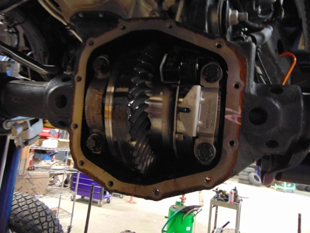

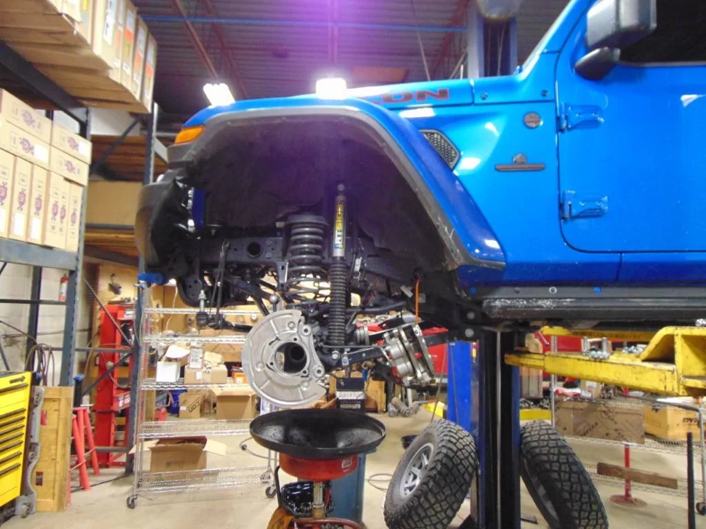

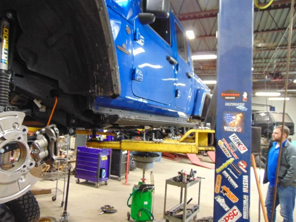

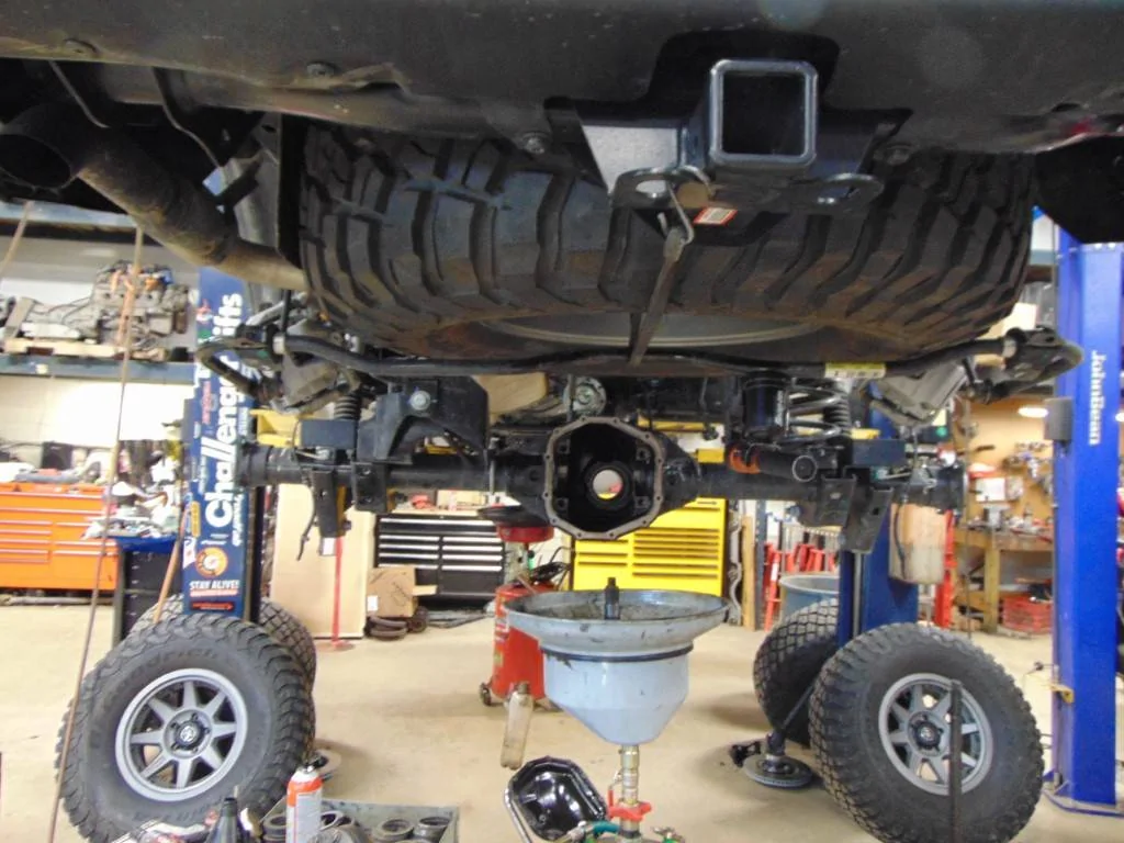

I just realized I did not cover the installation of the 5.13 gears that happened some time ago.
So, I'll jump into the "Way-back" machine and reenergize that.
(Way-back machine??? Ever heard of the cartoon "Rocky and Bullwinkle?")

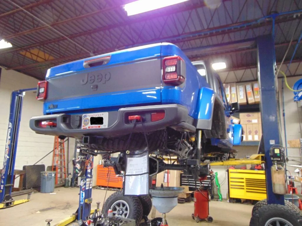

Anyway, High lift 4WD, which is a dedicated Jeep shop, and a good one tossed in a set of Yukon matching 5.13's, then calibrated the speedo with the AEV module that came with my JT.
Night and day difference! The AEV 4.56 setup with 37's is way wrong in my view. The truck would never tickle 8th gear unless going downhill with a tailwind. Now it remains in 8th gear unless I get into a steeper/longer climb on the highway. My mileage went up from mid 15's to mid-16's as a result.

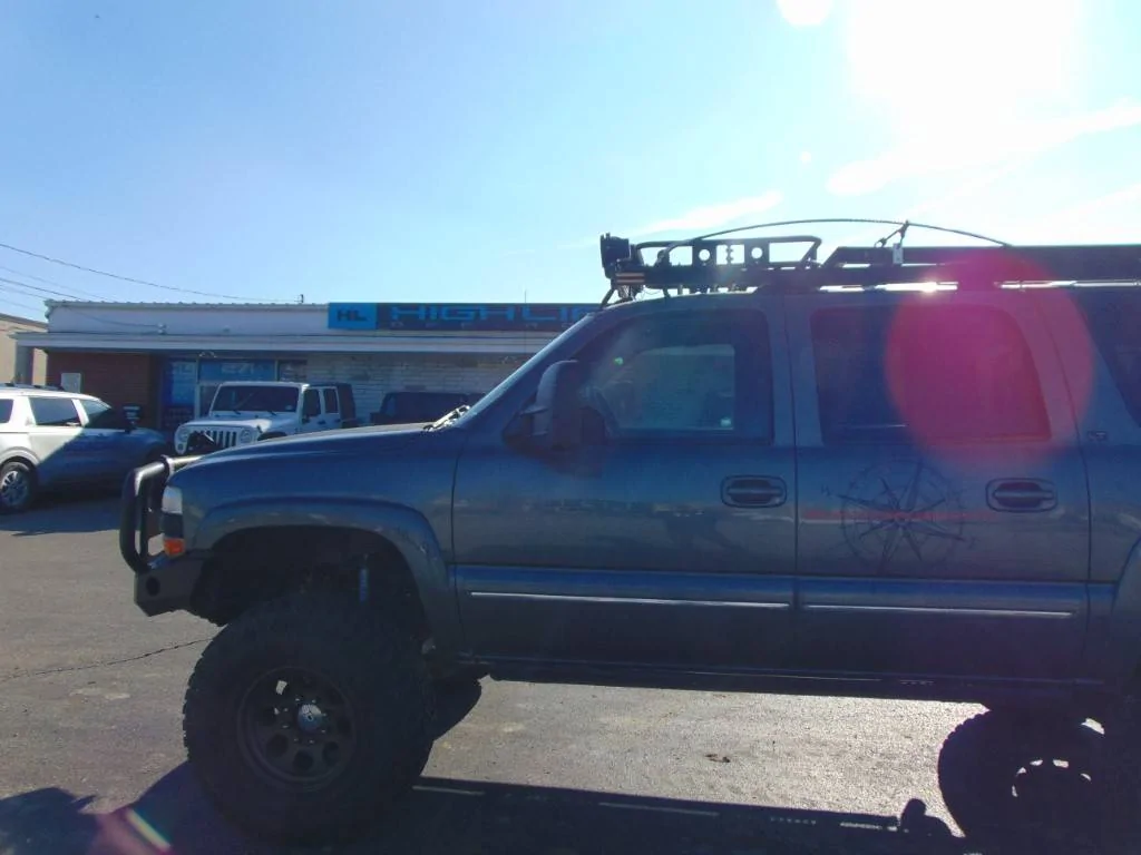

And, that big Suburban overlander, which does quite well in off-road, is very good for the JT.
It has a 600HP supercharged LS motor with 4.56 gears. When you push down on the skinny pedal, things start to happen. The speedo jumps upward and there is this really cool "Whine" sound and a throaty rumbly exhaust.
Why is this good, you ask?
Well, the JT has mo-betterer off road prowess, but is outclassed in the power department by my zero-turn mower. Owning a big overlander that has power will someday influence me to installing the much-needed V8 into the JT.
I feel that with either the Hemi 6.4 or a more likely Chevy 6.2 LT/10-speed, this JT would become one of the best, if not the best on-off roading platforms on the planet. Not my specific JT, but JT's in general with a powerful V8.
