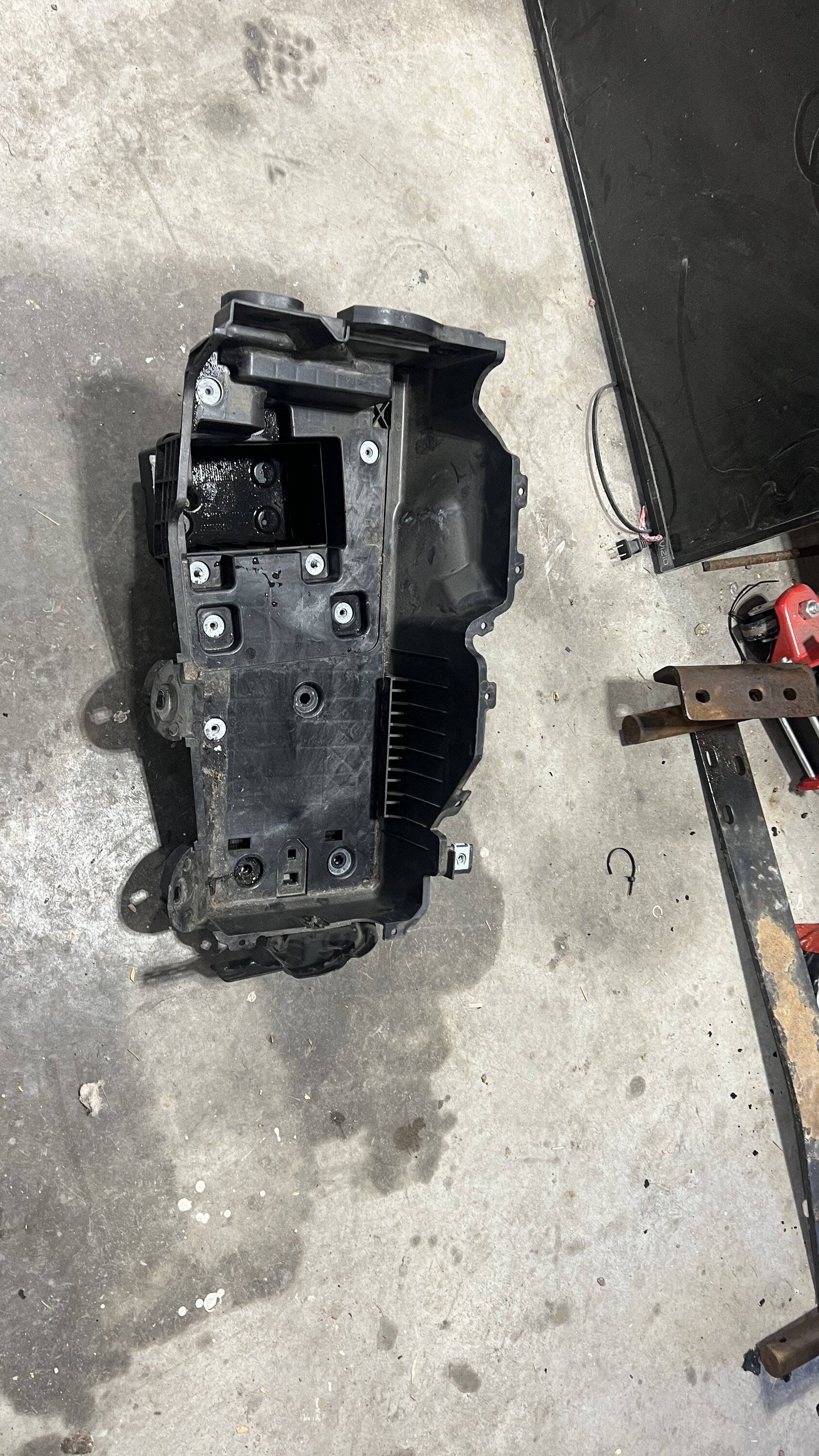

Here is a pic of my battery tray when I swapped to the Genesis - a smaller battery could fit as long as it is wide enough to be secured by the tiedown
You can see the built in hold down on the right, and on the left the nut where the tie down screws into. As long as a replacement is the same width I dont see why a smaller one couldn't fit.

I could fab something up, I'm sure. Question, the well in the tray...Is that where the secondary battery rests?

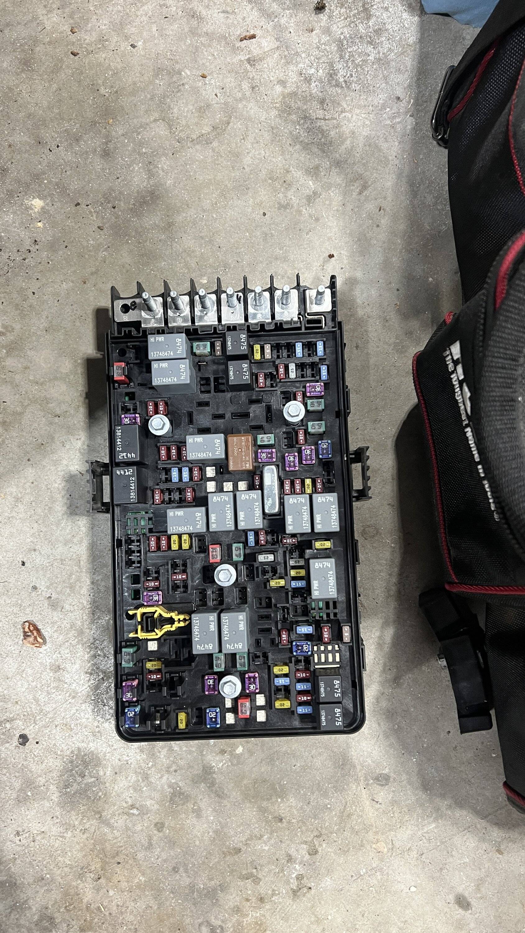

Yessir that's for the aux, pain in the butt. You can get to it via either the fender well area or you have to pull the PDC off
First you disconnect everything and take the PDC off

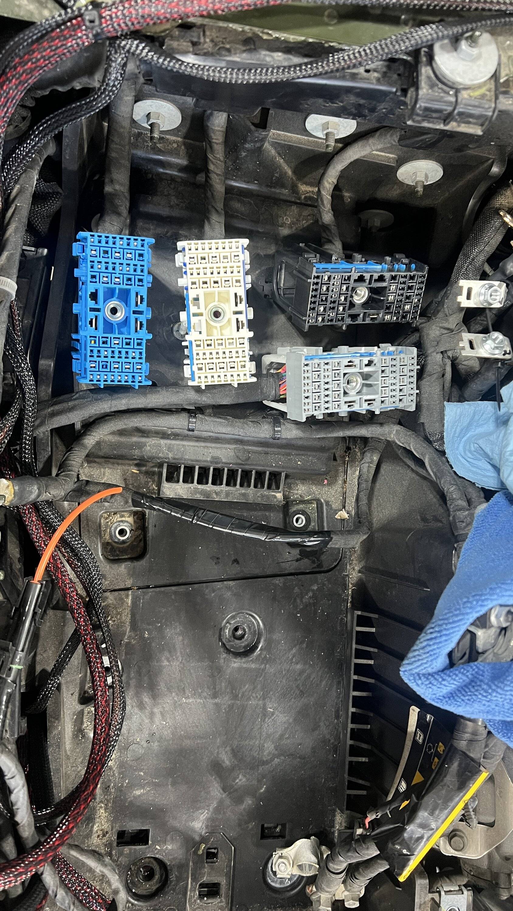

Then you have to move all of these out of the way. But Be careful you don't touch antything to each other, and when going back in a lot of people accidentally bend pins which causes a whole lot of issues. You can see the cover to that well here, theres 3 or 4 bolts that tie the cover down.

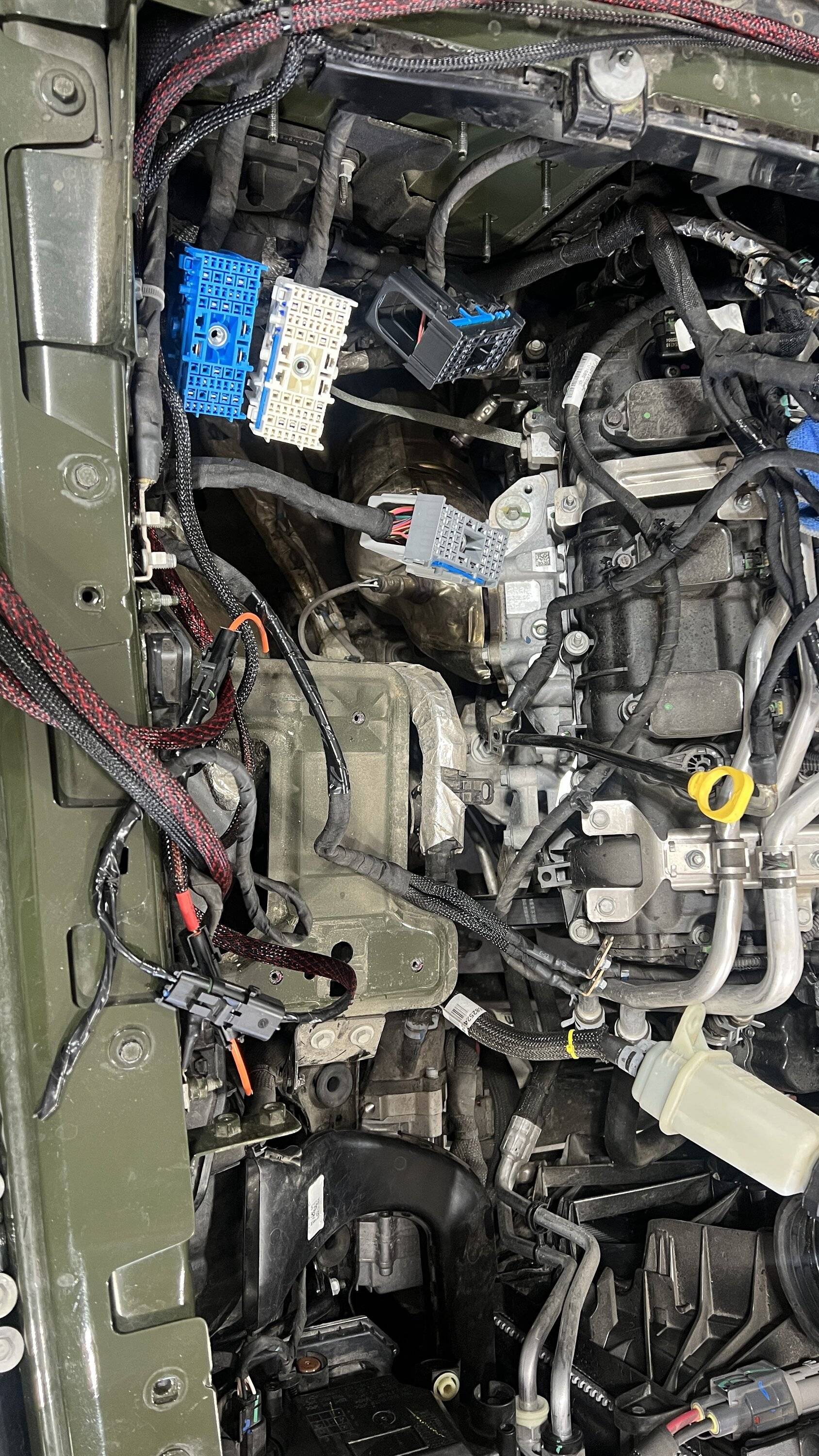

And then this is what it's like with the factory tray removed.
