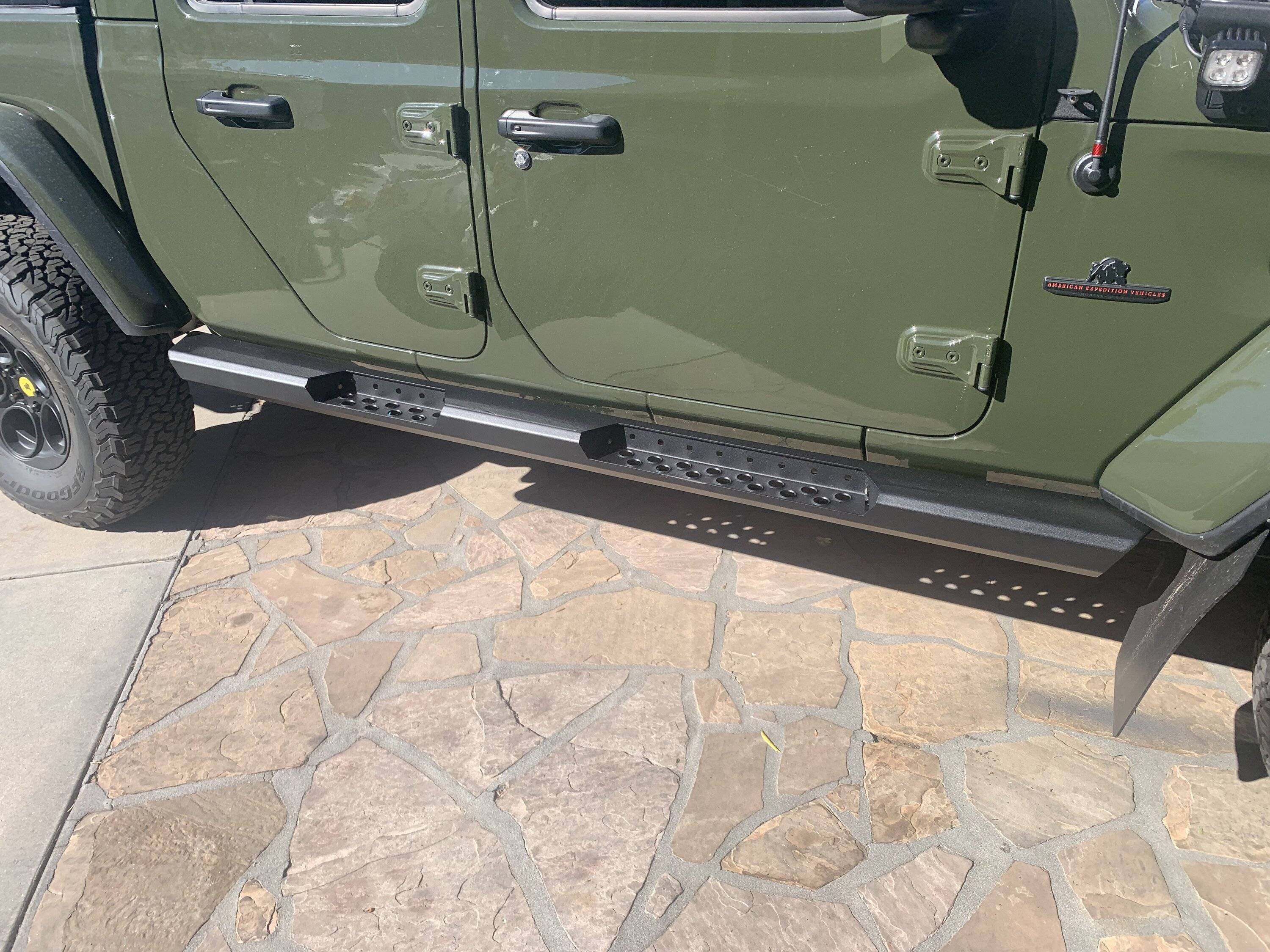

I am running the steel LOD Destroyers. Says 137lbs so a bit heavier than the aluminum sliders plus steel armor, but guessing a lot stronger. These JTs get hung up more with the long wheelbase. Its a good place to sacrifice a little weight.
Did you post up those lights for sale yet?
I think I'm staying with the aluminum. It should work for the way I drive. (Read: Always take the bypass and have fun watching the others scrape through!) Lights are up for sale, but I haven't posted those or the bumper anywhere on here for sale yet. If you're interested, just message me.
