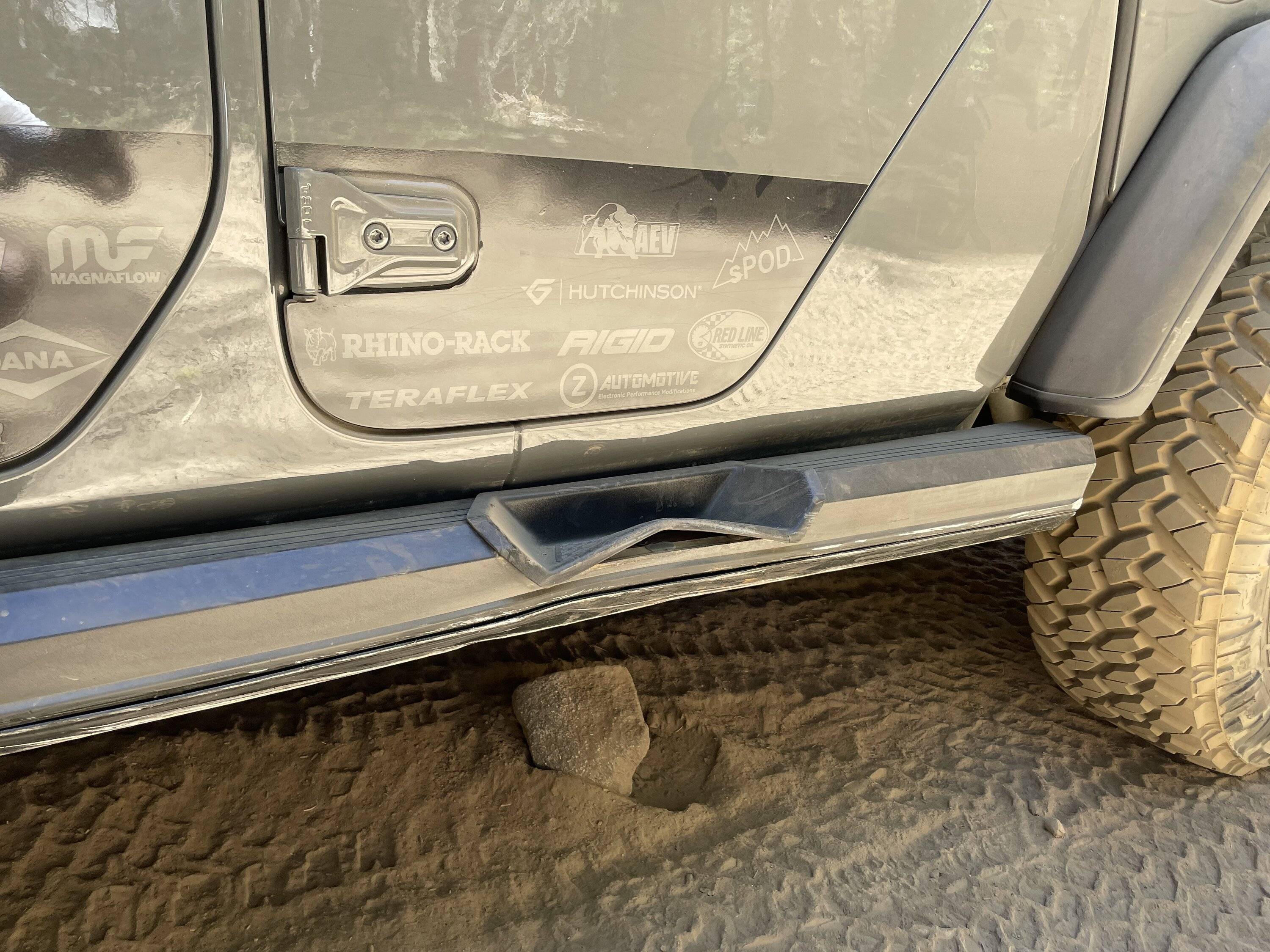

Found some HD aluminum rock sliders that I just may have to pick up
The aluminum LOD Armor Lite sliders would be another choice. They held up really well to the light-medium stuff I normally do but I'll be the first one to admit they are not going to survive being dropped on a rock with the full weight of the truck..... I totally destroyed my set on the Rubicon :)
It's an interesting thread..... pains me to watch all that nice AEV stuff get tossed in a bin but I get where you are going with weight.
THose are the exact sliders I am eyeing.
Were you running the steel cladding for the lower edges?
Any idea of the weight of those along with the steel if you ran that?
Comment: I have discovered a lot of the companies I call and inquire about the weight to be clueless about that. Not something they are normally asked about, I suppose
LOD claims 85lbs for the sliders, 24lbs for the steel cladding.
Yes, I was running the cladding. the Northridge video does a good job of showing them scrapping along rocks.
Mine were actually "ok" after the Rubicon.. lots of dents and scrapes but what did happen was I hit a rock hard enough that the aluminum deformed, popped the lightweight step insert out, and then mostly popped back. LOD does make replacement steps but I decided to replace the sliders with steel...
