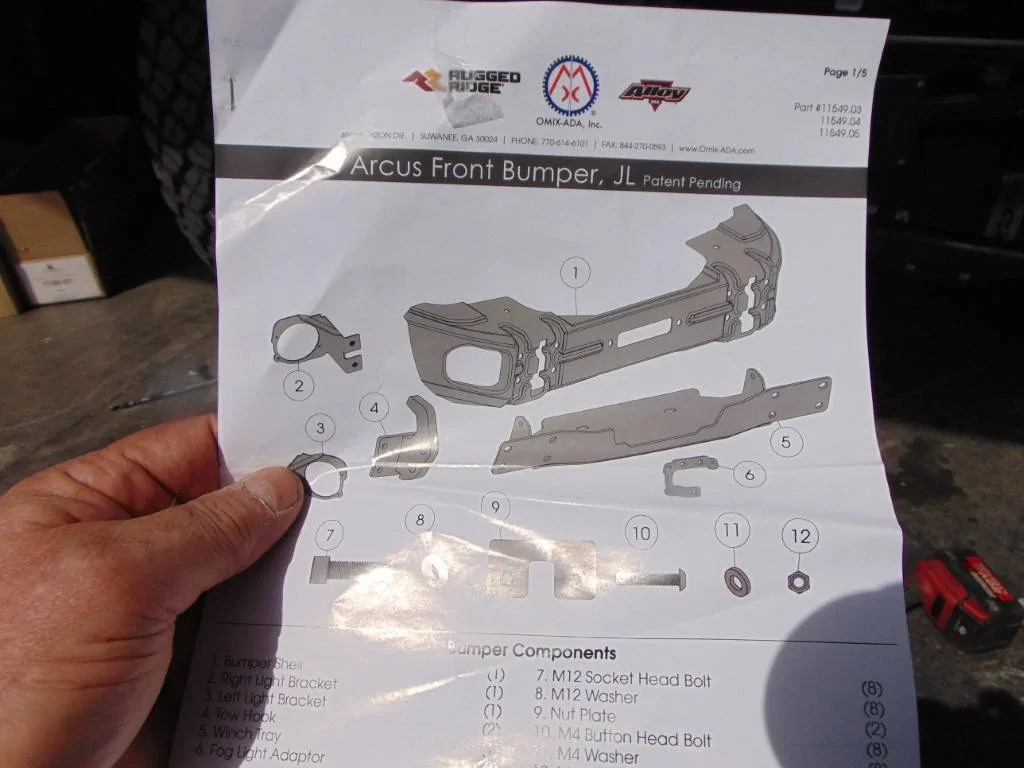

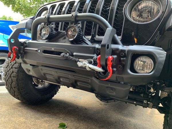

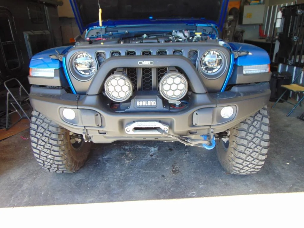

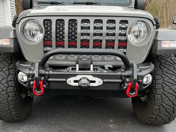

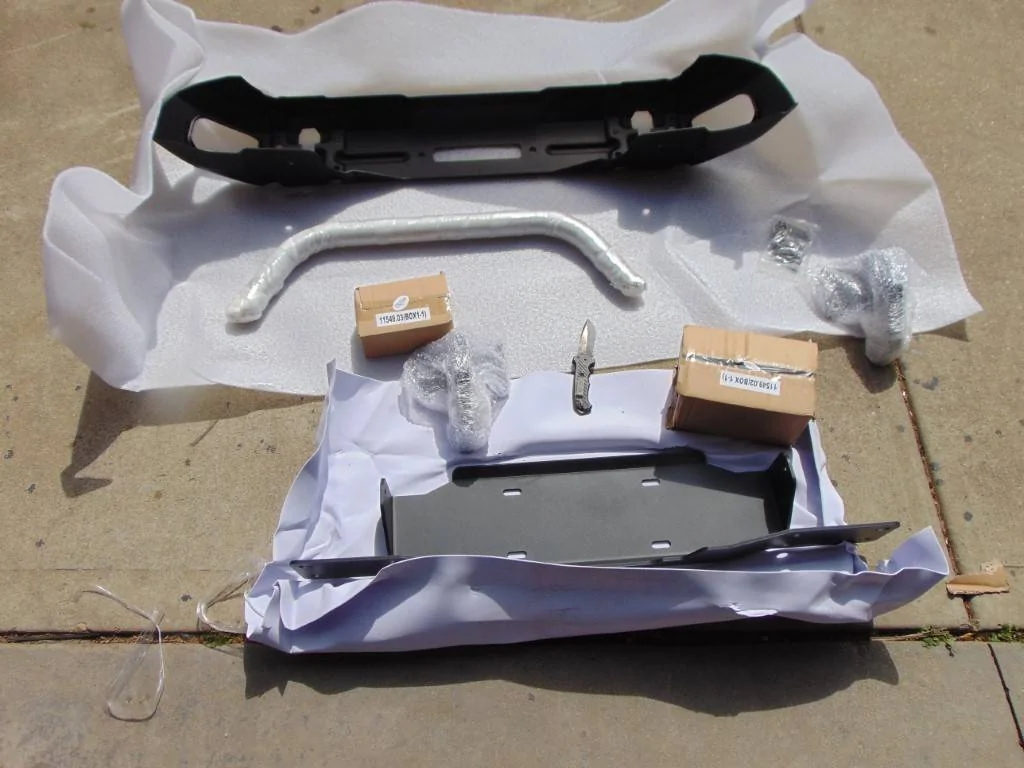

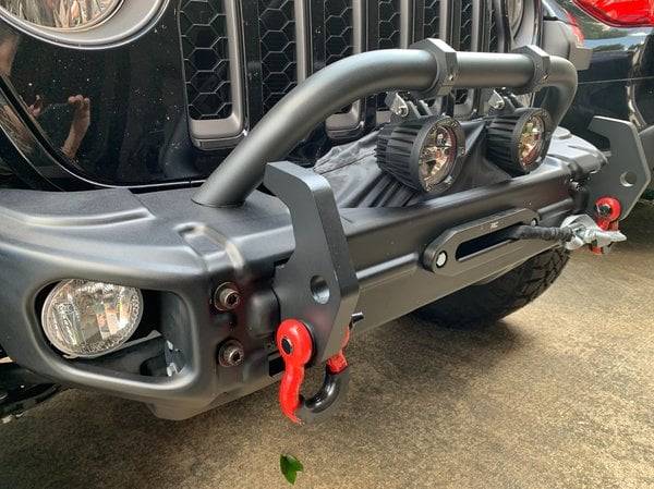

Stubby bumper ordered. Rugged Ridge Arcus is the choice. Will shave another 50 lbs off the front end...Yippee!

Does anyone know the tube OD on that winch/grill guard? I want to pick up some tube clamp/light mounts for it.

That's exactly what I was thinking too as well.

Light clamps were ordered. Bumper showing up in two days.
Edit: Scratch that, it came today...1-day flash to bang time on this!

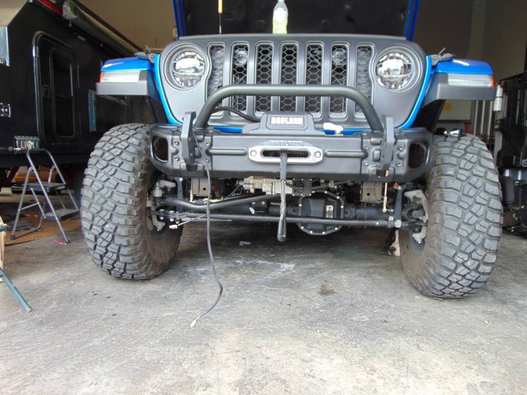

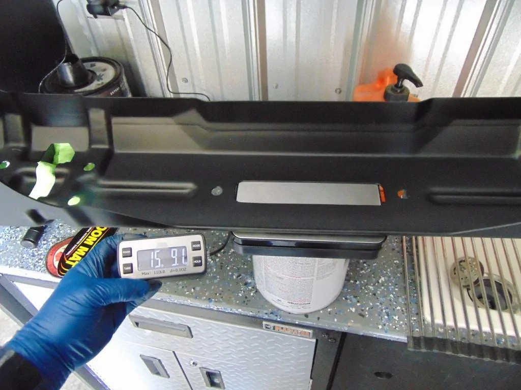

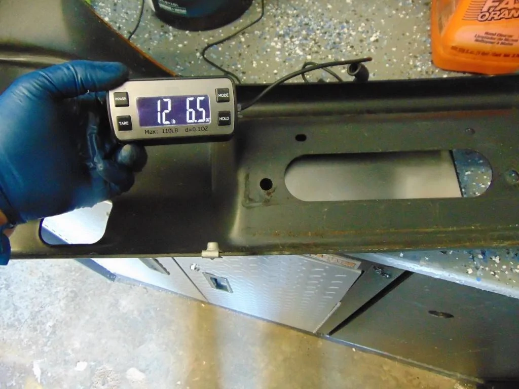

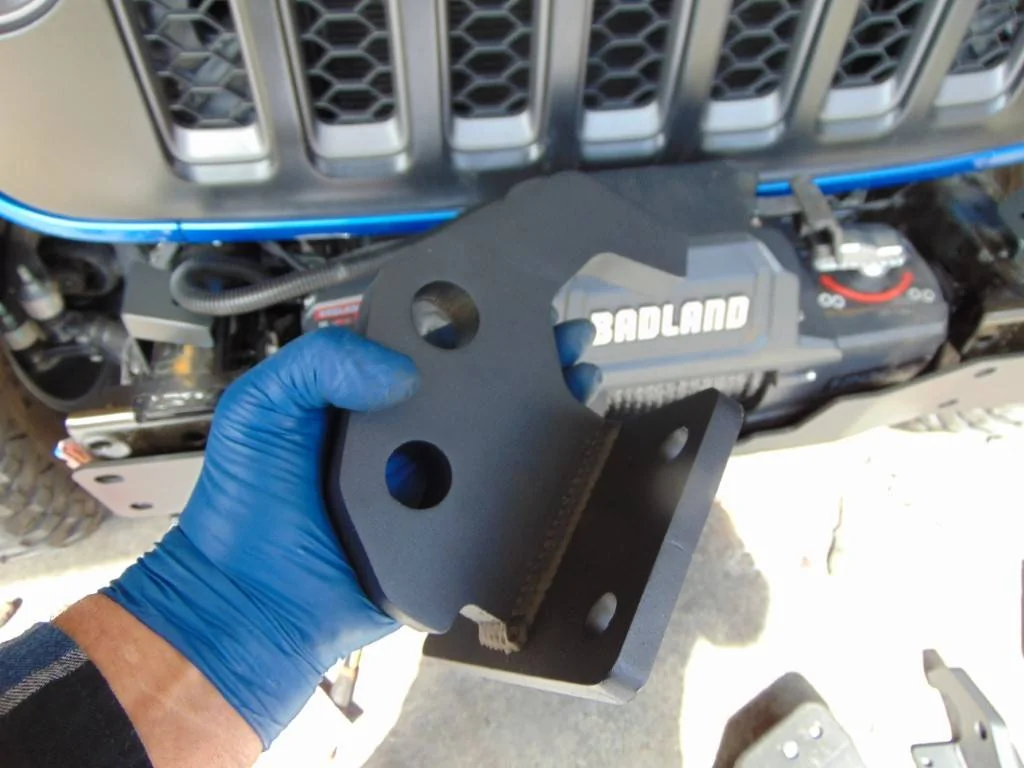

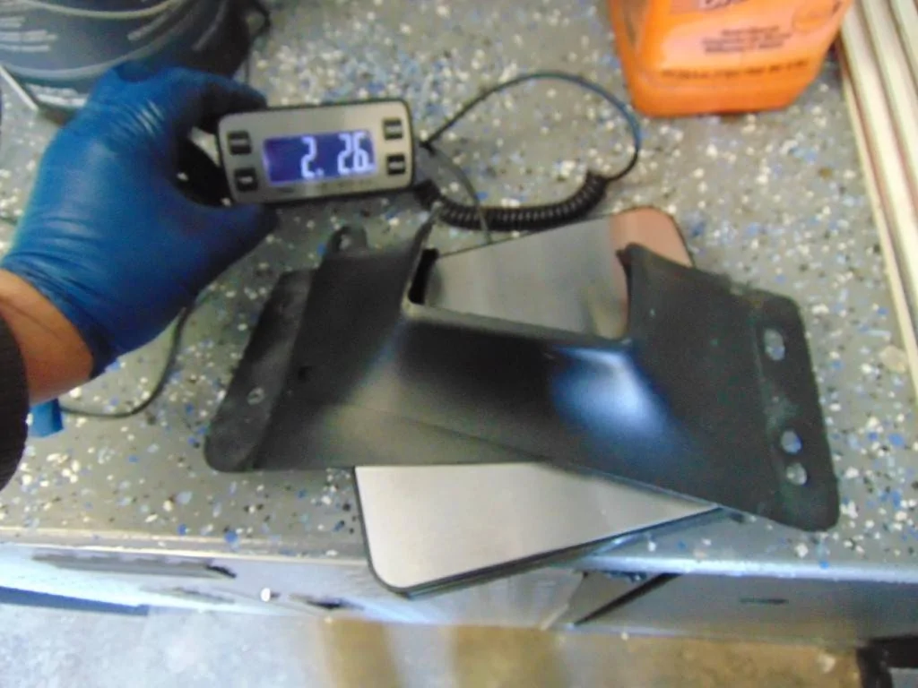

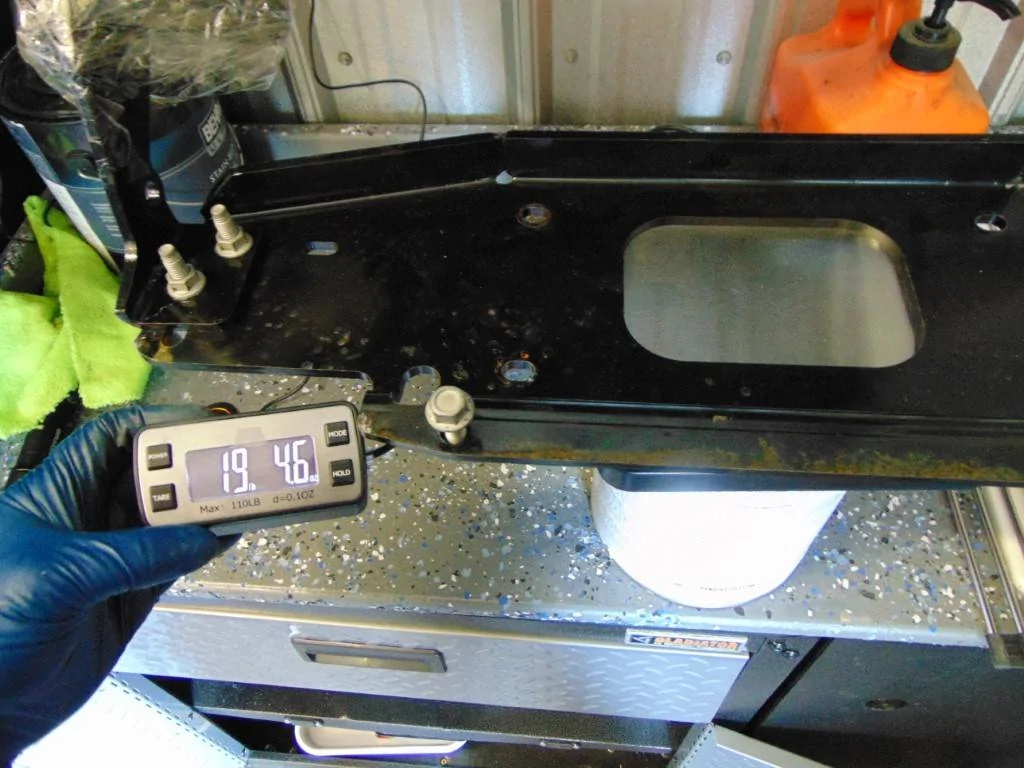

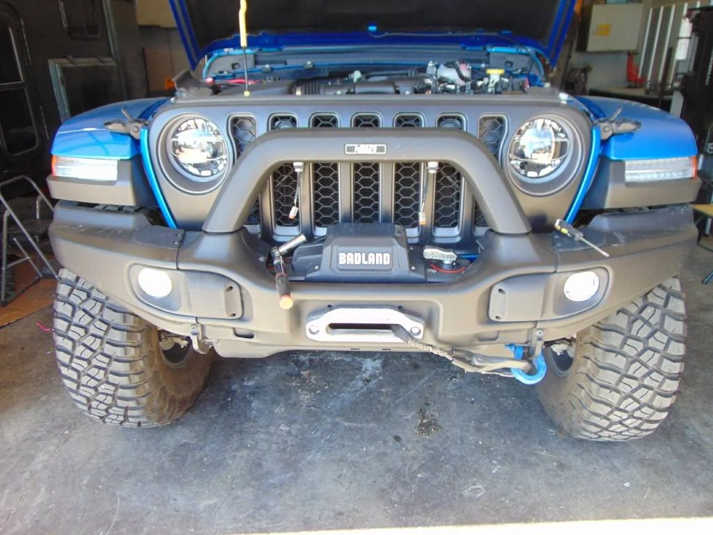

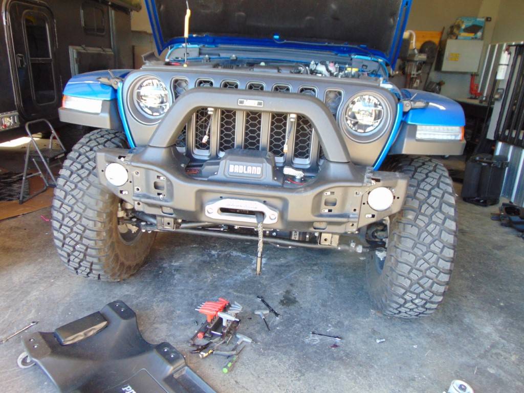

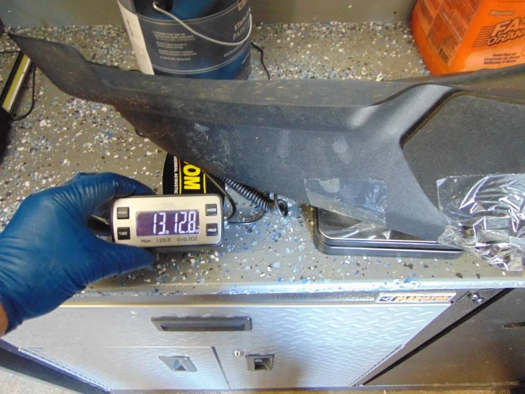

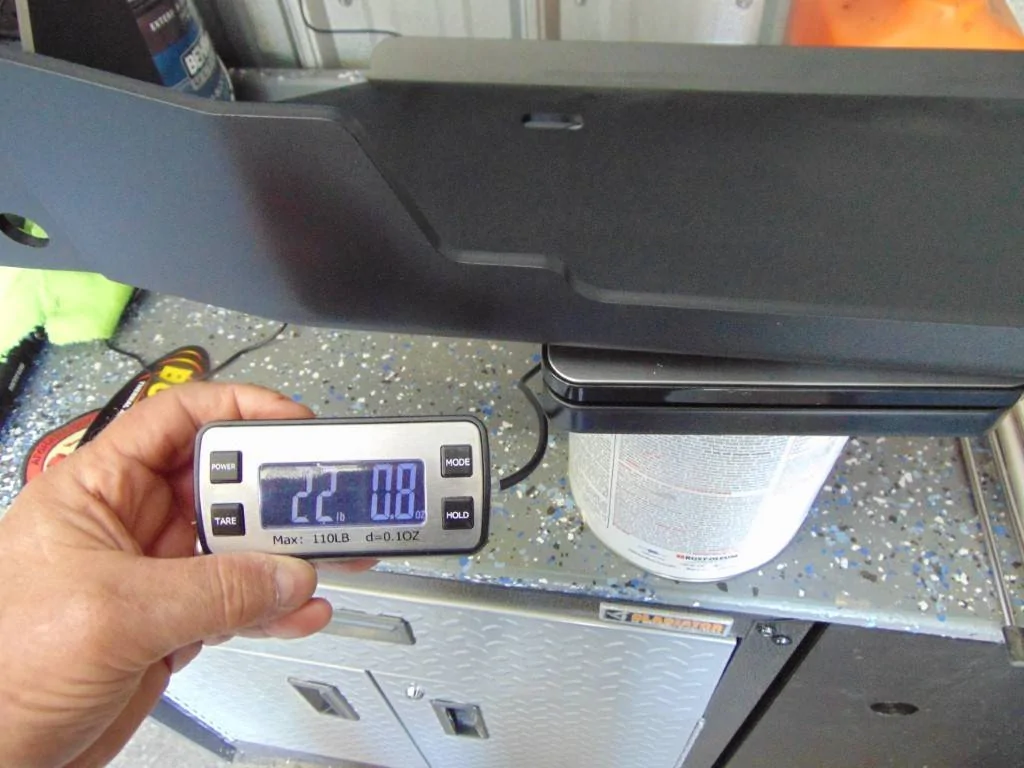

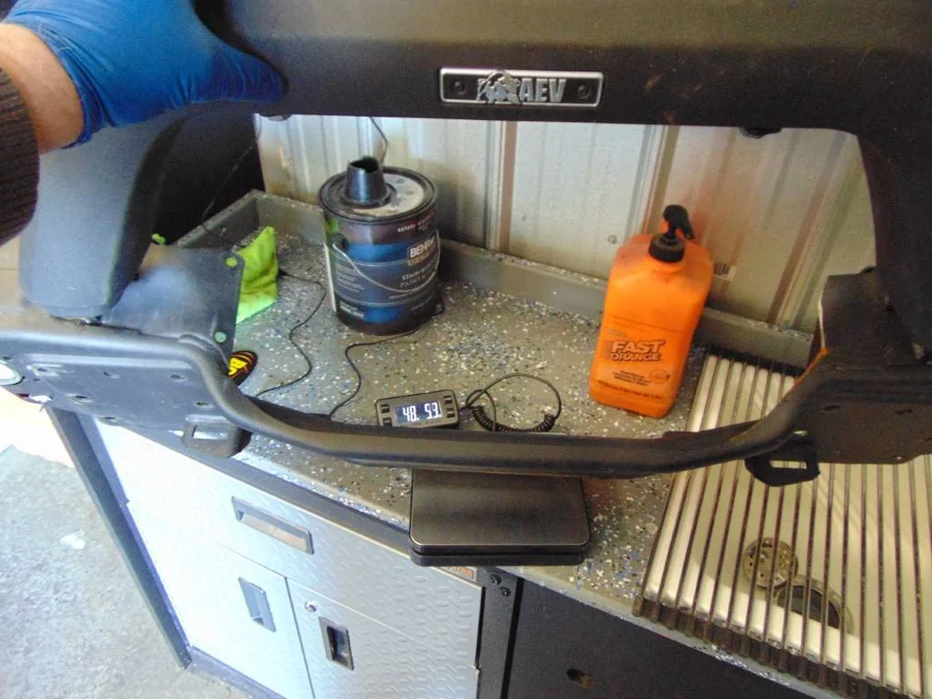

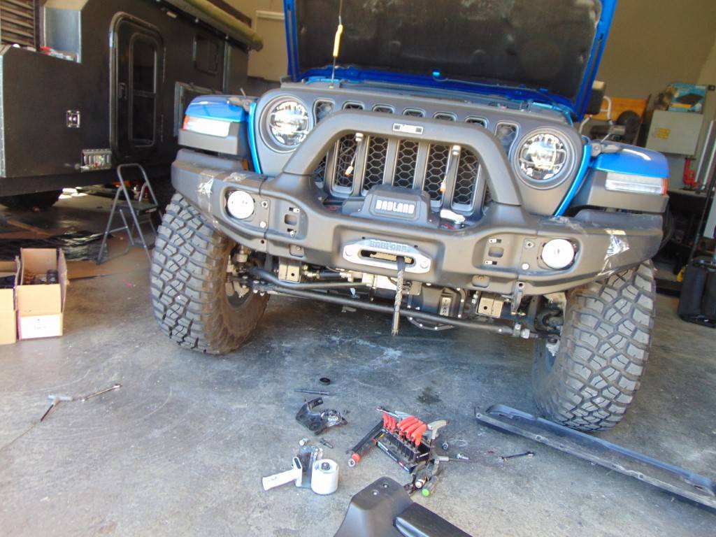

OK the AEV RX bumper removal happened today
THis thing is supposed to be light weight and strong. Well, I can believe it is strong, but lightweight IT IS NOT.

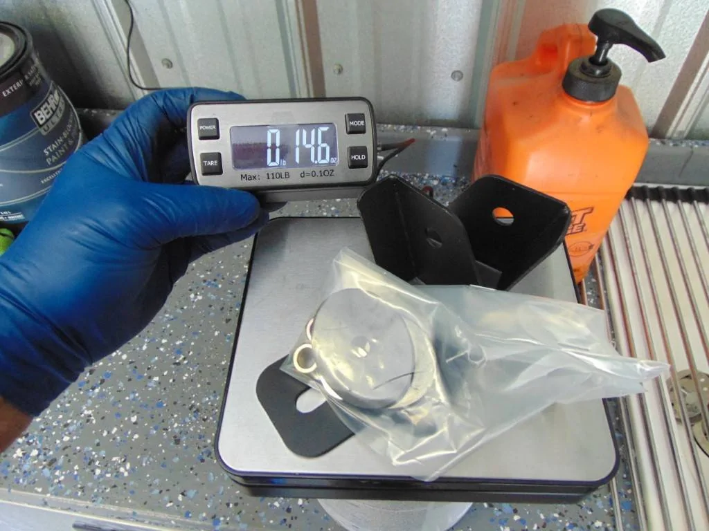

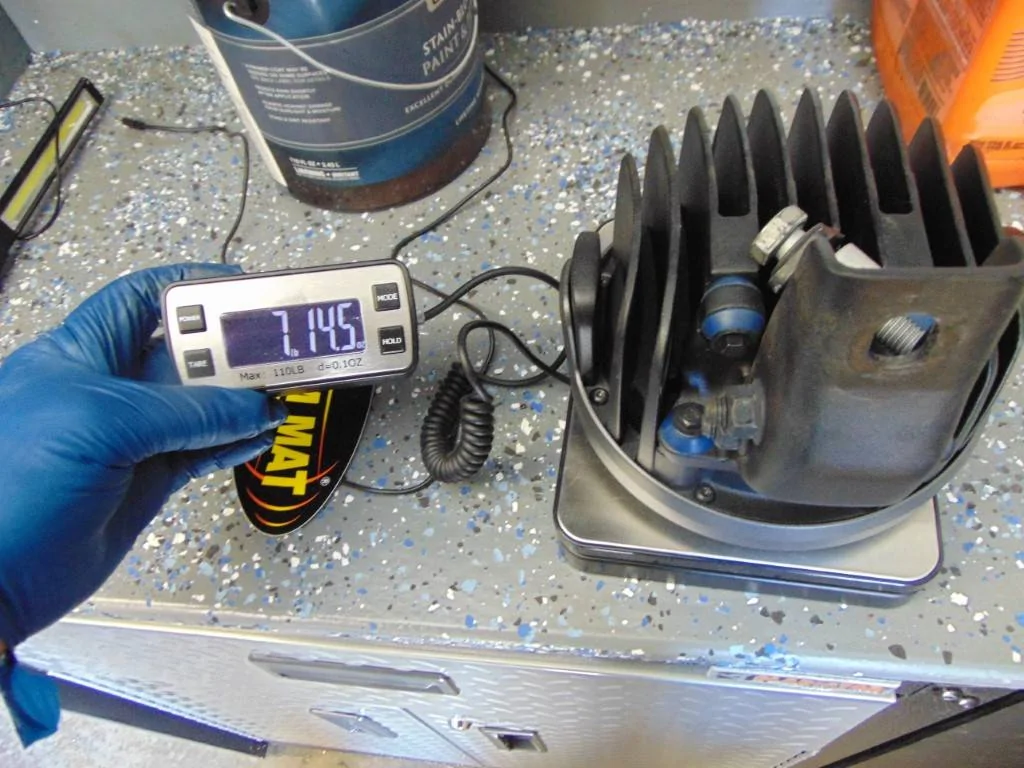

I weighed everything that came off one piece at a time
Jeep Gladiator 2022 AEV Gladiator Rubicon build DSC01485 (Medium)
Flyin6
Flyin6
Jan 2, 2023
1,321
1,792
Kintuckee
22AEV JT370, 24 Ram 3500, 22 Caddy XT6
Aviator, rotary and fixed wing, Writer
Flyin6
Flyin6
Jan 2, 2023
1,321
1,792
Kintuckee

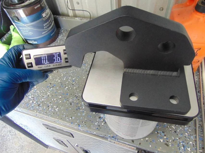

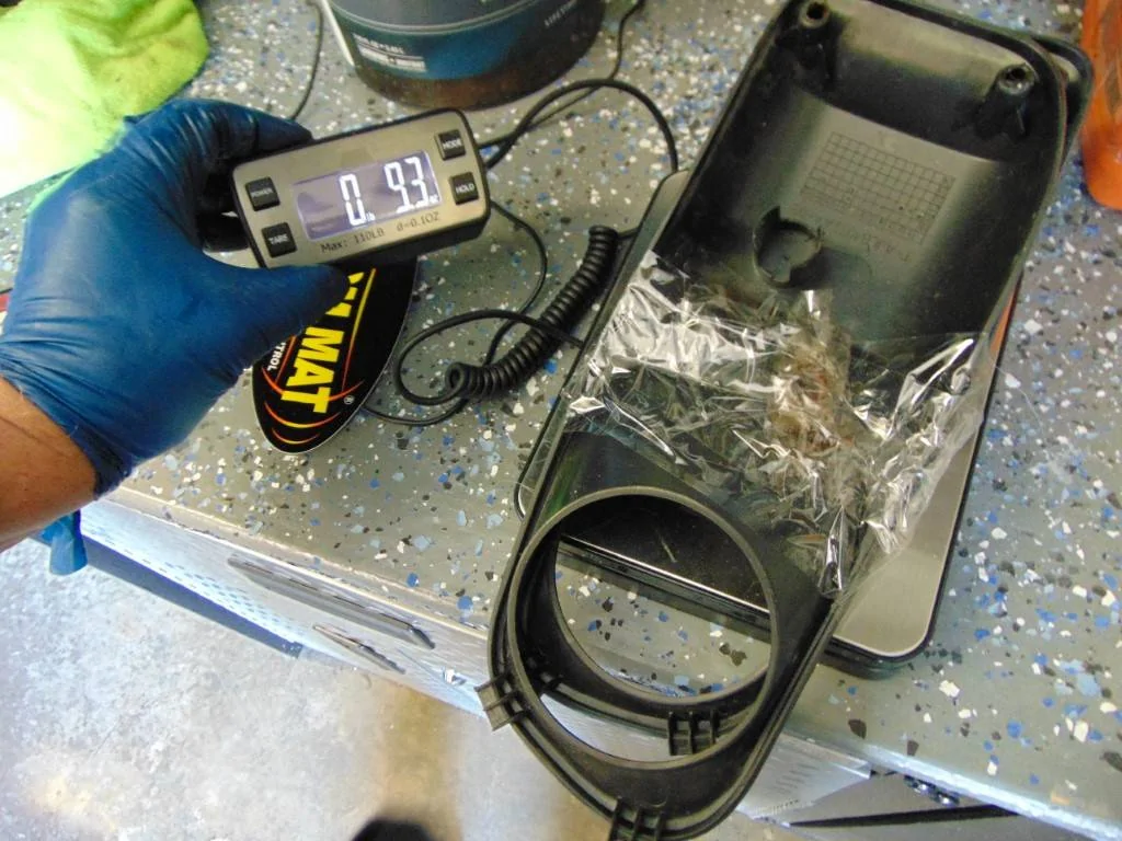

So, this thing is a beast
Bumper alone: 102.42
Bumper + winch plate: 121.84
Bumper, winch plate, AEV lights: 136.12

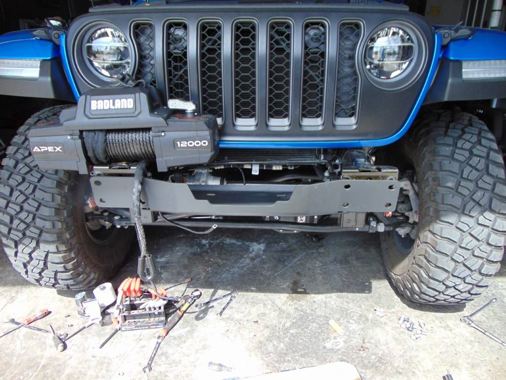

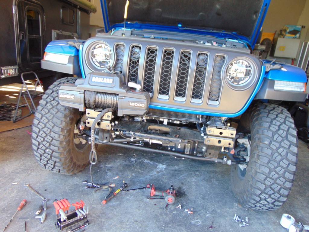

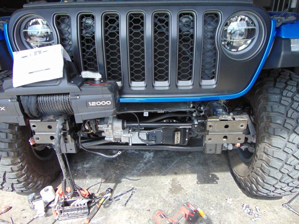

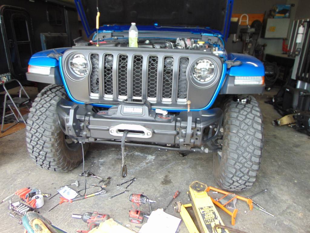

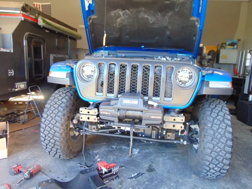

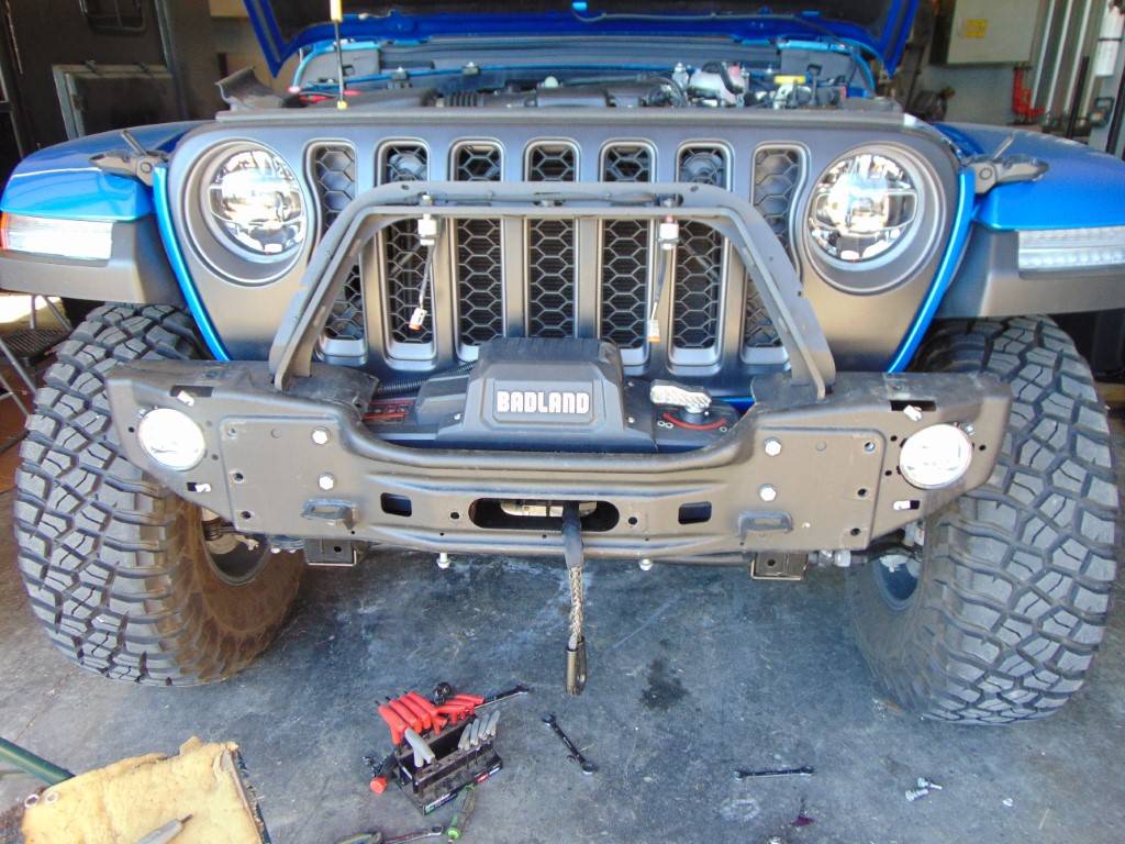

The detailed writeup is over on the other site, but here are the essentials.
Teardown start to finish:
Jeep Gladiator 2022 AEV Gladiator Rubicon build DSC01487 (Medium)
Jeep Gladiator 2022 AEV Gladiator Rubicon build DSC01498 (Medium)
Flyin6
Flyin6
Jan 2, 2023
1,321
1,792
Kintuckee

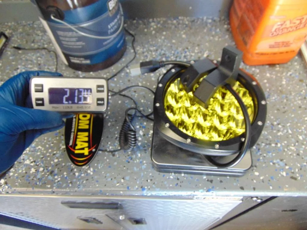

So why remove such an outstanding AEV bumper, and why modify it at all?
I did purchase an AEV jeep, and most people would have left it alone. But I have found it wanting in so many areas that I am essentially undoing what they did in creating it. Had I been an avid Jeeper to start with, and I was not, I would have NEVER purchased this thing. But my first weekend out, I was hooked and really liked this JT platform, everything except for the motor.
AEV is trying to build OEM stuff that is engineered to some, well, OEM standard. Another word for OEM is: Heavy. Still another phrase that comes to mind would be: Over-engineered.
Just look at the massive bolts that secure the light modules...They are the same size as the largest bumper bolts. I have to ask, Why?
So the bumper is just too heavy. Secondly, it shrouds the front tires. Next, it blocks off like half of the radiator, especially with the placement of those bowling-ball-sized lights. And look at the AEV light, and my replacement.
I believe I can achieve about a 50% weight savings over the AEV thing and at the same time, build some more clearance and more performance into the Jeep.
Performance you ask? Yes, every ounce you remove is an ounce the engine does not have to work to move. in drag racing, a hundred pounds equaled a tenth or more in the quarter mile. I should be dropping 50 pounds with this bumper swap.
I lost a bunch of weight by replacing the exhaust.
I lost a bunch by deleting the rear seats.
I'll save 10 pounds by changing out the lights and I should lose another 50+ pounds with this bumper swap.

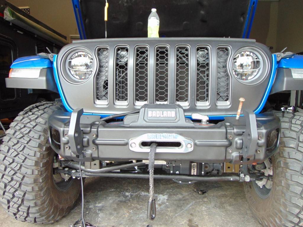

This thing was a lot lighter and way less complicated than the AEV bumper it replaced.

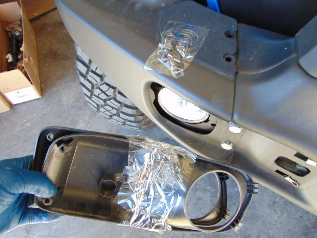

The install was a fair amount of work. The final steps of bolting all those sandwiched parts together was pretty challenging, hard actually.
