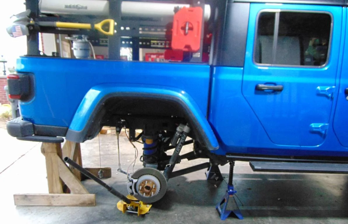

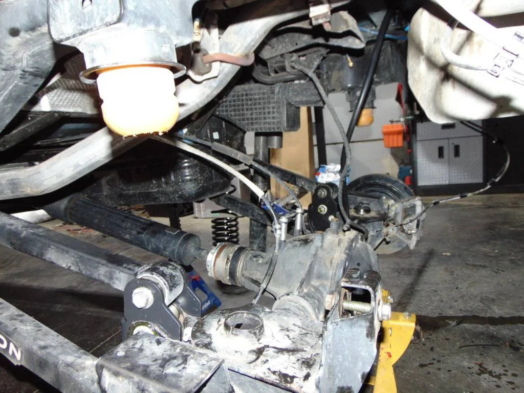

I started installing the new suspension today
Jeep Gladiator 2022 AEV Gladiator Rubicon build DSC02772 (Medium)
Jeep Gladiator 2022 AEV Gladiator Rubicon build DSC02774 (Medium)

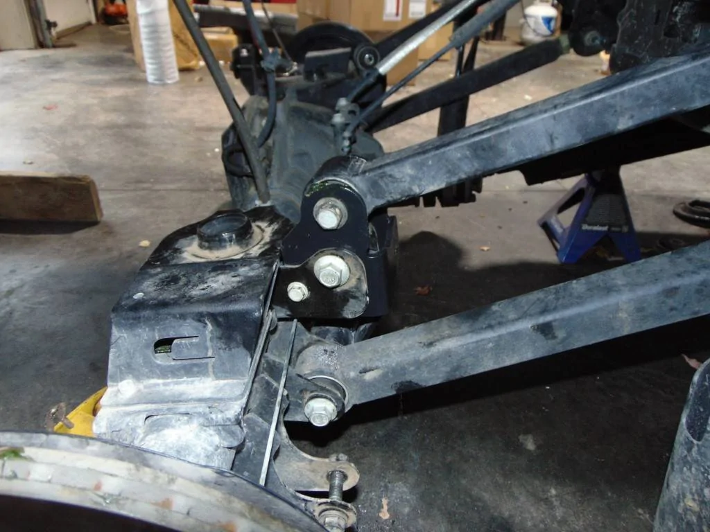

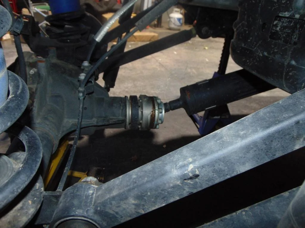

The Clayton suspension has served me well wheeling in Colorado, New Mexico, North Carolina, Kentucky, and other places. I did find some limitations and those are what I will be correcting with this Terraflex upgrade.
I want to do a Frankenstein conversion utilizing the excellent (paid for ;-) Clayton control arms, but the suspension is screaming for some drop brackets, and here is why:
Jeep Gladiator 2022 AEV Gladiator Rubicon build DSC02777 (Medium)
Jeep Gladiator 2022 AEV Gladiator Rubicon build DSC02778 (Medium)

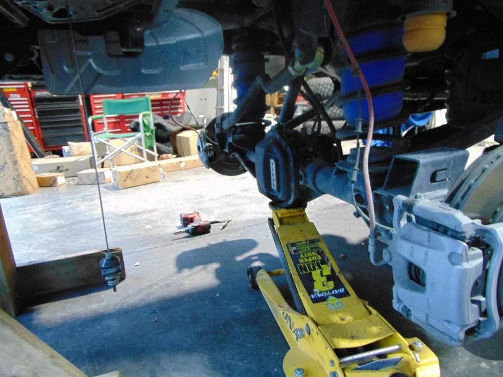

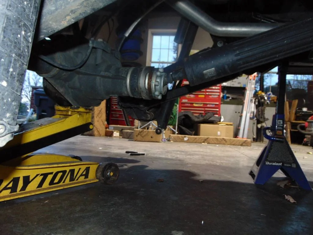

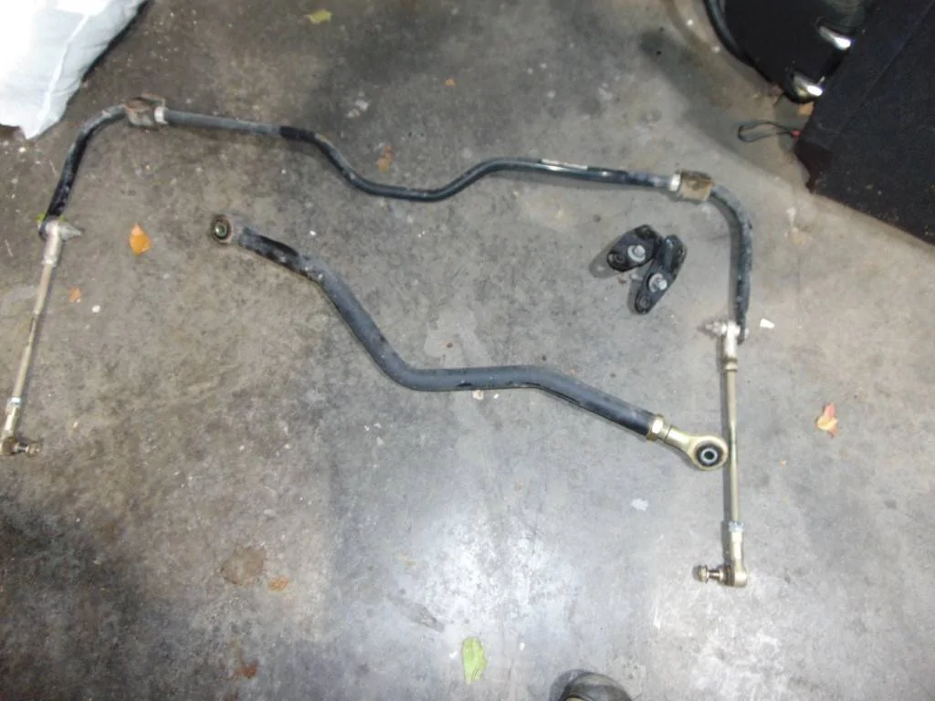

Yep, that full droop shot is a drive-shaft killer. When I laid plans to actually take my Rubicon to the Rubicon trail. sort of a homecoming, as it were. I knew that nonsense would not cut it, so I am sorting the thing out once again.
Anyway, I ripped the back end out, including the stock sway bar, which I will not be reusing.

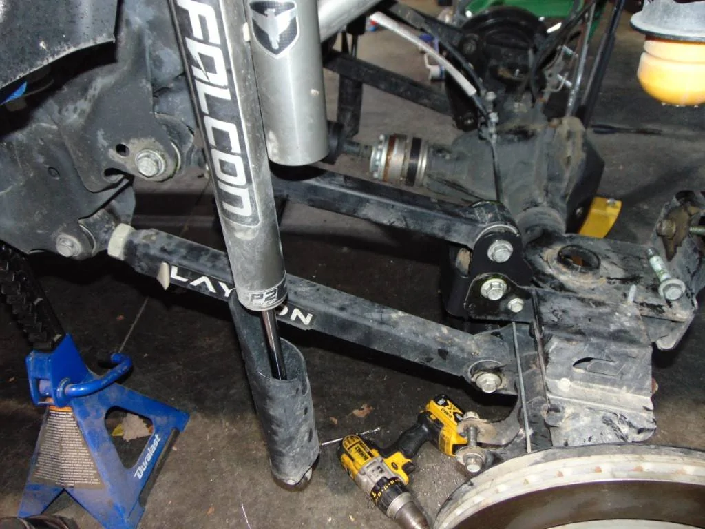

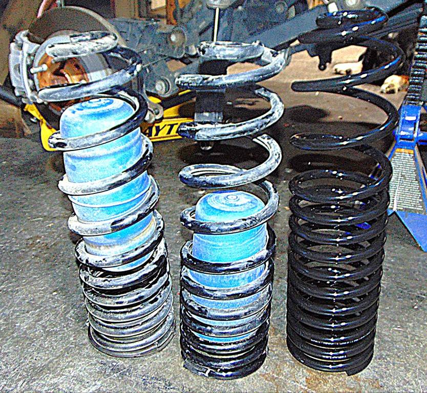

The Terraflex springs are 4.5" standing up beside the higher capacity Clayton overland springs. Also, note that the TF springs are triple rate whereas the Clayton are dual rate. Now, those Clayton springs have seen most of the San Juan forest passes and have done just fine, but talking to TF, the Falcon 3.3s are not a good match for the stiffer Clayton springs. I ran my shocks all the way dead soft, and that is just not right. I should have had them somewhere in the middle like they were designed to run with the spongier TF springs. Now, at least, all that will get sorted. If not, then I am off to get a set of 3.0-inch shocks and solve that puzzle forever.

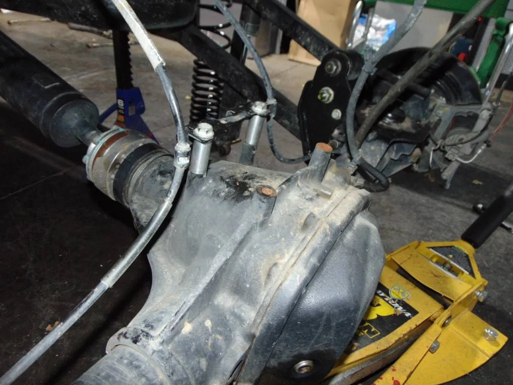

Another day and a few more well-spent hours swapping out parts. Today, I installed the new rear axle brackets and added extended brake lines, vent hose, anti-lock wiring harnesses, and a couple of other things.
