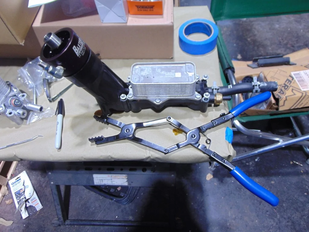

With the correct tool in hand and a bit of wrestling, the old oil cooler finally came off.
Jeep Gladiator 2022 AEV Gladiator Rubicon build DSC02929 (Medium)
Flyin6
Flyin6
Jan 2, 2023
1,333
1,820
Kintuckee
22AEV JT370, 24 Ram 3500, 22 Caddy XT6
Aviator, rotary and fixed wing, Writer

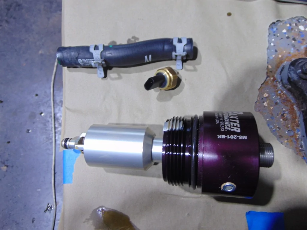

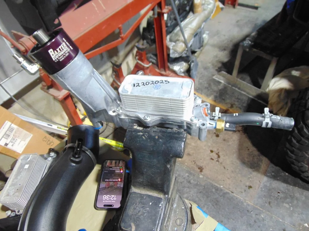

I swapped the parts, including the Baxter oil filter adapter, over onto the aluminum casting.
Jeep Gladiator 2022 AEV Gladiator Rubicon build DSC02930 (Medium)
Jeep Gladiator 2022 AEV Gladiator Rubicon build DSC02931 (Medium)

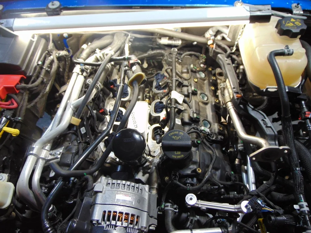

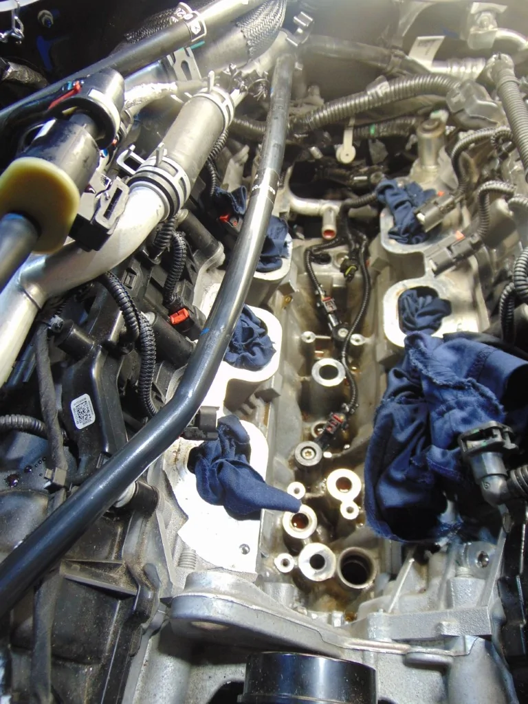

After cleaning the dry valley, I reinstalled the oil filter assembly
Jeep Gladiator 2022 AEV Gladiator Rubicon build DSC02932 (Medium)
Jeep Gladiator 2022 AEV Gladiator Rubicon build DSC02933 (Medium)

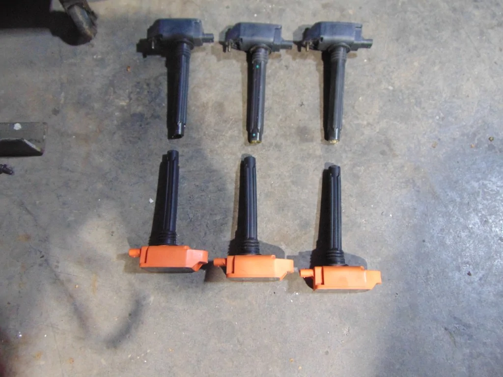

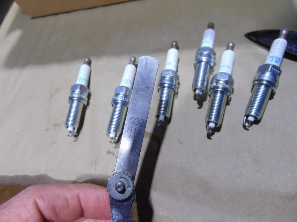

Next, I pulled the coils and spark plugs
I gapped the new NGK Iridium plugs to .032" IAW Ripp's recommendations.
Jeep Gladiator 2022 AEV Gladiator Rubicon build DSC02934 (Medium)
Jeep Gladiator 2022 AEV Gladiator Rubicon build DSC02935 (Medium)
Jeep Gladiator 2022 AEV Gladiator Rubicon build DSC02936 (Medium)

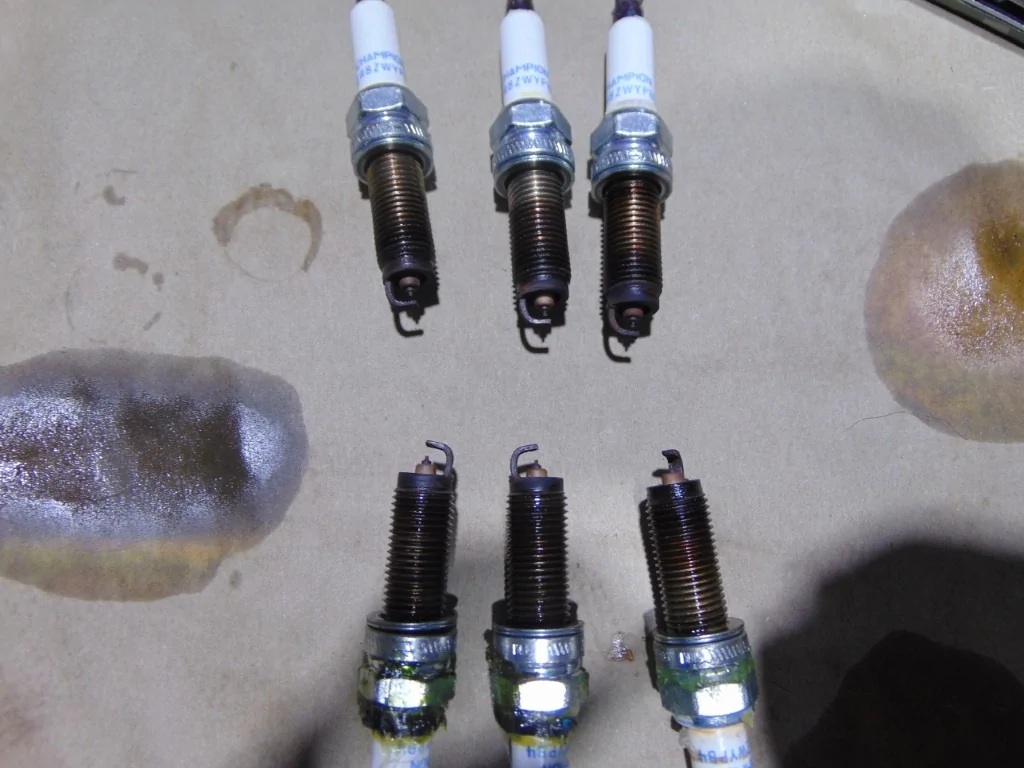

The old plugs gave me a surprise. I have no idea how, but look at how much the gap opened up! I bet the gap exceeded .060"
Jeep Gladiator 2022 AEV Gladiator Rubicon build DSC02937 (Medium)

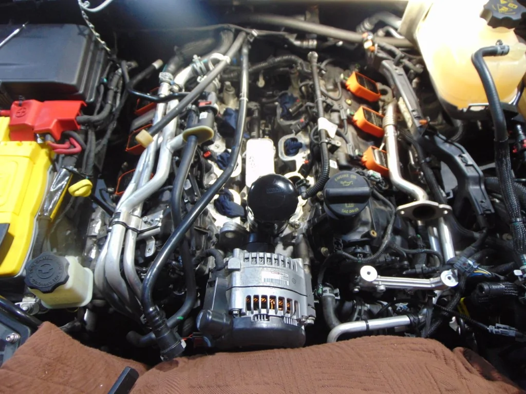

With the new plugs gapped, I threaded them into place and popped on the new Ripp coil packs
Jeep Gladiator 2022 AEV Gladiator Rubicon build DSC02938 (Medium)

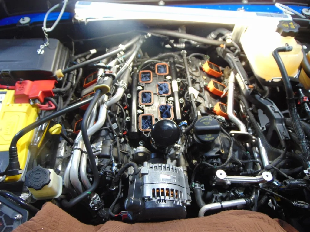

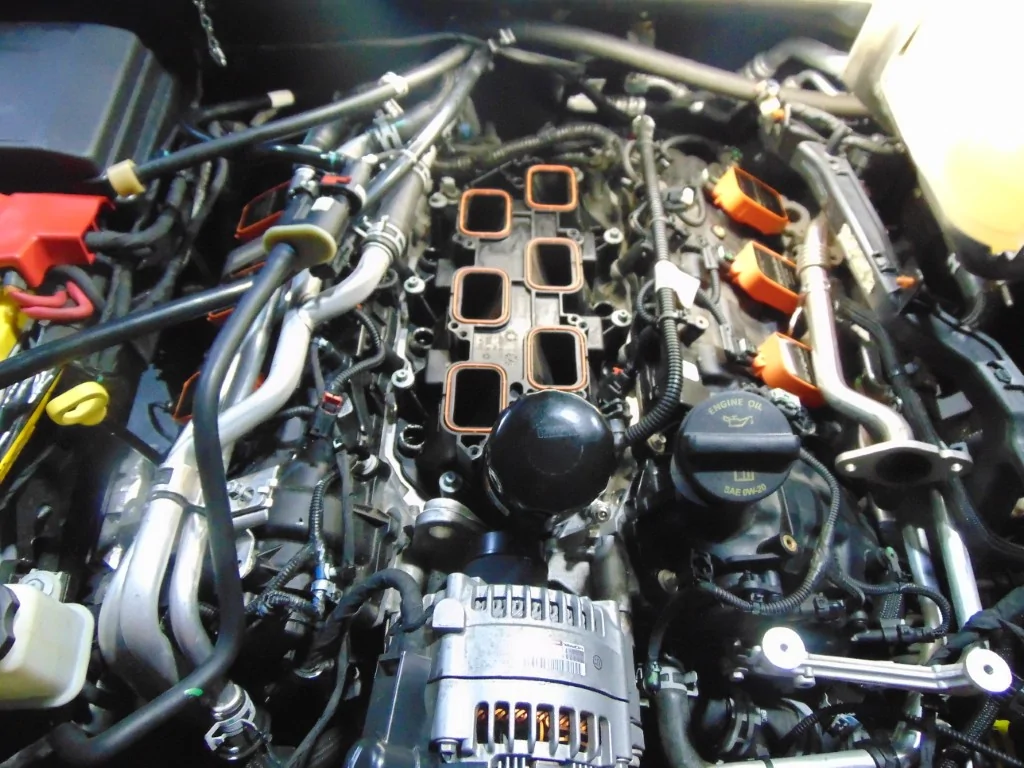

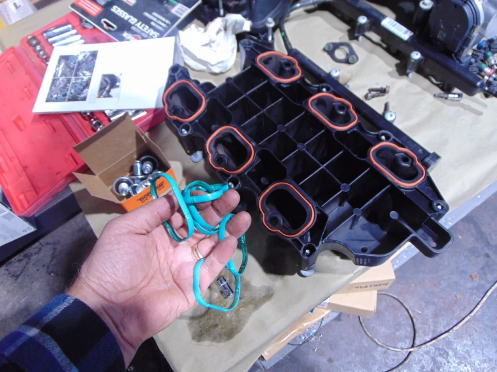

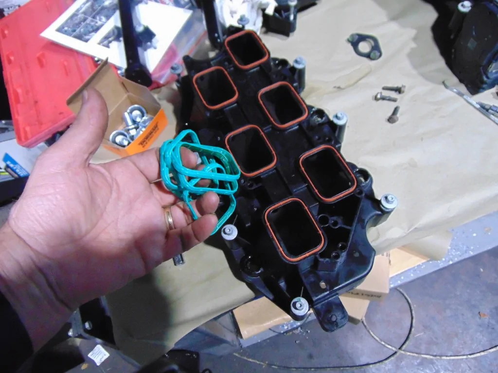

I replaced the factory gaskets, then reinstalled the intake manifold.
Jeep Gladiator 2022 AEV Gladiator Rubicon build DSC02940 (Medium)
Jeep Gladiator 2022 AEV Gladiator Rubicon build DSC02941 (Medium)
Jeep Gladiator 2022 AEV Gladiator Rubicon build DSC02942 (Medium)

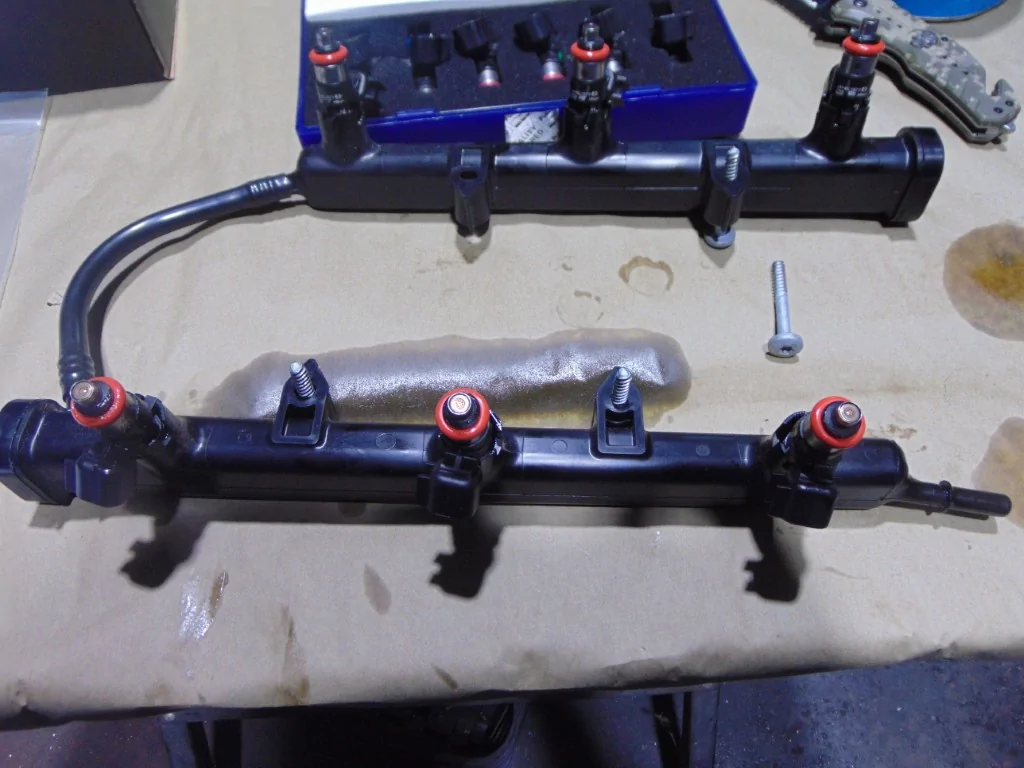

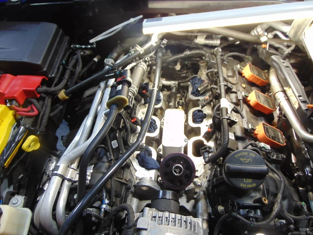

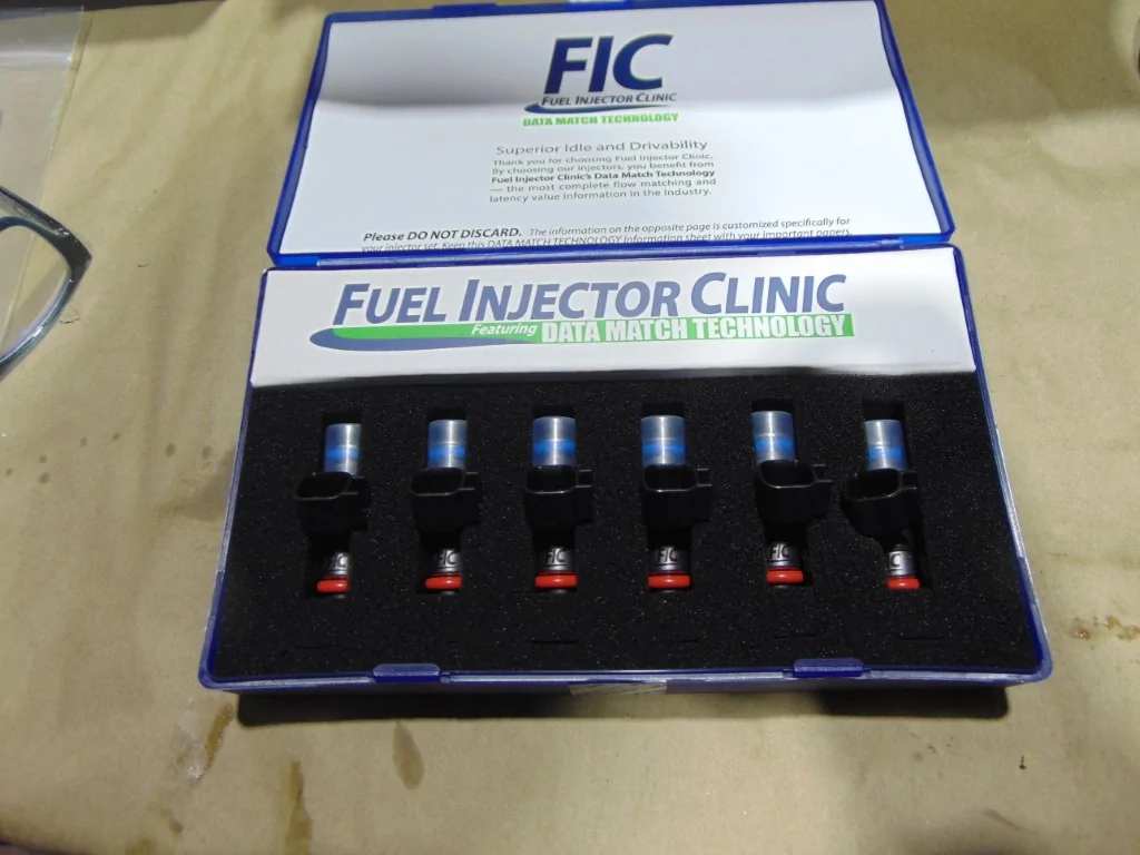

Next up, time for the new, larger fuel injectors. I gave the O-rings a light coat of grease and popped them into the fuel rail, then reinstalled that
Jeep Gladiator 2022 AEV Gladiator Rubicon build DSC02944 (Medium)
Jeep Gladiator 2022 AEV Gladiator Rubicon build DSC02945 (Medium)
Jeep Gladiator 2022 AEV Gladiator Rubicon build DSC02946 (Medium)

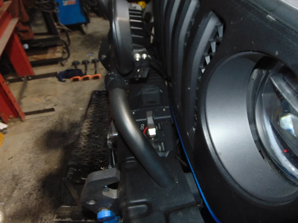

At this point, I have completed some of the Ripp supercharger installation and upgraded some parts. These steps would have usually been completed far into the installation, but I jumped ahead because of the Dorman oil filter/cooler upgrade.
With that behind me, I rewound to step #1, remove the factory grill.
That's when I noticed this:
Yup, the bumper and winch need to come off so that I can remove the grill!!!!!
Ouch!
And a good point to call it a day.
I'll get after the heavy stuff when I am fresh tomorrow morning.
I believe stock is somewhere .040-.044 ?? Something looks a bit off there.
Ouch!
Wow, on my 2022 I was able to pop the grill off with the steel bumper and Apex winch still in place!
Concur-
Something happened to open the gap up that far. Perhaps just the age and general use, but I haven't seen plug gaps that large before. It would take a bunch of energy from a good coil to fire across that gap. For reference, those cylinders were powered by stock Mopar coils.
Well, the good news is I have an almost finished Barnes Off-road bumper needing to get installed...

Are you going to change the oil before startup? Coolant usually finds its way into the pan when the oil cooler is pulled.
