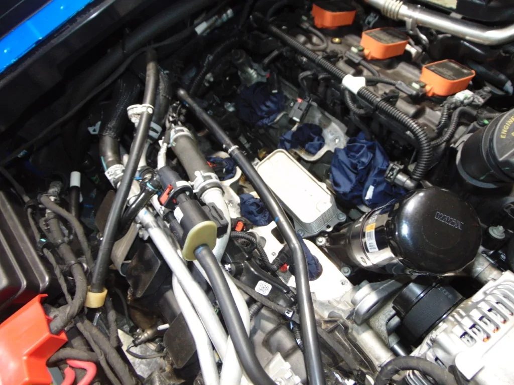

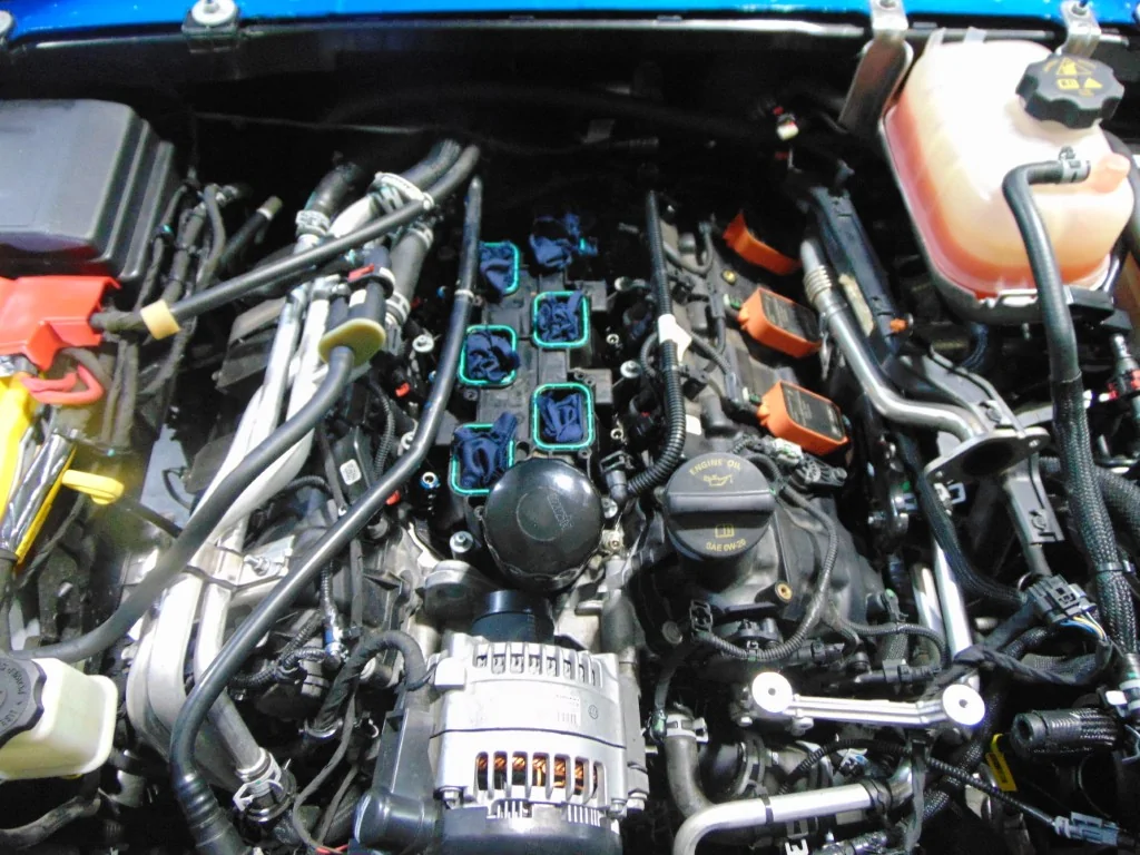

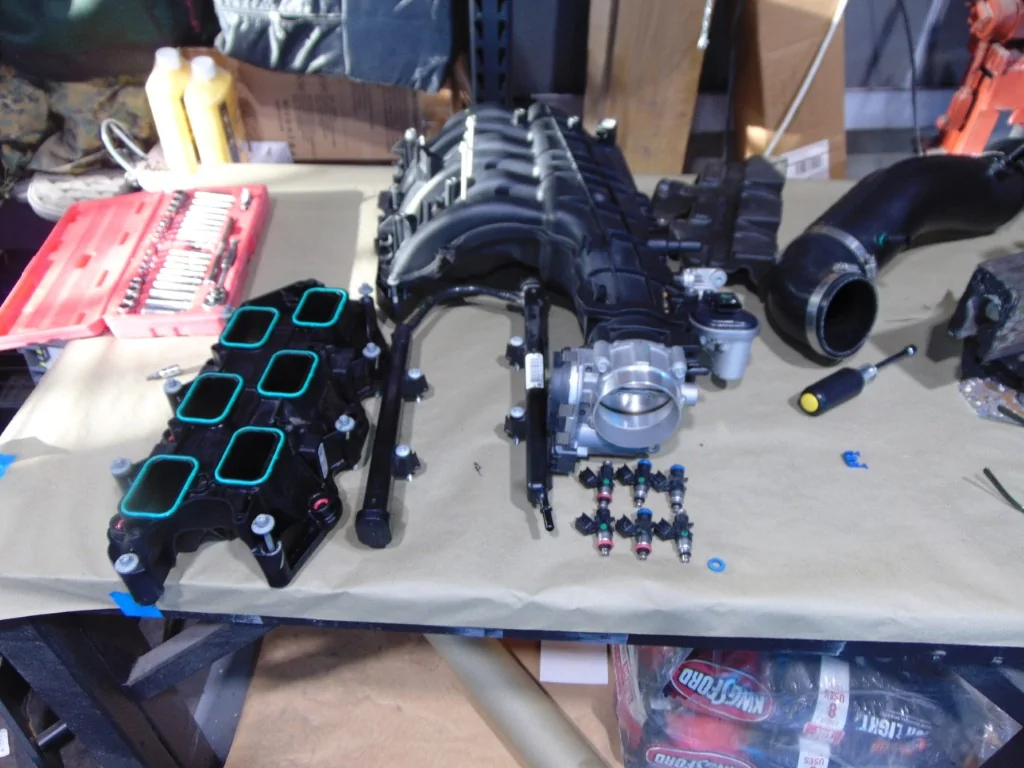

I've been tearing the motor down all afternoon.
Most everything came off relatively easily. well at least to this point.

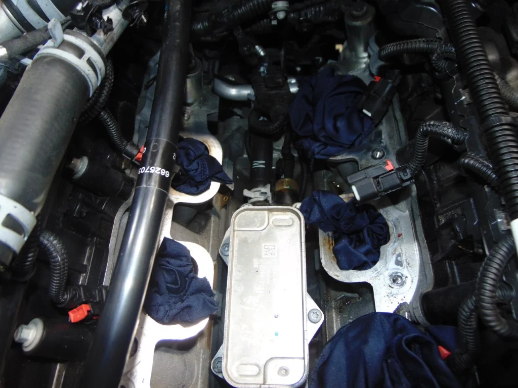

The injectors gave me some concern when I pried them upward after removing the fuel rail system. Getting to this point, nothing unusual was found. The original oil cooler housing had no sign of leaking, but then again, why should it? Currently, I have 19,000 miles on the JT, so most things still look new.

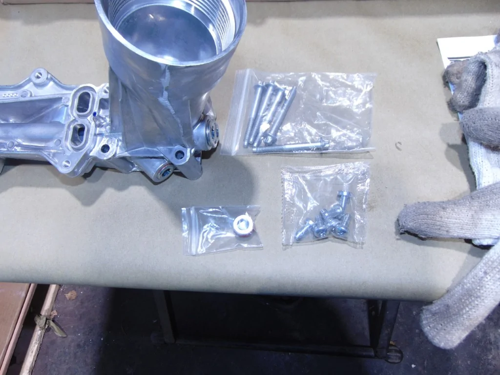

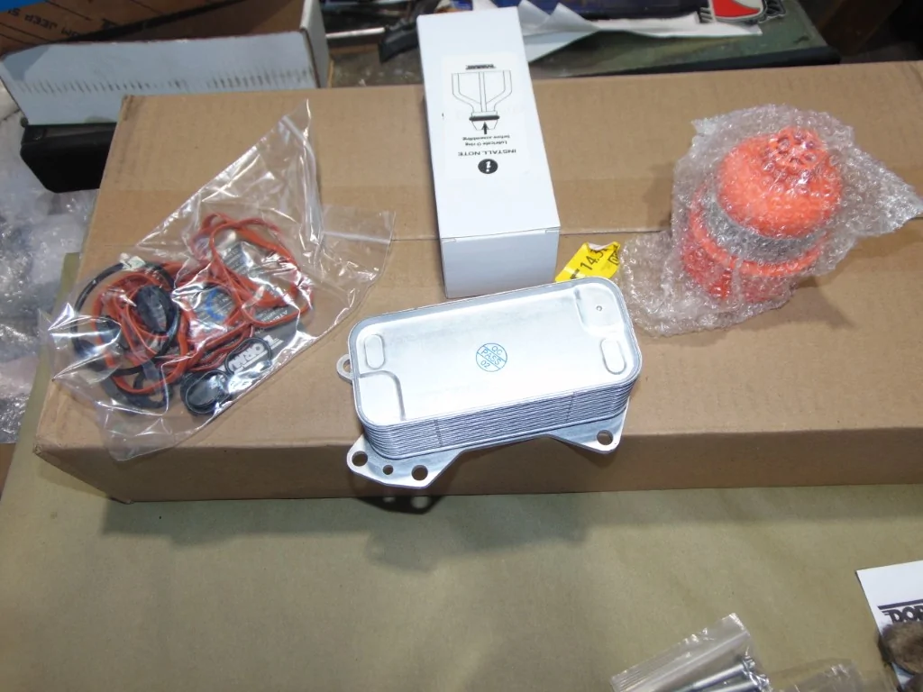

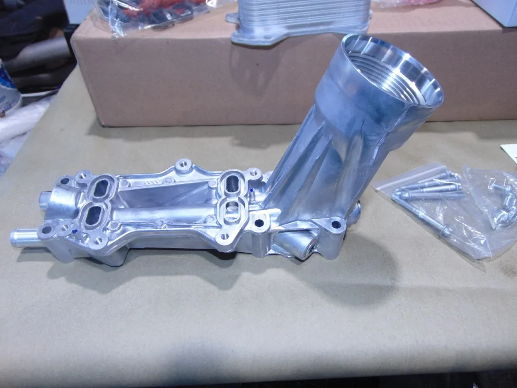

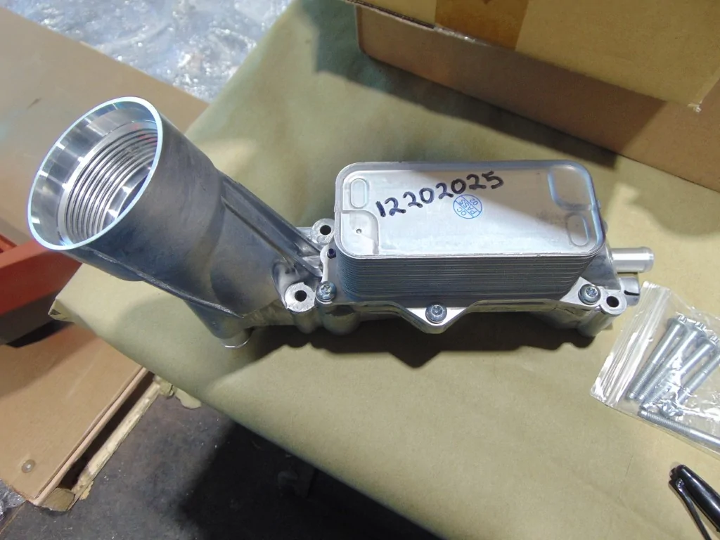

At this point, I prepped the new aluminum oil filter housing and oil cooler. Both of these are new, fresh out of the box.

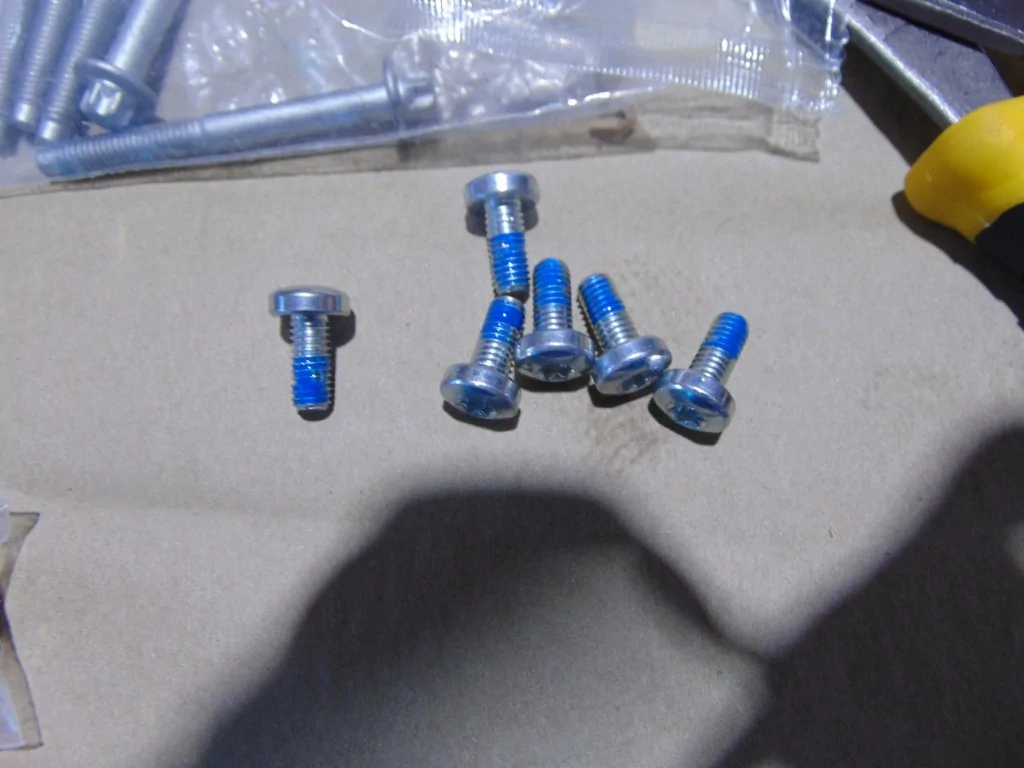

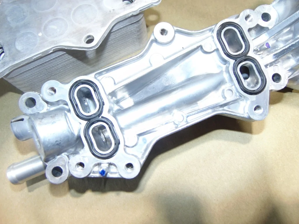

I dropped the O-rings into place, gave the screws a spot of blue locktite, and bolted the new oil cooler onto the filter housing.
I date-marked the part so I'd have a photo record of when the thing was installed

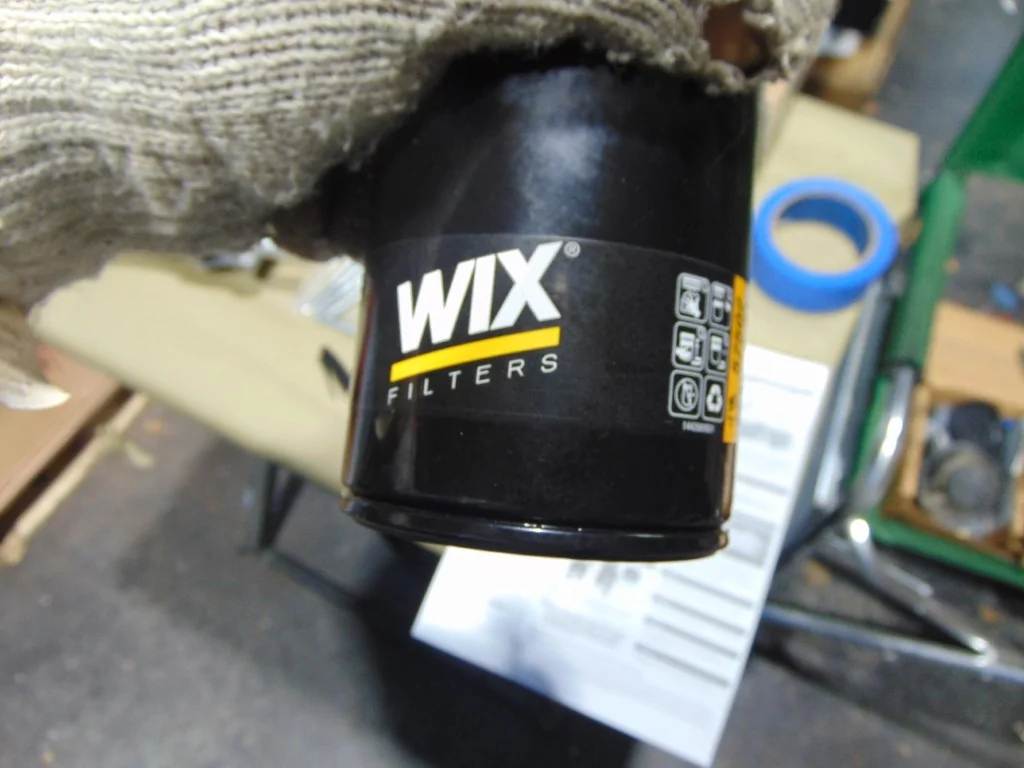

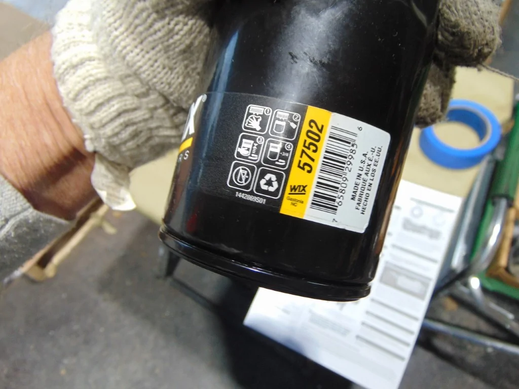

And, photographed the oil filter for the same reason. I prefer these Wix filters to most others.
This fits the Baxter Performance oil filter adapter I am using.

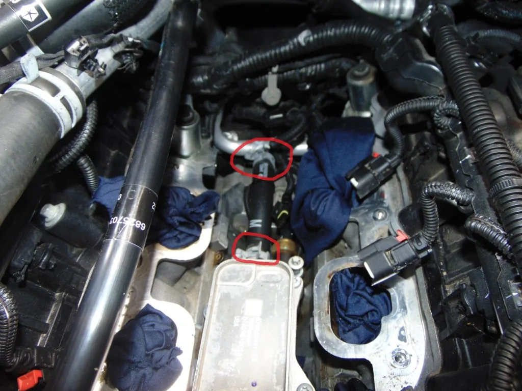

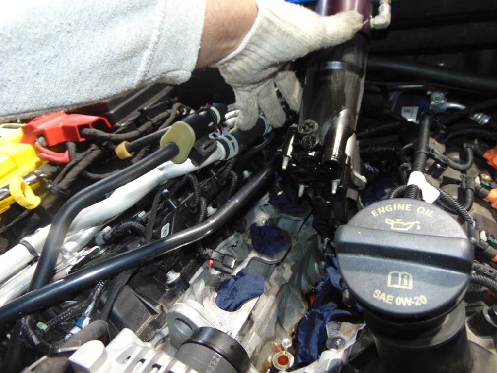

I am having one heck of a time removing the stock oil filter housing. There is a rubber hose clamped to the supply manifold and the oil cooler. With the narrow spacing between the heads and the various hoses, pipes, and wiring harnesses, it is next to impossible to get pliers in there to squeeze that clamp. Furthermore, it is a three-handed job, and I was born with only two. After wrestling with it for over 30 minutes, I threw in the towel and called it a night. If that hose/clamp had released, the new oil filter assembly would have been installed, as that was the goal for today.

They make clamp tools for that where the jaws are on the end of a flexible line and the plier part works remote of it.
I recall seeing those...Off to Northern tool!
40,499
54,017
Yeah, like that. Fleet Farm, Amazon, Northern Tool and so on.
With what you are doing, I think it's worth the few bucks investment. .
Want to see you/this project succeed.

You can roll the filter housing and twist the hose and usually get to the clamp with some long needle nose pliers once it is in a better position,
