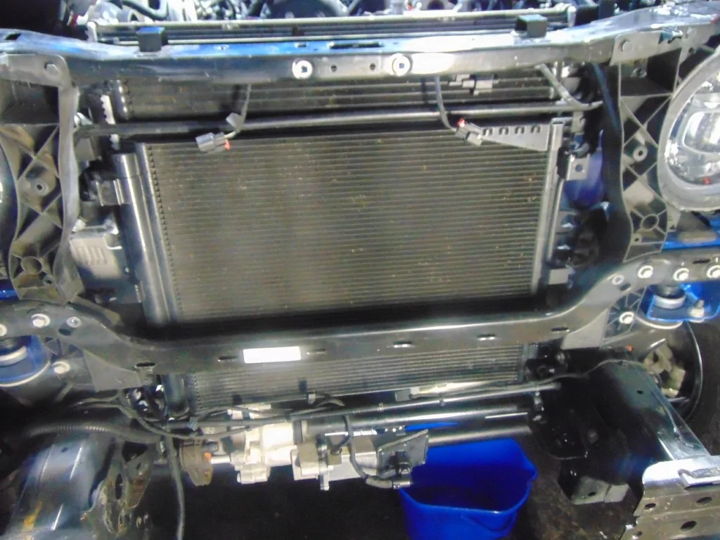

The new aluminum 3-core (really three tubes) looks quite nice and well built.
If you don't mind, who makes that radiator and where did you get it?

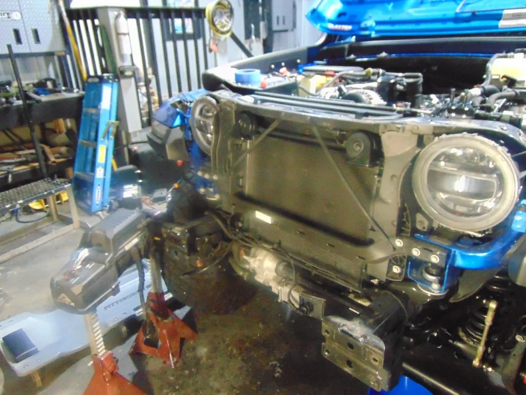

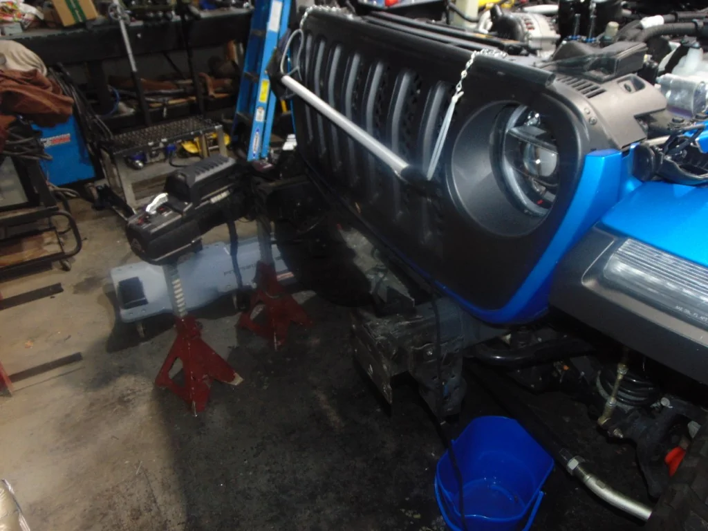

Tonights updates, although extensive all suffer from some pretty poor picture quality. I don't know what happened...I cleaned the lens this morning, then went after it like a Beaver stuck in a log jam.
Well, getting us out of the gate. First up, I unbolted that Arcus bumper which will not get reinstalled and easily lifted out the grill
Jeep Gladiator 2022 AEV Gladiator Rubicon build DSC02950 (Medium)
Jeep Gladiator 2022 AEV Gladiator Rubicon build DSC02951 (Medium)

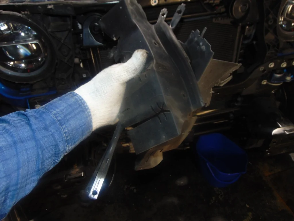

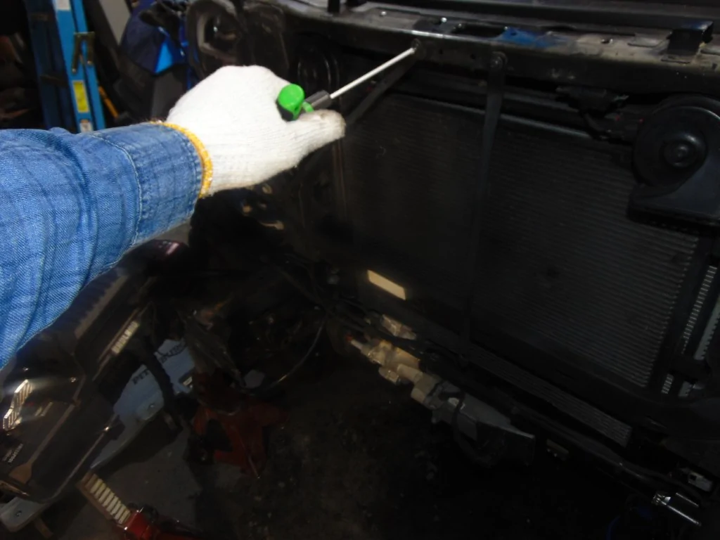

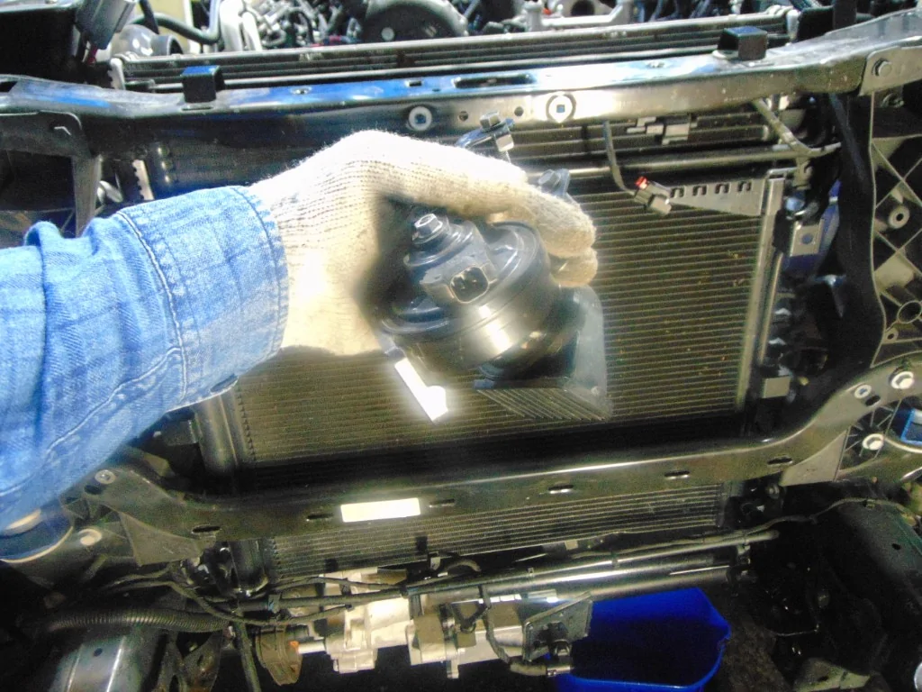

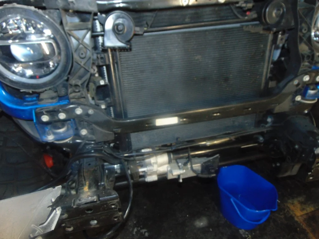

I just followed along step by step from Ripps install manual. For the most part it is pretty good, but I hit a snag just as I was finishing. The instructions were just not detailed enough, but we'll get to that.
After the grill goes away, you remove the cross braces, the plastic panel on either side of the radiator, then the ram air thingy, and finally both horns.
Jeep Gladiator 2022 AEV Gladiator Rubicon build DSC02953 (Medium)
Jeep Gladiator 2022 AEV Gladiator Rubicon build DSC02954 (Medium)
Jeep Gladiator 2022 AEV Gladiator Rubicon build DSC02955 (Medium)

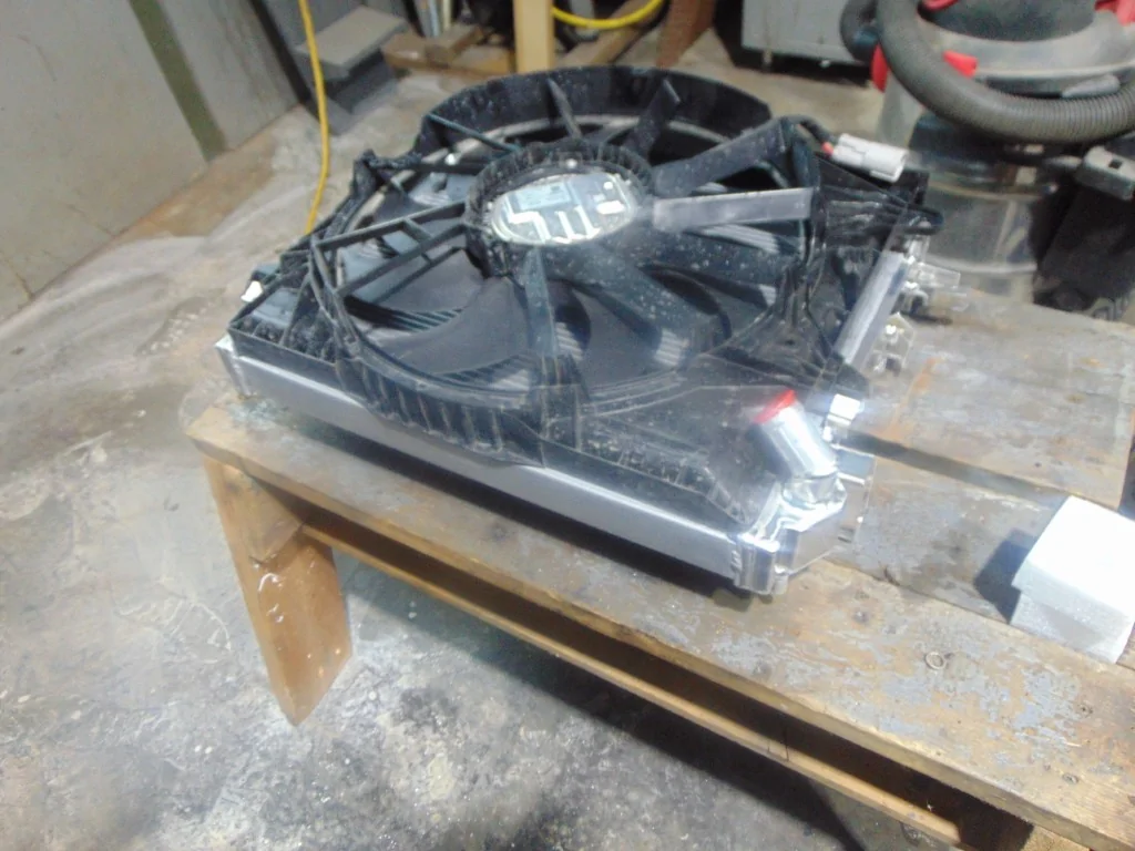

Next the fan comes out.
Here I fitted it to the new Chineseium radiator. The fit was perfect.
Jeep Gladiator 2022 AEV Gladiator Rubicon build DSC02957 (Medium)
Jeep Gladiator 2022 AEV Gladiator Rubicon build DSC02958 (Medium)

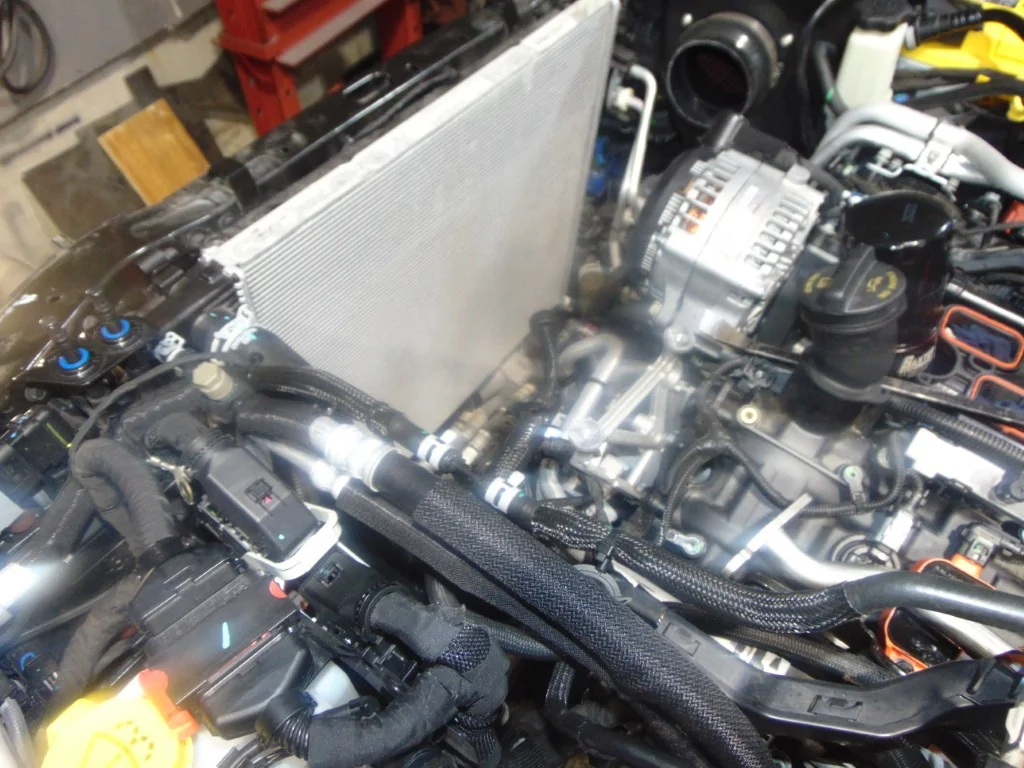

After seeing just how tiny the factory rad is, I got to thinking: is that new unit too thick??? It is easily double the size of the stocker.
Jeep Gladiator 2022 AEV Gladiator Rubicon build DSC02959 (Medium)
Jeep Gladiator 2022 AEV Gladiator Rubicon build DSC02960 (Medium)
