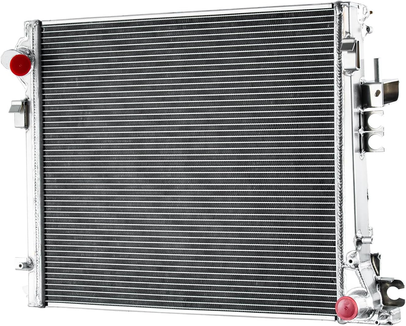

Sensitive to the increased cooling demands I am going to switch to a 3-core radiator. I haven't checked, but doesn't the Gladdy come stock with a single core? Anyway this one holds something like 30% more fluid and offers north of 40% increased cooling capacity.

Be sure to update on how fitment goes with this. It's been something I've been thinking about for the ecoD, but it's already packed in there so concerned about fitment.

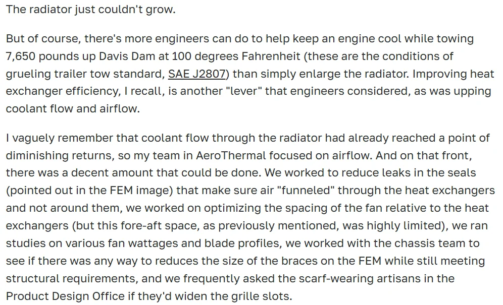

Something to consider - diminishing returns, and - restriction of air flow through the other cooling modules.
Add layers of rows doesn't always improve performance, in some cases, you may end up impeding air flow through other coolers, the condenser coil and so on. That same air has to remain cool enough in the entire journey, grill to fan, to cool things. Once it's saturated, it doesn't add to the cooling. It might impede air flow in the end.
So, this is something to watch really closely - does the AC, transmission, whatever, still get required air flow. Does the extra row in the core help, or do nothing?
Jeep didn't add another row to the core due to those "diminishing returns" - it didn't help, in other words
