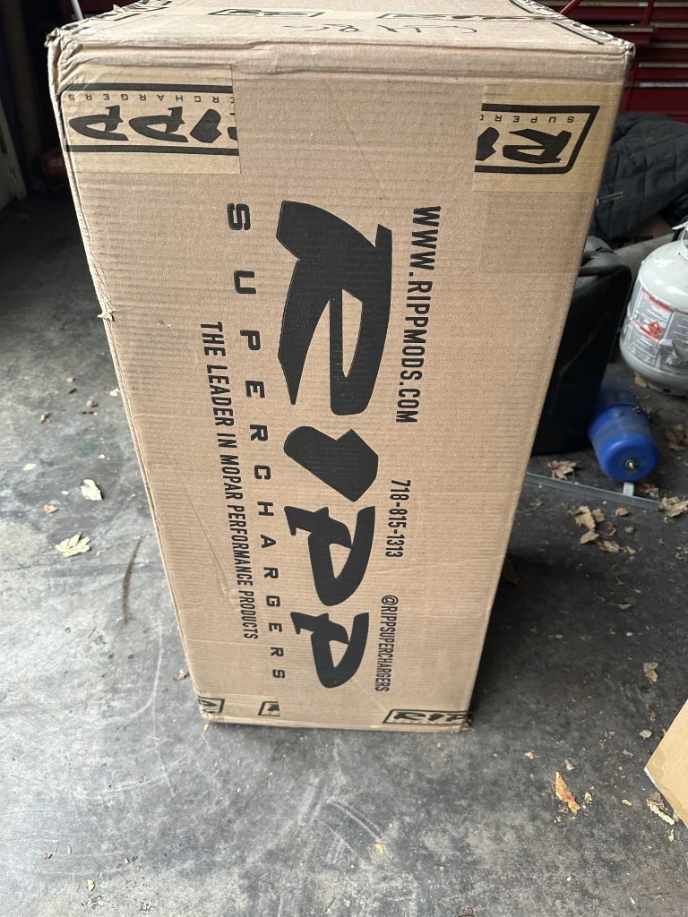

OK, so here we go on the supercharger upgrade.
I expect this to be a slow boil. I just got the box of cool stuff and am awaiting the arrival of the new Dorman aluminum oil filter housing.
I'll have to remove the ECM and ship that off to HP tuners, and with this being Christmas, it will be one of the following:
1. Delayed due to the season
2. Delayed due to shipping
3, Missed or screwed up by someone who spends all their time glued to their smart device
4. Lost in the mail
5. Retuned with a supercharged Hellcat tune
6. Chipped
7. Broken
8. Crushed
9. Returned to me ready to install

I’ve been keeping up with your supercharger thread. My plan has always been a 5.7 swap once my warranty is out but would love to go this way. I truly hope this works well for you!

Can't wait to see the install and read your impressions on both the install and the new found power. Definitely leaning this direction now that our GPEC5 support is available. Especially reading the other thread where the guy hit 230k miles before his v6 had cam issues. Beats the hell out of the $30k for the hemi swap and even if I end up there it's the same supercharger ripp uses for the 5.7L kits so it shouldn't take much to add it to the hemi swap and be pushing ~600hp.
