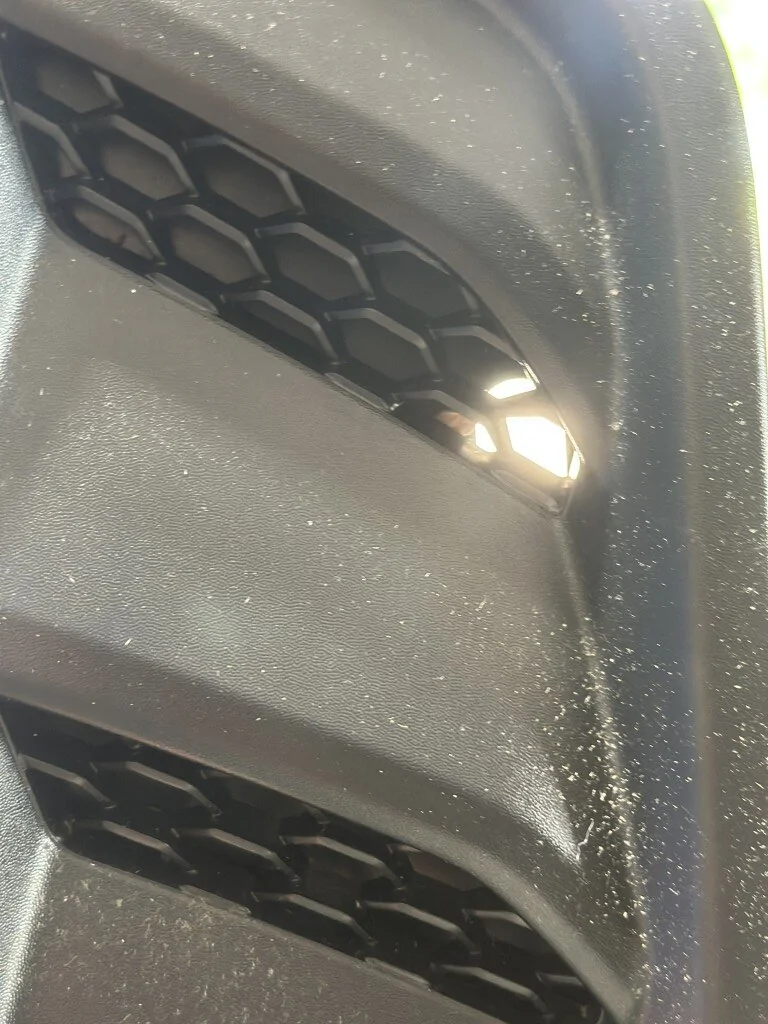

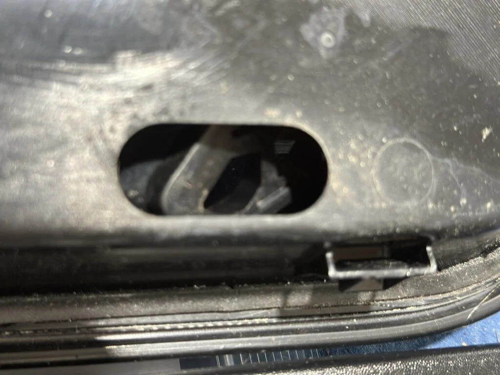

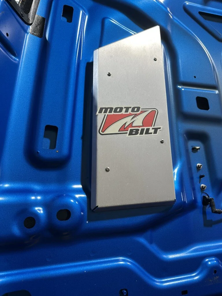

Just to illustrate the hot air extraction gap between that tray and the hood, Here's a pic
I also have one showing the factory pass-through in the factory louver.

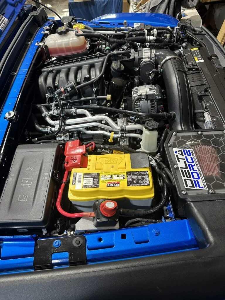

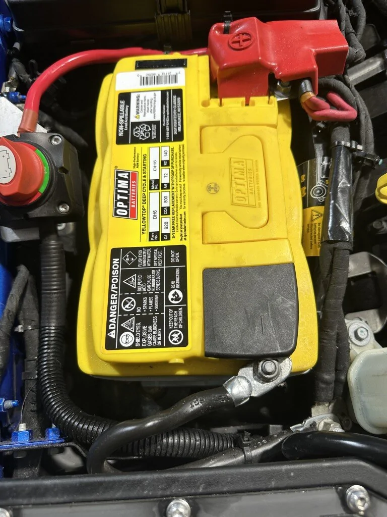

...And the battery issue is solved
I went with the recommended Optima Yellow Top
It was easy to purchase from AutoZone, where I can take it back if it gives me trouble.

Ahhh ok that's exactly what I was looking for. The first pics almost looked like a sealed unit, which made no sense. Thanks for the clarity!

I aint never had that nasty blanket off your telling me there is a darn hole in it already 🤯 ...if so then the blanket keeps water from coming in under the hood
Nosir, that blanket (Hood mat) is simply allowing the water to flow down its foil-backed side and out into the engine bay somewhere. :-0

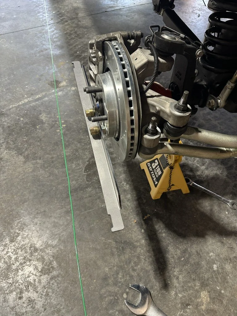

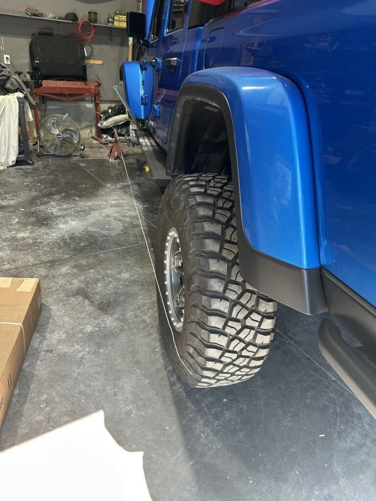

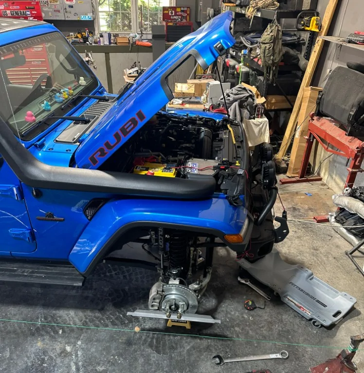

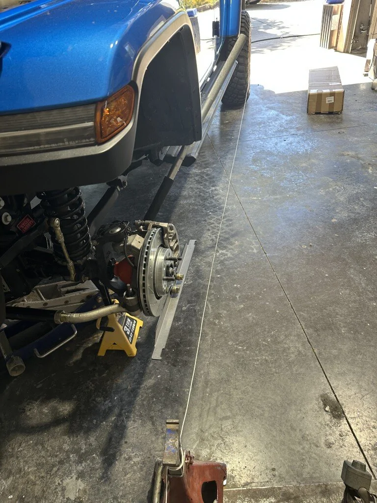

Currently doing a "string" front-end alignment.
Just experimenting really, or having fun doing something I used to think was normal! Anyway, I got it pretty close, but I plan to take it to a good alignment shop to fine-tune it and see just how close I was.
Working on 5.5 degrees Caster and currently a tad more than 1/4" toe-in. I think I'll leave it there to drive the few miles to the shop.

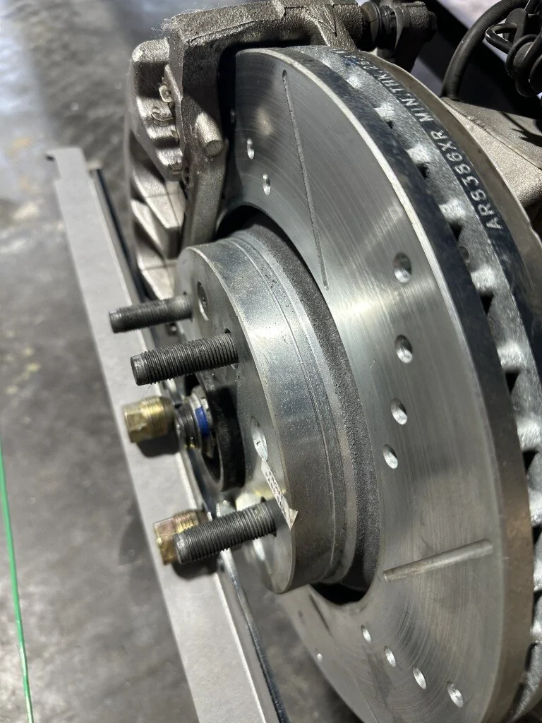

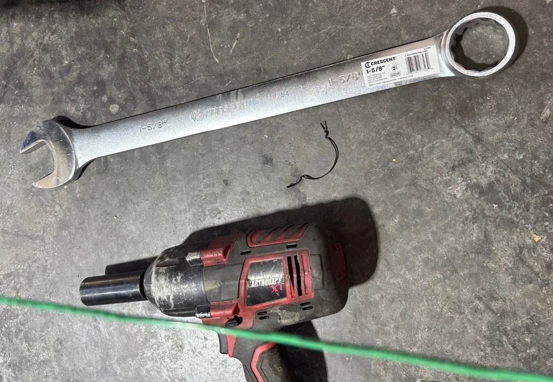

I am using Rusty's alignment tool along with that huge 1 5/8" wrench they sell for their oversize steering linkage.
Oh, and that battery monitor/charger is doing its job.

You'll have to let us know how close you got it once they put it on the rack!
