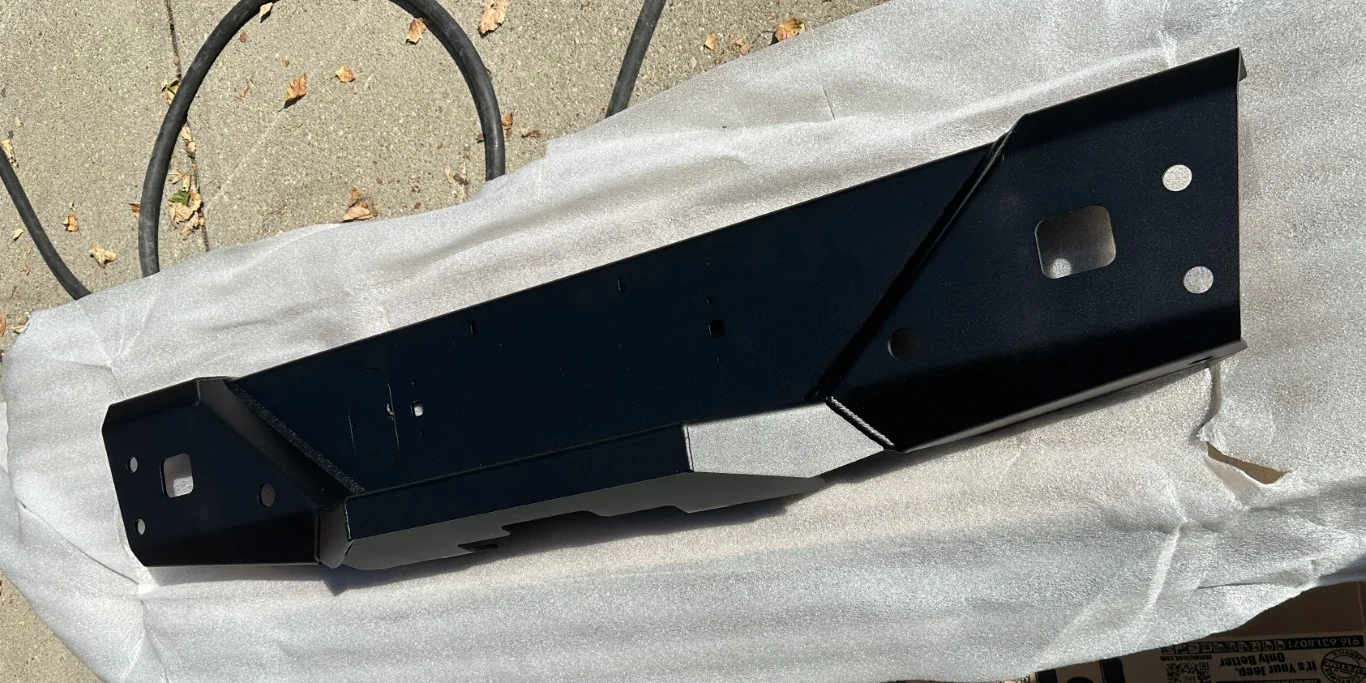

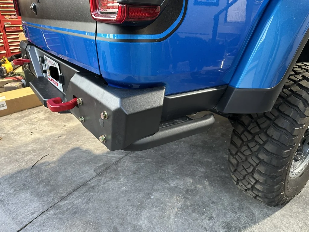

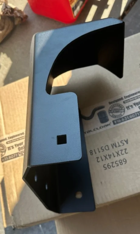

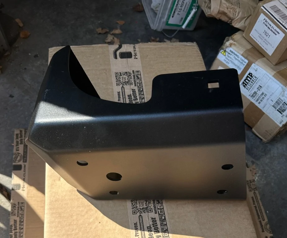

Today I started installing my new MetalCloak rear bumper.
I liked their design for its simplicity and the reasonable price I paid for it on Labor Day.

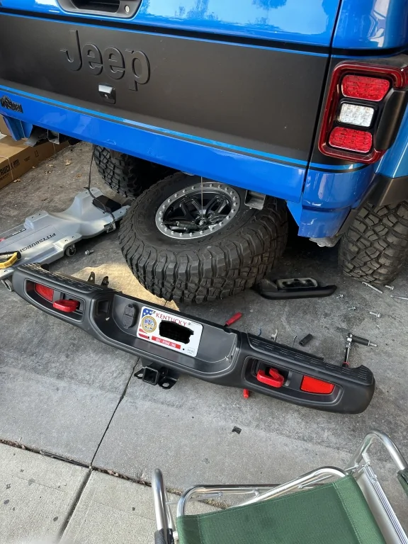

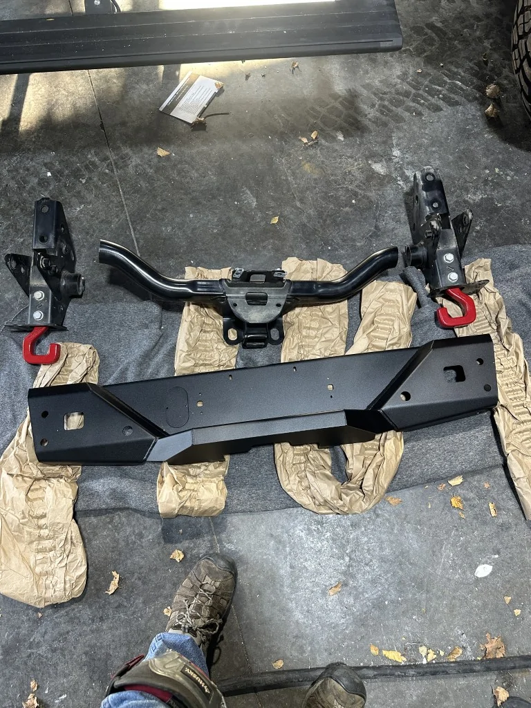

I will retain the factory Rubicon rear bed side guards because they are free and they work. I yanked the old bumper off first

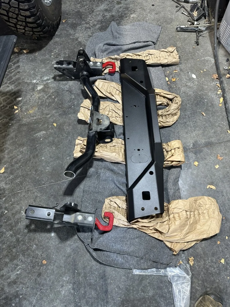

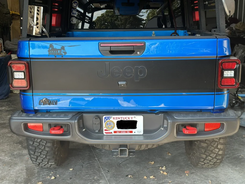

I will be doing something different with this installation. That is eliminating the rear tow hitch assembly. I never use it, it's dead weight and it reduces departure angle, although I don't think I have scrapped it yet...just looking ahead.

I always figured the rear hitch was a free slider, but I'm guessing the metalcloak bumper would probably hold up better to being drug across a rock then the factory bumper. Looks simple but effective.

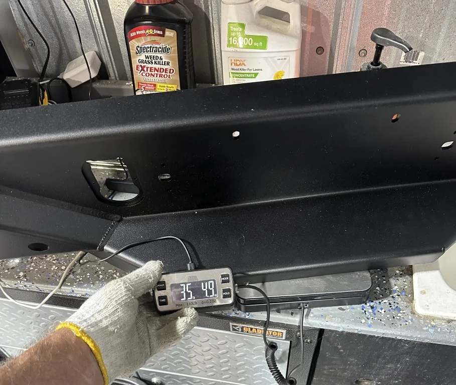

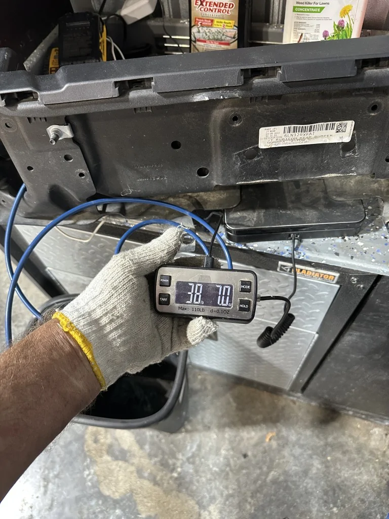

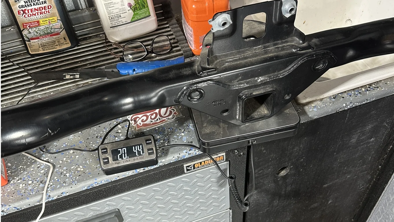

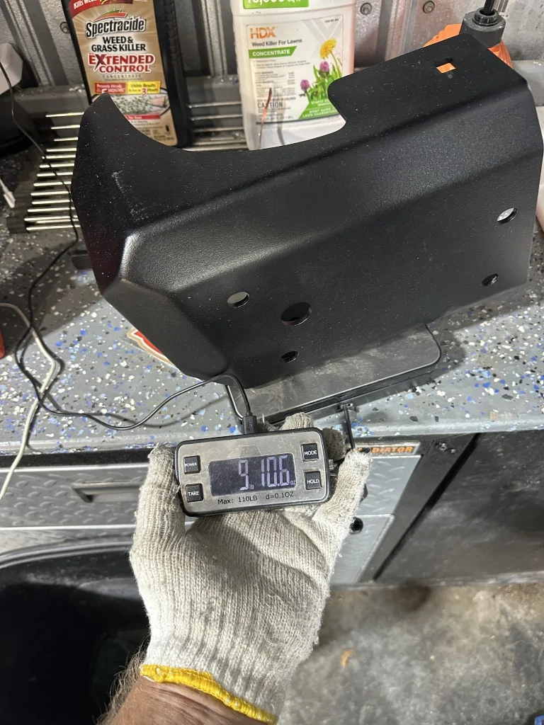

And here is how it worked out with respect to weight:
Stock bumper: 38.9
New bumper main body: 35.5 lbs
End pieces: 9.1 ea X 2 = 18.2 lbs
Total new bumper: 53.7
Minus the cut-out hitch section: 20.4 lbs
Total new bumper weight: 33.3 lbs
The bumper mounts and the side rails all remain the same, so with all things considered, the new MetalCloak bumper, as installed, reduced the vehicle weight by 2.2 lbs...Call it a wash.
I guess I'll find out. I will add some structure to the inside later on to beef it up a bit

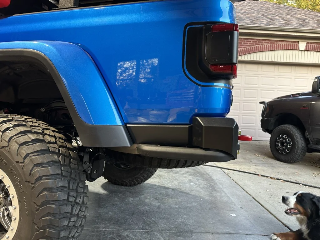

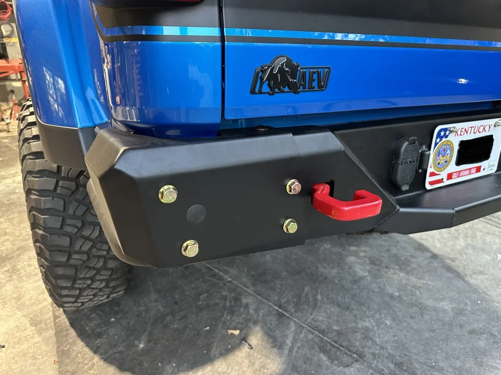

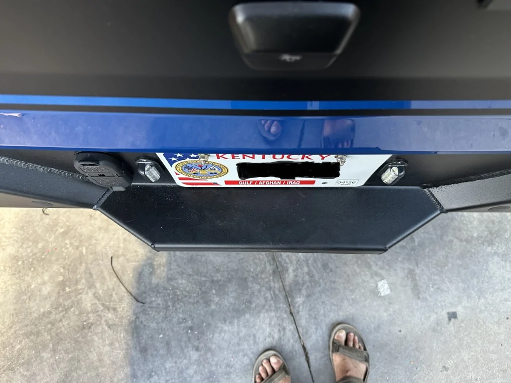

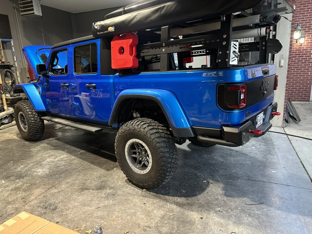

Finished the bumper installation this PM. Well, finished for now. Having looked at it, I believe I will add a stiffener to the lower edge since I "X-ed" the tow hitch, which also serves to brace the stock bumper. It's good for the trail as is, but I may still have to protect against being rear-ended.

I now have a clear 28" below the bumper's lowest point. Couple that with the recent 1.3" additional lift, and I should be sittin' in tall cotton on those steep exit stream crossings
