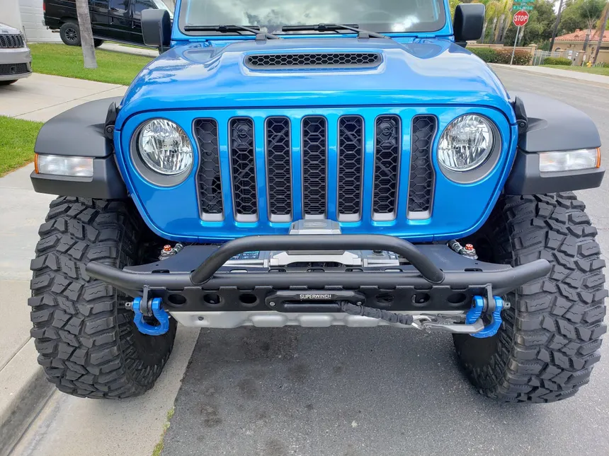

Don, before I would be doing radiators, fan controllers, new grill and things like that I would look at the bumper and lights . I love your bumper and think it is a great design ,still clearance but coming up to block airflow on top of tire , but what if the bull bar went away and instead mount smaller lights on the raised portion the bull bar sat on , that has to increase air flow , lights and bull bar would be out of radiator space , done well lights would look really custom. Still thrilled with your plan though.
Just saying bud!…..Jack

It's amazing what will interrupt air flow up there........... and cause weird flow patterns besides.

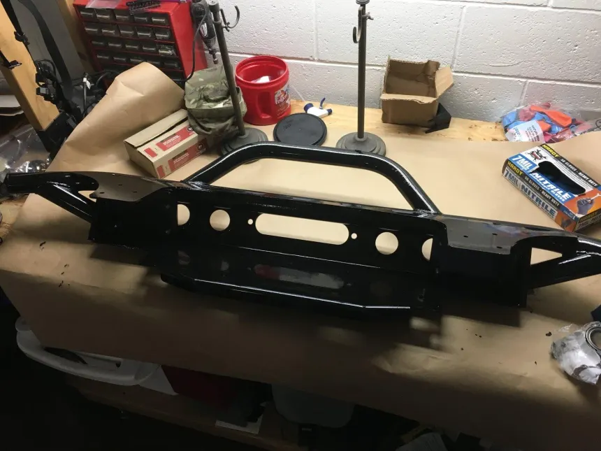

Funny you should mention that.
I am just about finished welding up my new Barnes Off Road Pritchett ridge bumper. More a tube thing than the flat faced shorty design. I selected that to reduce the weight a little, improve air flow, and I like the more spartan design.
Jeep Gladiator 2022 AEV Gladiator Rubicon build pr1
Jeep Gladiator 2022 AEV Gladiator Rubicon build pr2

Bingo on the bumper!
Should be a big improvement for airflow already!….Jack

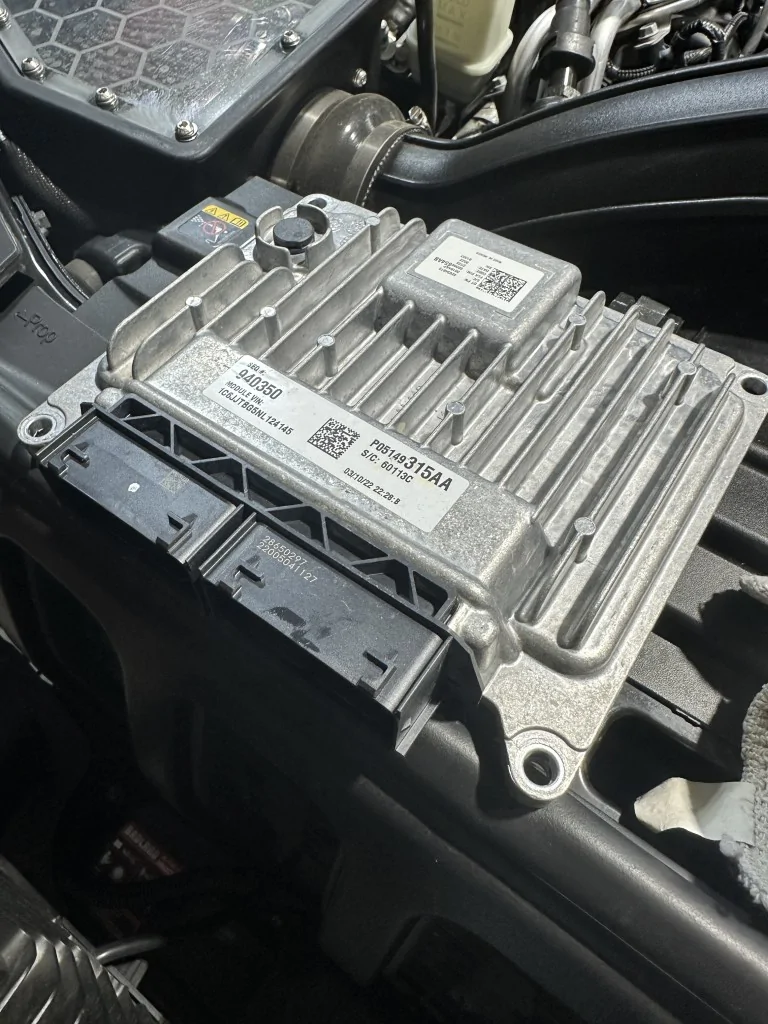

Computer comes out tomorrow and gets shipped off to HP Tuners.

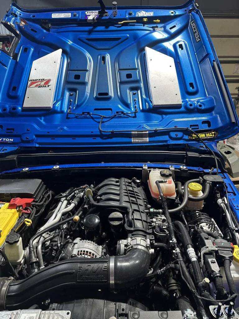

Started on the Supercharger install today. Just mild teardown stuff and sorting. I tried to box up and ship off the ECM. but HP Tuners site has some technical glitch. BTW, their unlocking service for the GPEC5 is $249 + shipping
Jeep Gladiator 2022 AEV Gladiator Rubicon build IMG_0916 (Medium)
Jeep Gladiator 2022 AEV Gladiator Rubicon build IMG_0925 (Medium)

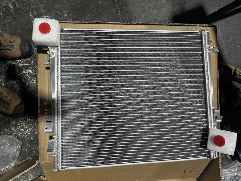

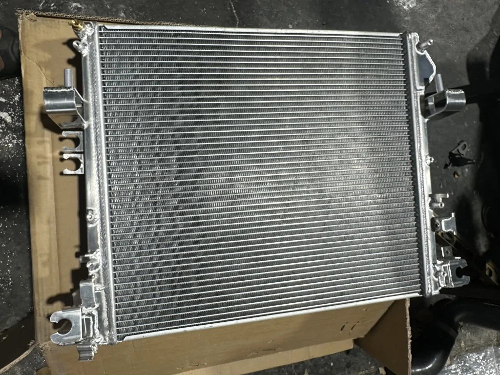

The new aluminum 3-core (really three tubes) looks quite nice and well built.
For those following the SC installation, the radiator is not included in the RIPP kit. I just decided to do some upgrades while everything is torn down.
Jeep Gladiator 2022 AEV Gladiator Rubicon build IMG_0927 (Medium)
Jeep Gladiator 2022 AEV Gladiator Rubicon build IMG_0928 (Medium)
