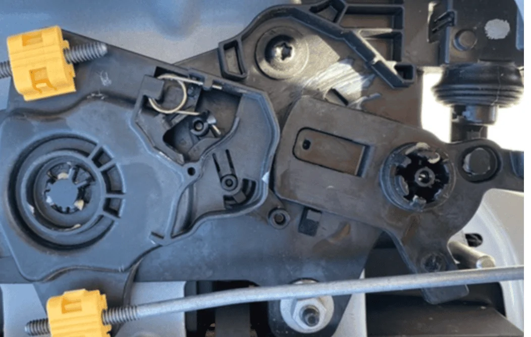

Just got a new 2022 gladiator sport last weekend. A base model with manual locks. The tailgate was locked when I first brought it home and used my key to unlock it and it wouldn’t lock, I thought there was a piece missing after looking inside the tailgate there, but the dealer says that it’s not supposed have a lock which makes zero sense why you would have a truck with tailgate and make it so it can’t be locked.

Is the locking mechanism floating around inside the tailgate?

Didn’t see anything.

Yes they are supposed to lock. I have a 2021 and it locks ( manual everything ). Would not make any sense for it not to lock. Dealerships are terrible. Take it back in and have it repaired.

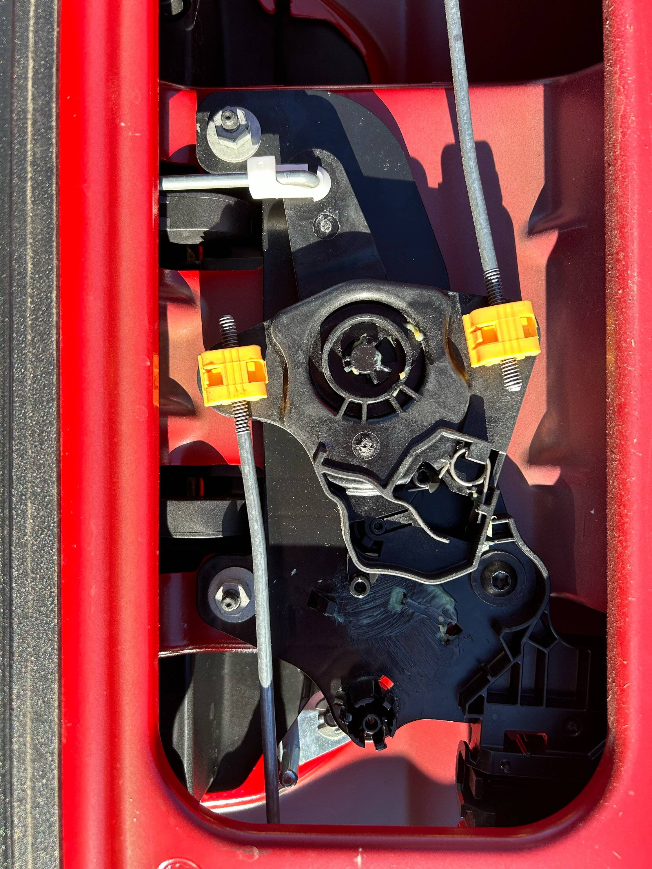

2021 Gladiator
Look to the right of this photo, you are missing the piece.

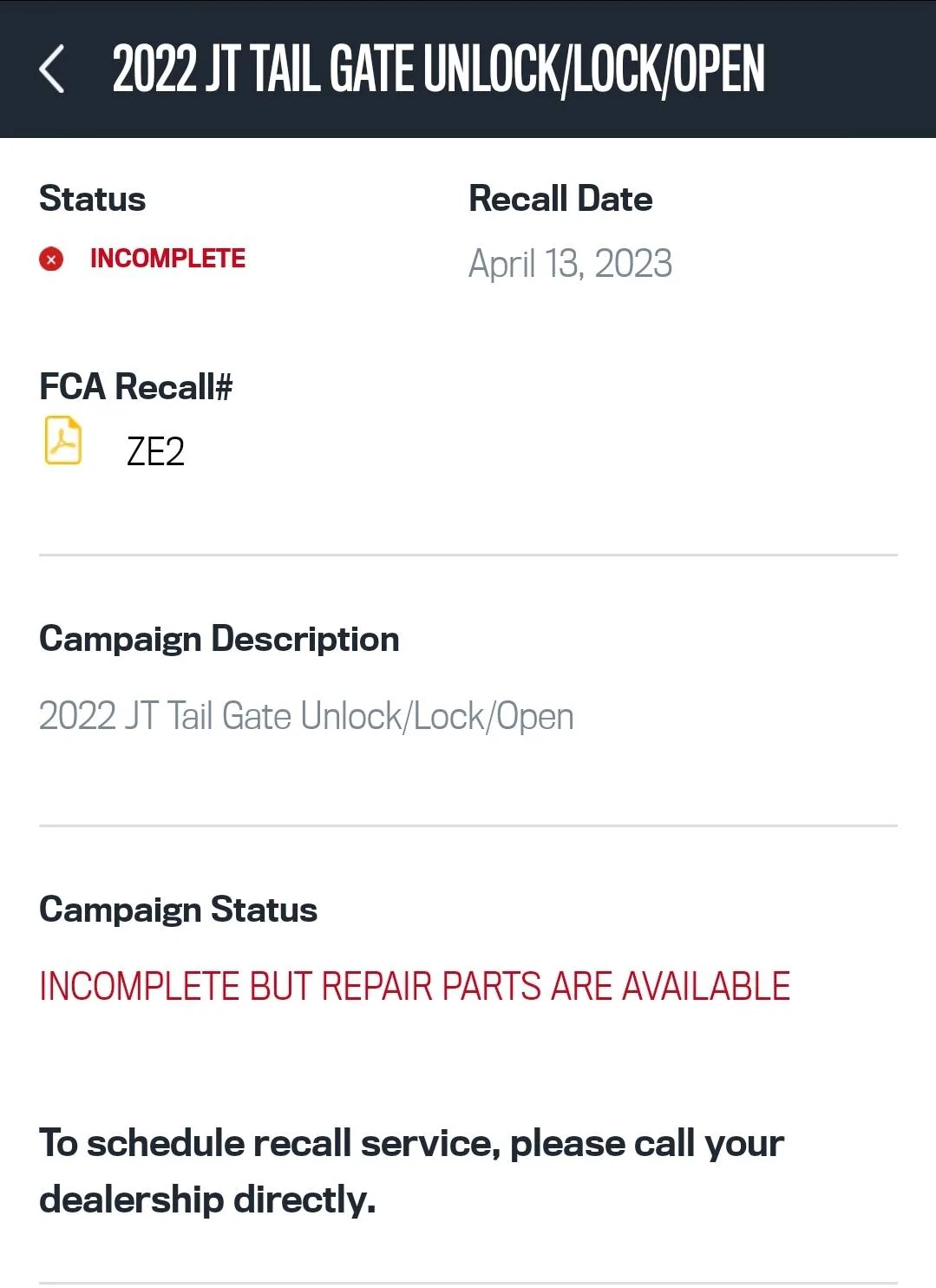

Got it fixed. Ended up contacting jeep wave who looked up my vin and confirmed it was supposed to lock and suggested I just not bother with that dealer and go to another dealer to get it fixed.
Theres a TSB/Recall I forget what name, but its for this exact issue. Go to a new dealer

There is a current safety campaign for the tailgate lock.
I just received it.
