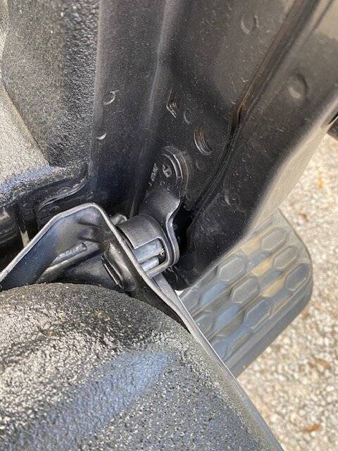

Just looked and I do indeed have that do-hicky on my passenger side tailgate.
Just looked at mine, no security bracket like yours. That is a heck of a lot better than the cheesy tailgate locks that several vendors sell. Looked online and haven't seen that bracket to try to buy one. Will check with my dealer. Thanks!!

Looking at the above photo without the bracket makes it look like the bracket may not be able to be added. I don’t see threads for a bolt
This above. It's missing the welded on nut.

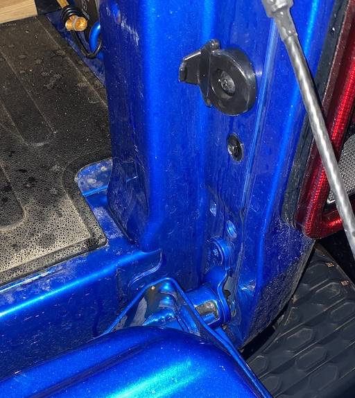

It does look that way but it is too low resolution of a photo and from an angle that might not show the threads. The threads are indented a ways in the larger hole. Here is mine from an off angle at low resolution. It has threads. Brighter paint color and flash photo gives it away some.
Mine has a recessed nut. I still think that either Jeep went real cheap with a 50cts part… or someone on the assembly line just forgot to bolt on that locking plate.
I found the bracket online. Mine has a large indention, but no threads. I'll take an icepick and see whether there are indeed threads further back that can be cleared out. If so, great, if not I'll remove the tail light to make sure I don't get into any wiring and drill and tap a hole or drill a hole and use a button screw with nut on the backside. Will let you know how it comes out.
