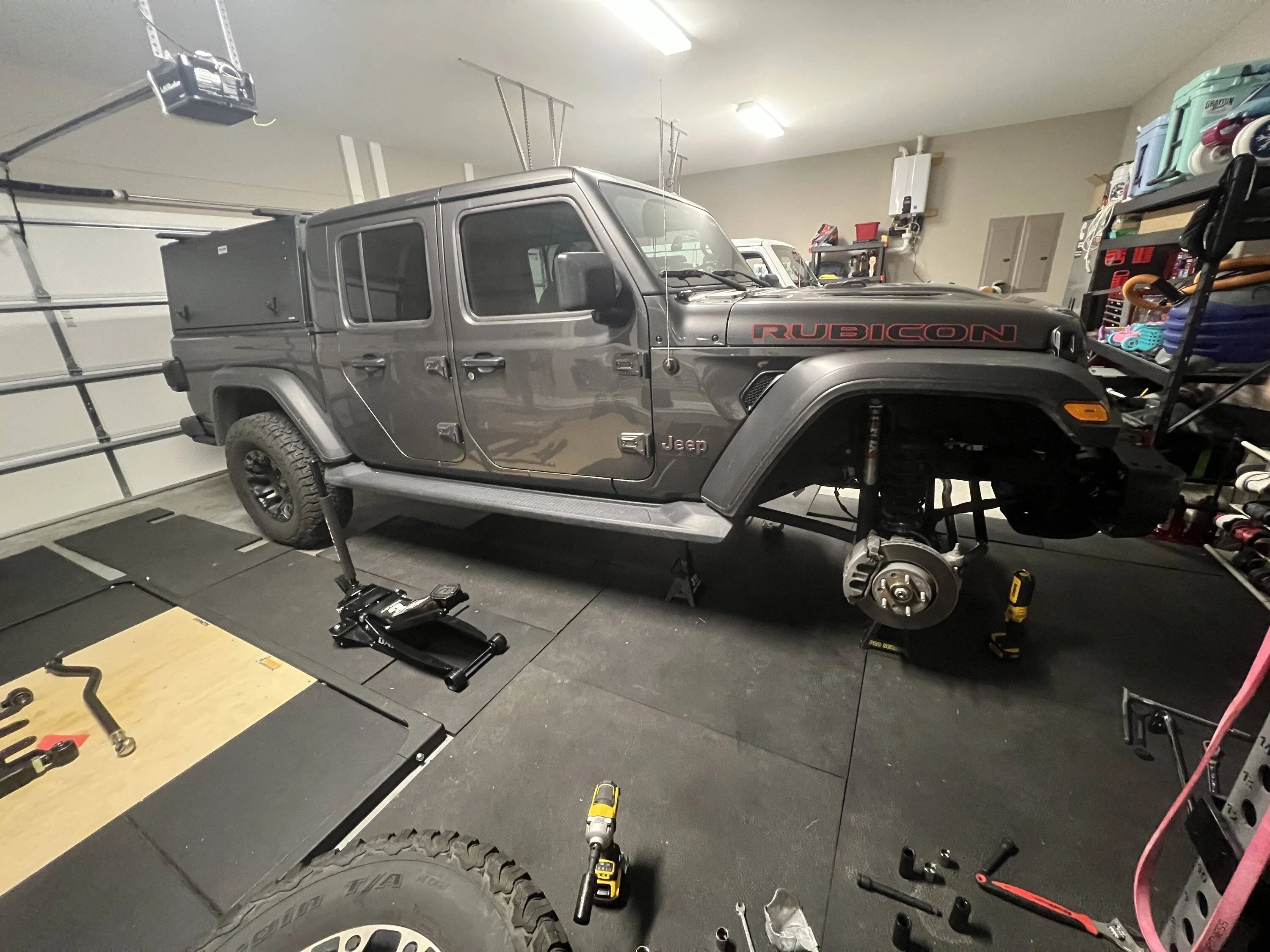

That’s what i was figuring. Whats the easiest way to adjust the caster without having to unbolt everything?
Shortening the front uppers is going to be your best bet! Also, when you bolt them back in, don't worry about trying to make them both the exact same length, as doing so tends to lead to unnecessary bind and premature bushing wear. Just get one set to your desired length, and the other just adjust as needed to get the bolt hole to line up :)

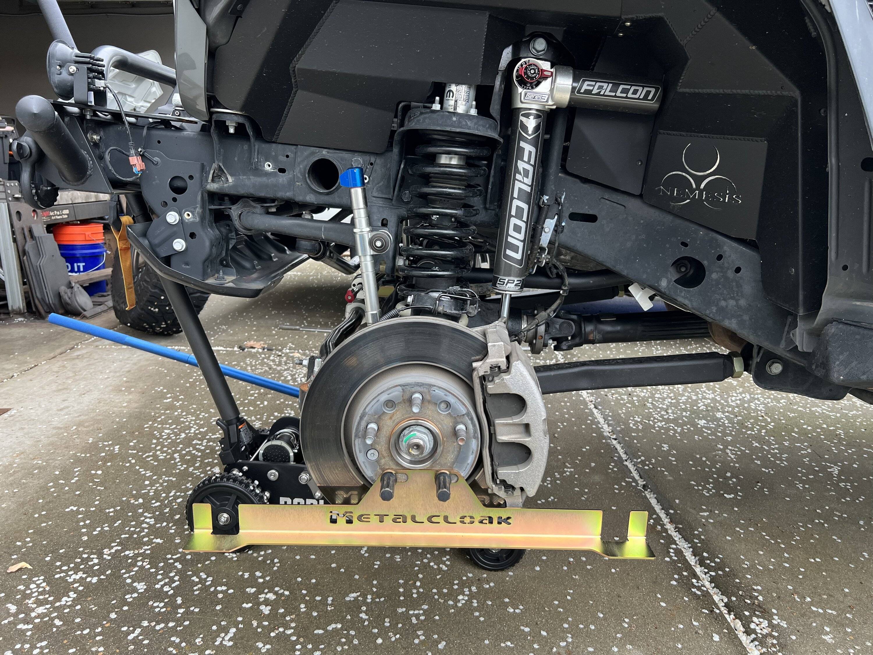

I pieced together my Clayton kit. Did you get adjustable track bars front and rear? I didn’t pay a shop to do my alignment but my steering was sensitive too at first. I forgot to recheck and center axles, went from AEV spacers to current pieced kit. Had to adjust track bars a bit. And my toe was dead even, now just under 1/8” toe in. And drives great!
My brother inlaw also has a gladiator on teraflex 1.5” spacers and 35s. He drove mine on 37s and he said it feels like driving a car compared to his.
Yes front and rear track bars included with kit.
What is that metalcloack bracket called? Does it check toe and caster?
Awesome. Thanks for the tip.
