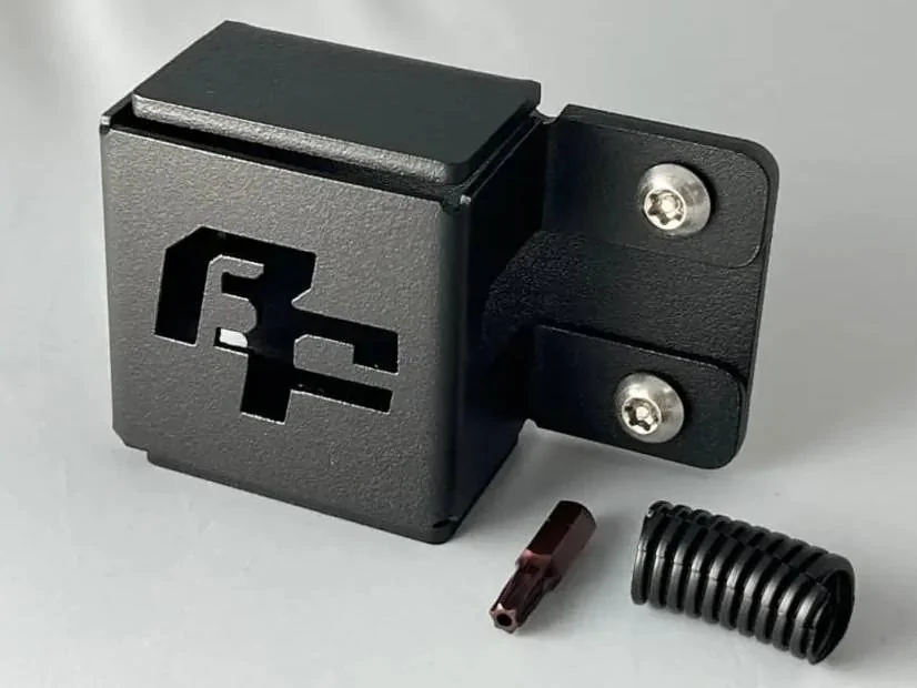

Nice find.
I'll have to look under the dash to see how and where you mount this.
There's some chatter about it on the JL WRANGLER forum.
40,514
54,044
https://brawlerfab.com/product/tazer-shield/
Here's an option to protect a Tazer install for the pin code lock out.
Slow 'em down is all you or it can do, which if they are looking for a quick job and profit, that may be enough.
But frankly, with access to the area back of the glove box.......... they'll have their break-out boxes to plug in there to give them access to anything.
So you'd need to stack up various things to frustrate them to the point of giving up.
You'd be amazed what can be done with simple tools any thief may carry, including a big screwdriver to pry open things.
There's no detail on where that mounts but you'd have to put it up in a deep recess that you can't just take a bar and bend it open. Maybe they do that............
