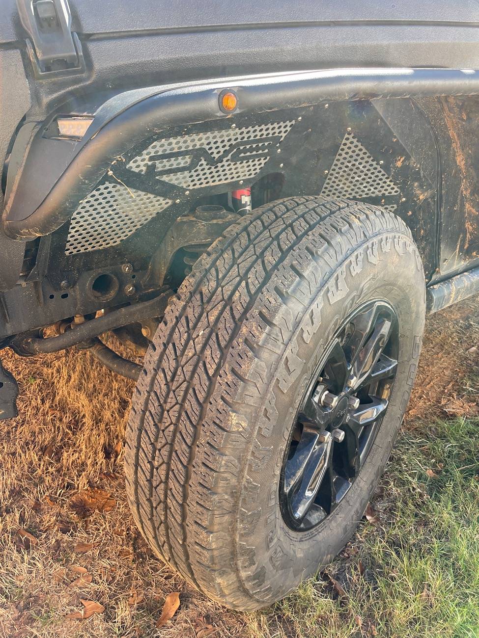

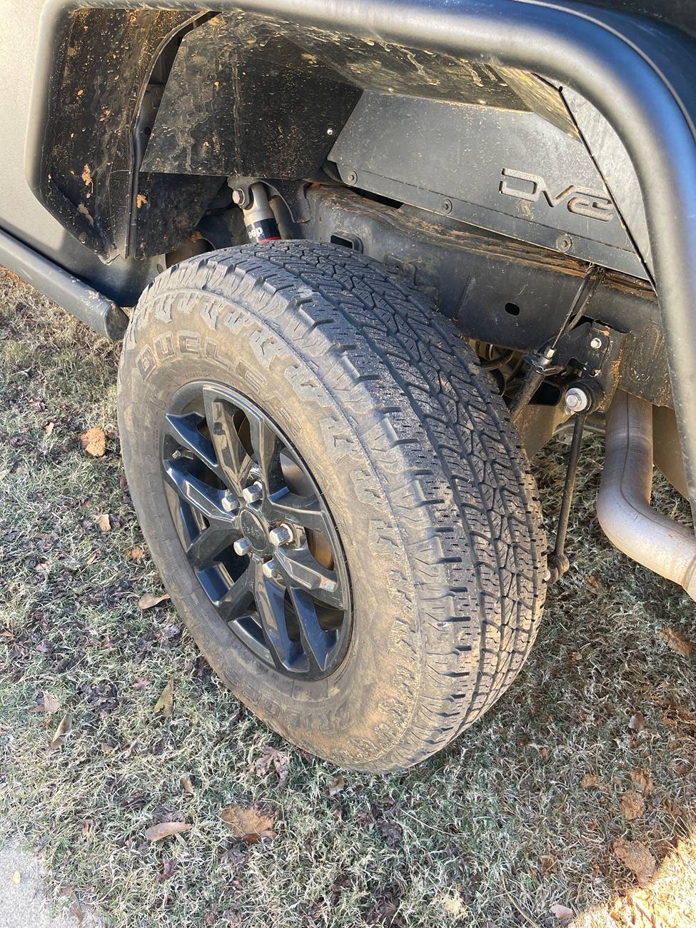

Hey everyone… I’ve got a 23 Gladiator (Freedom trim). It’s had some mods (DV8 fender well guards, Fox shocks, Barricade tube-style fender flares), but no lift.
I want to put 33/12.50r17s on it, but I’m concerned that without a lift, I might have problems. I don’t think tire diameter will be an issue, but I’m worried about the width.
Has anyone run 33/12.50r17s on the gladiator (Freedom/Sport) without a lift? Good idea, bad idea?
couple photos attached. Current tire size is 245/75r17.
Jeep Gladiator 2023 Gladiator Freedom with 33’s? image

Don't have links to post but based on my reading on here something will rub with the 12.50s. You can run 11.50s all day and be fine though.

need more offset to run 12.5s, but 33s are no problem

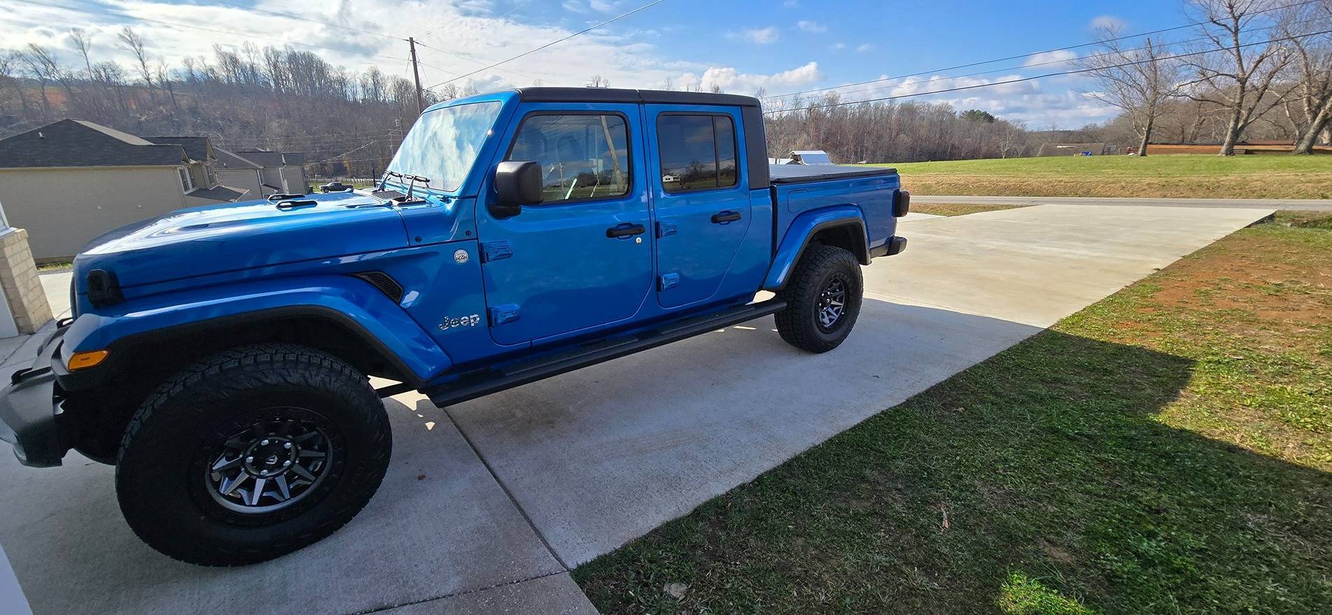

I believe the 12.5" will rub the front bumper on full lock. I went with 285/70-17 and have no issues
Jeep Gladiator 2023 Gladiator Freedom with 33’s? 20241221_110552
Looks sharp. Seems like you’ve got some offset on your rims… think the 11.5 width would be a problem on mine (I think mine are zero offset)
unsocbl
James
Aug 8, 2020
439
861
Charlotte TN
2021 Gladiator Willys Eco-diesel
They do have an offset but ran the same tires on the factory wheels before the Fuel wheels came in...no issues
Yours look like OEM non-mojave wheels, which would make them +45.45 offset.
If you got 0 offset wheels, you'd clear 12.5s easily
Thanks for the info. I still don’t have good grasp on the offset situation. 😂

If you want to keep the wheels you have, adding a quality 1.75" hubcentric spacer would put you at a 0 offset. 1.75" in mm is: 45.45mm. Subtract the spacers width from your OEM offset (+45.45) and you end up at 0 offset
