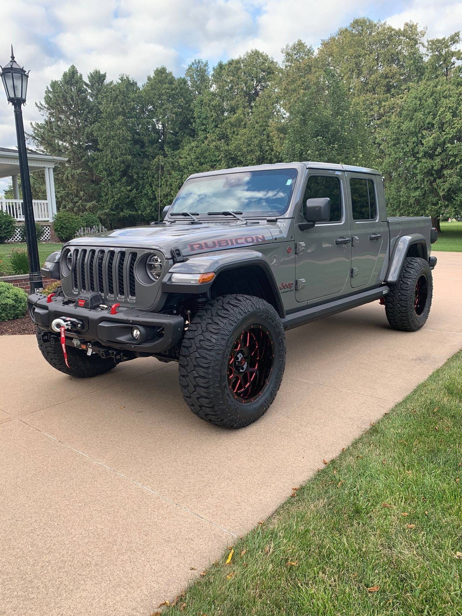

Not exactly same dimensions, but something to use as a comparison.
3 1/2" MetalCloak lift, 37's

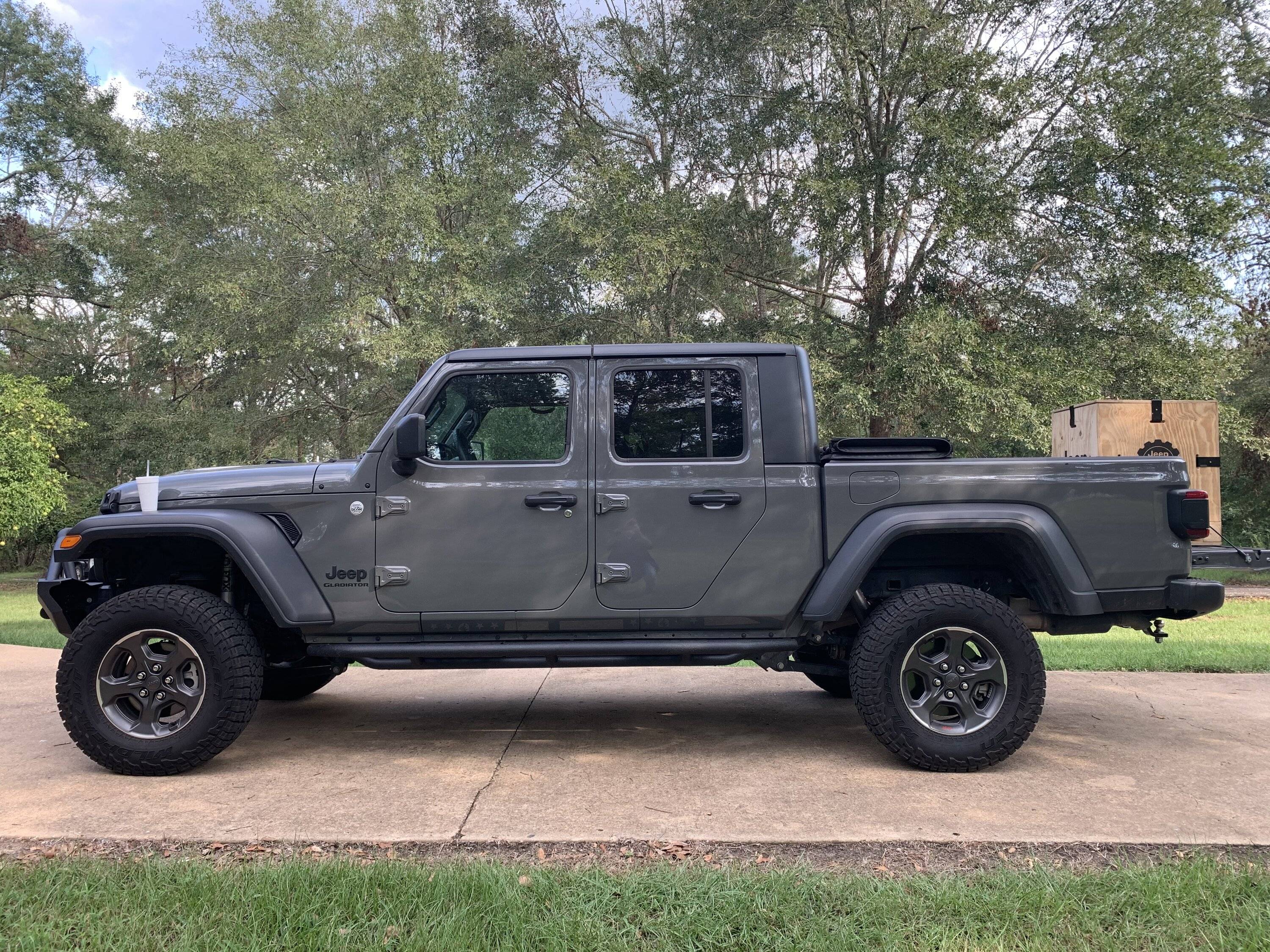

Here is an S with a Mopar and 33’s just for another reference. Ended up with 35’s and regeared with 4.56.
3yrs later i traded it in for a JTR put a 1” teraflex spacer in the front and left it stock otherwise… done, LOL.

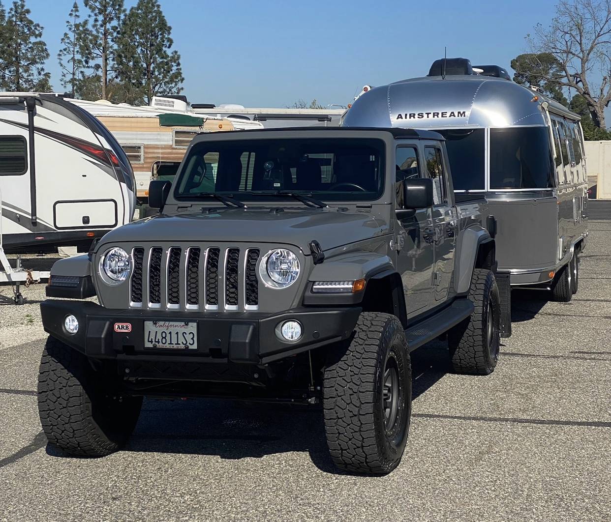

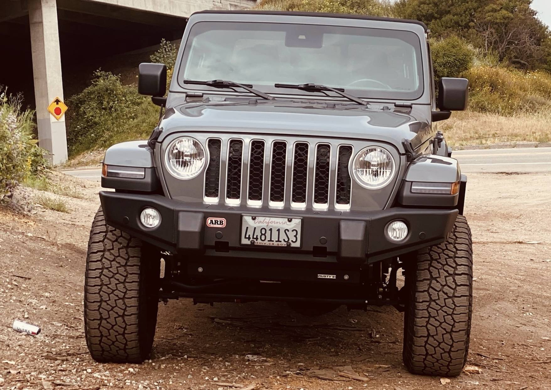

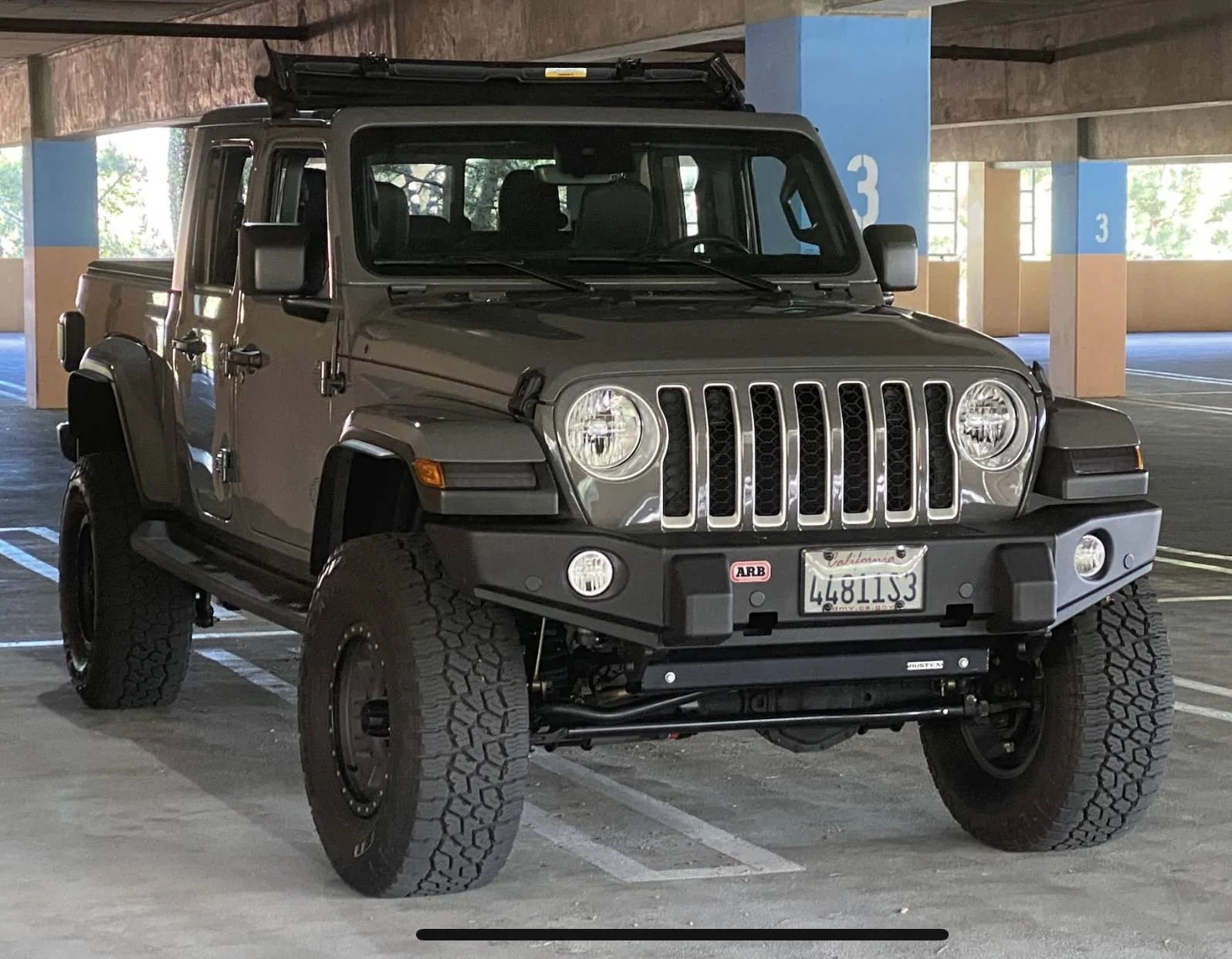

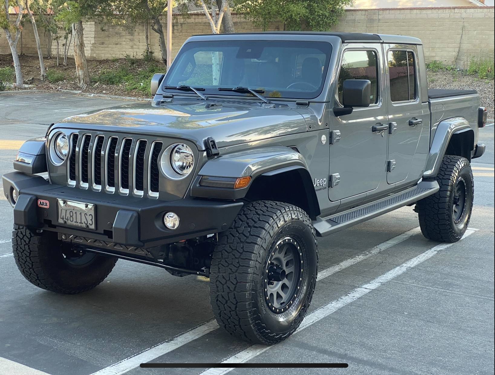

3.5 metal cloak with AEV high capacity springs/fox 3.5 adjustable remote reservoir shocks on 35” Falken Wildpeak tires.
works great so long as it has weight in the back.
we typically carry a lot onboard and tow frequently…. however, the ride is terrible if it is unloaded — these springs are hard as dirt.
