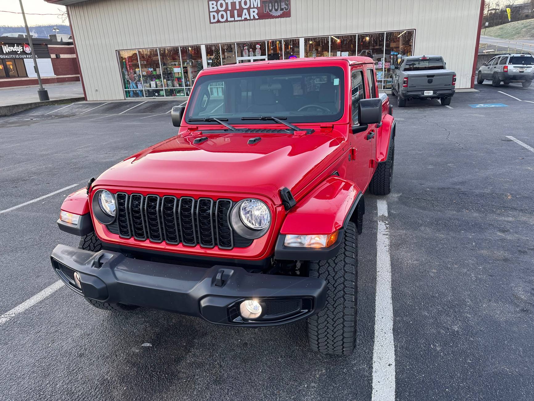

Looking to do a Mojave hood swap to my 24 Jeep Night Hawk. Anyone got one for sale. Looking to trade. Heard some folks also swap from Mojave to Sport etc. mines brand new red. Ideas. Best place to buy. Etc. all help appreciated

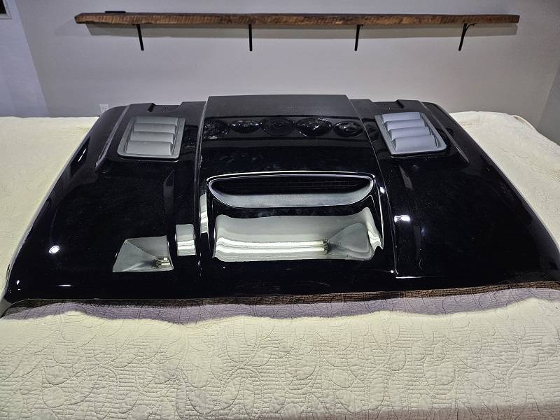

https://www.cervinis.com/2019-21-gladiator-stalker.html
Ordered mine in Sept, it arrived a week or two ago painted to match. I've got it in the basement on the pool table so I could install the scoop and heat reduction vents with 3m tape in a warm room so it would stick. Will probably install on the truck this weekend. It's fiberglass but has the Mojave scoop AND the Rubicon vents.
