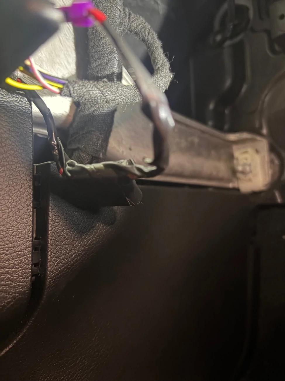

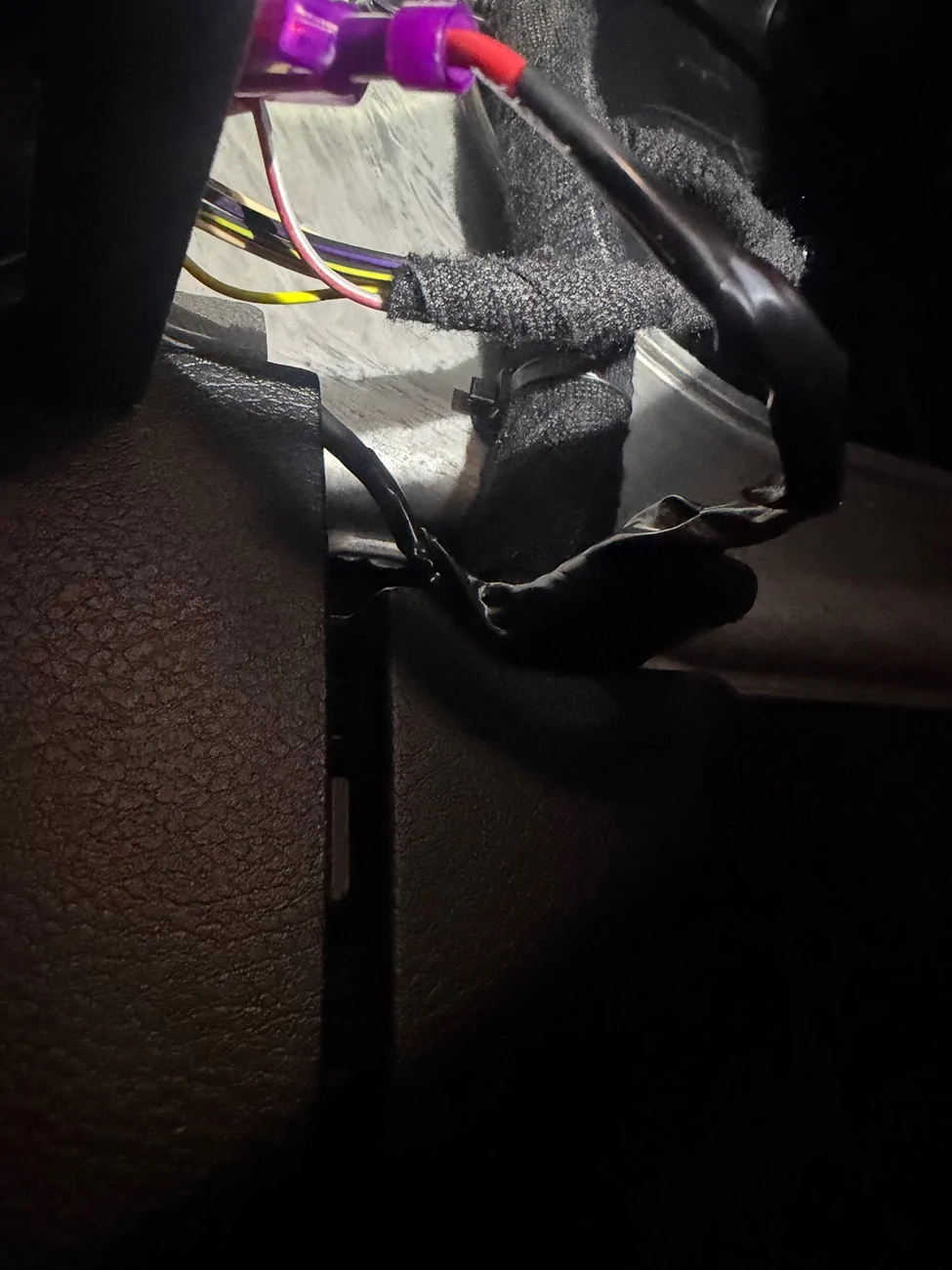

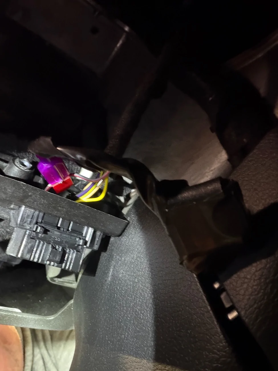

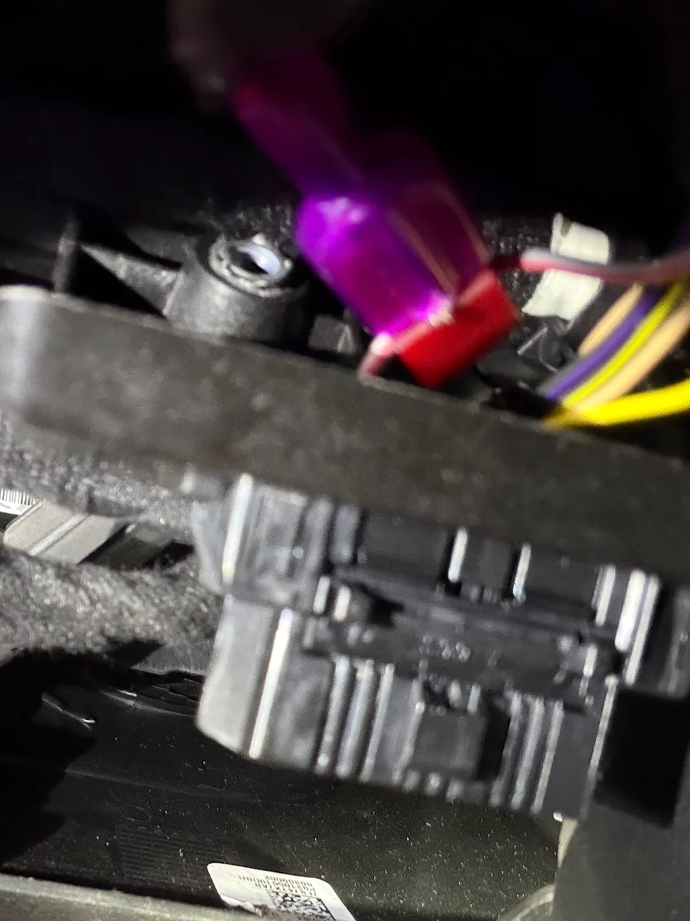

So I finally took my Gladiator in because of some other issues with the front suspension and was going to have them look into this siren noise. I’ve had other people and dealerships tell me it’s the SWAT alarm. It’s only occurs when I’m out of San Diego. They wanted to keep the jeep for 3 days to diagnose. Ridiculous. I got under the dash and snapped a few pics below. There is a wire with a pink connector tied into one single wire on the back of the diagnostic port. It goes into a fuse that’s electrical taped up and tucked behind the side kick panel. Do you guys think this is the GPS(SWAT) system? It looks to be not factory and added in.
