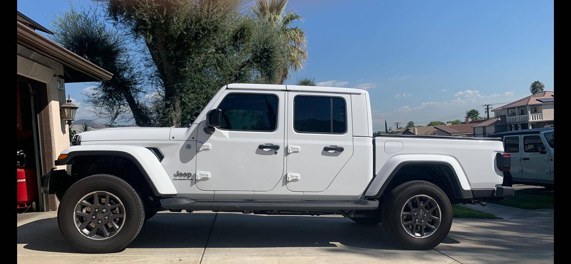

My overland was a little nose high with a 2.5” spacer
Jeep Gladiator 21 Willys Lift True Level Pictures IMG_2552

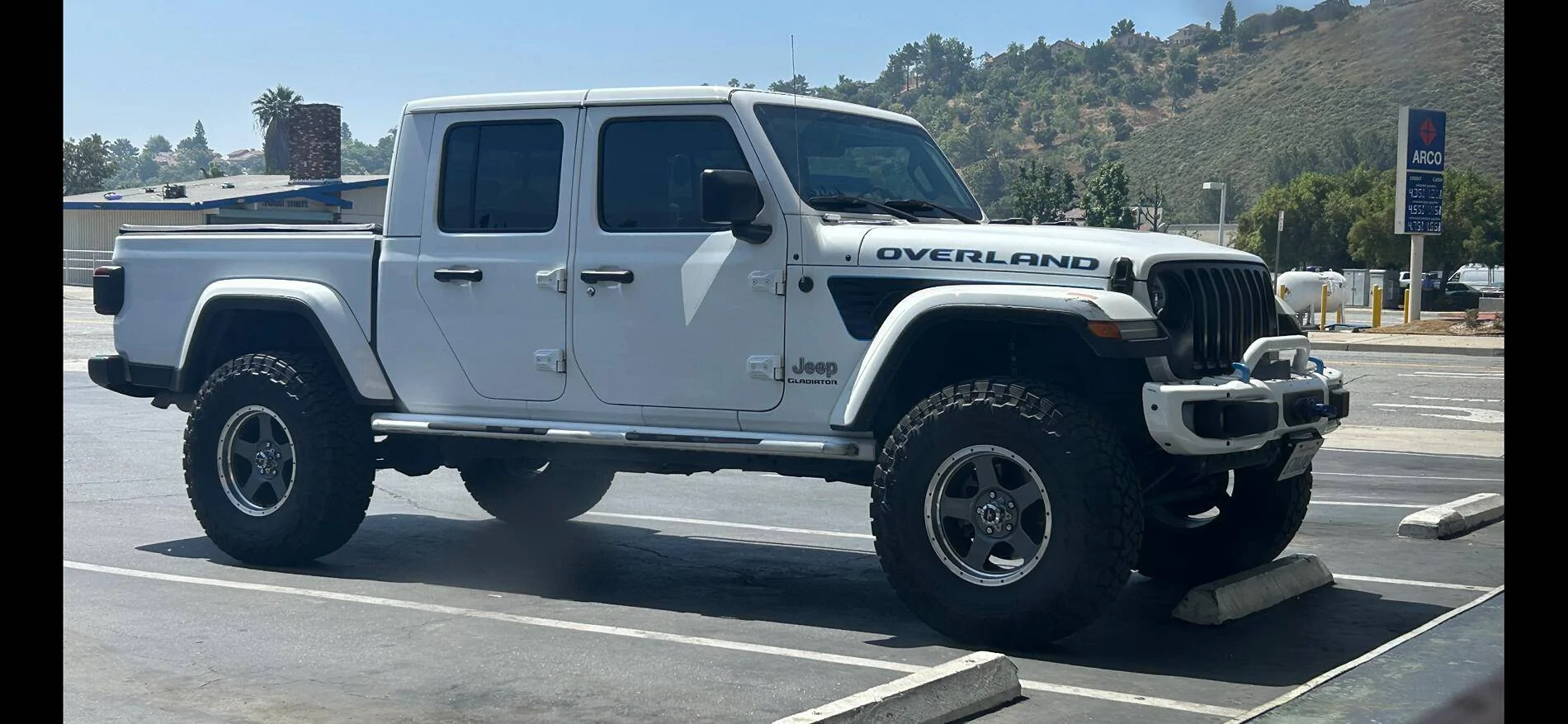

now I’m at 4.5” front and 3” rear and it’s level
Jeep Gladiator 21 Willys Lift True Level Pictures IMG_6970
measure your rake front to rear and buy a spacer kit based on that. No set of springs is going to be exactly what they say they are, but a 2” spacer is 2” all day. Make sure you consider future modifications like bumpers and winch, those will drag it down too.

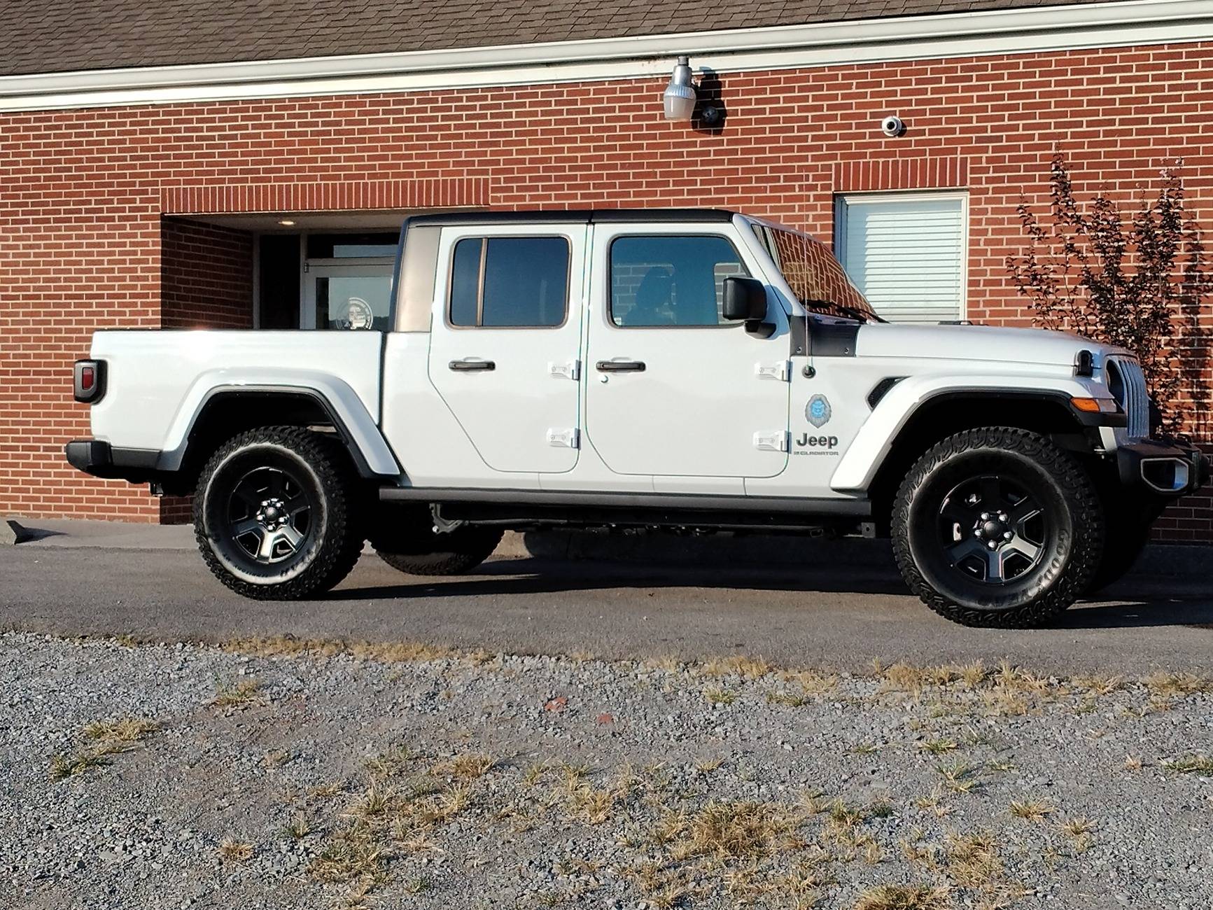

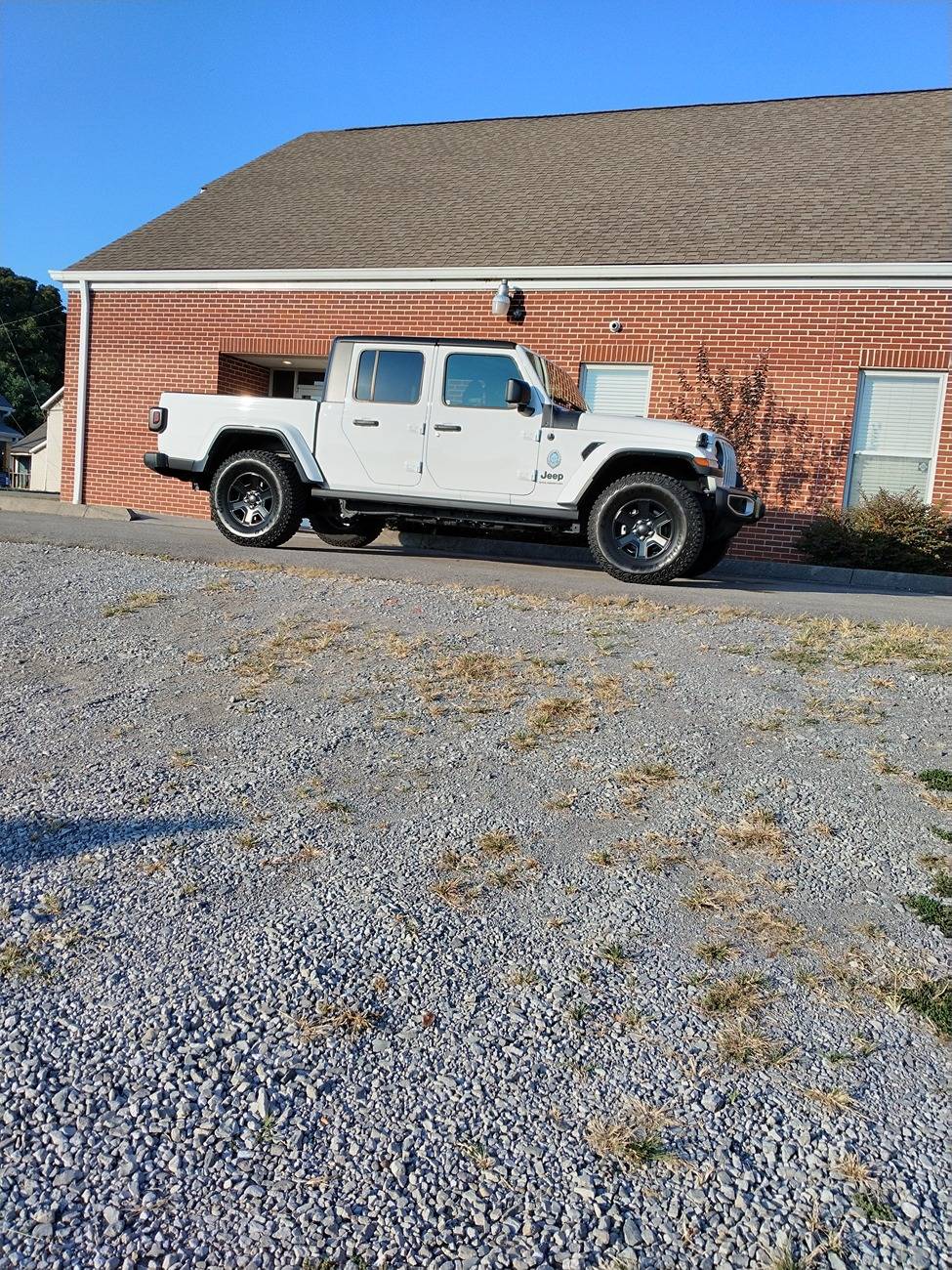

I used Terraflex 1.5 spacers. It is a Max Tow though. Rake is 1/2 with half tank. Tires are 315/70r17....34.4
Jeep Gladiator 21 Willys Lift True Level Pictures IMG_20240922_084302
Jeep Gladiator 21 Willys Lift True Level Pictures IMG_20240922_084338
Jeep Gladiator 21 Willys Lift True Level Pictures IMG_20240920_162810
