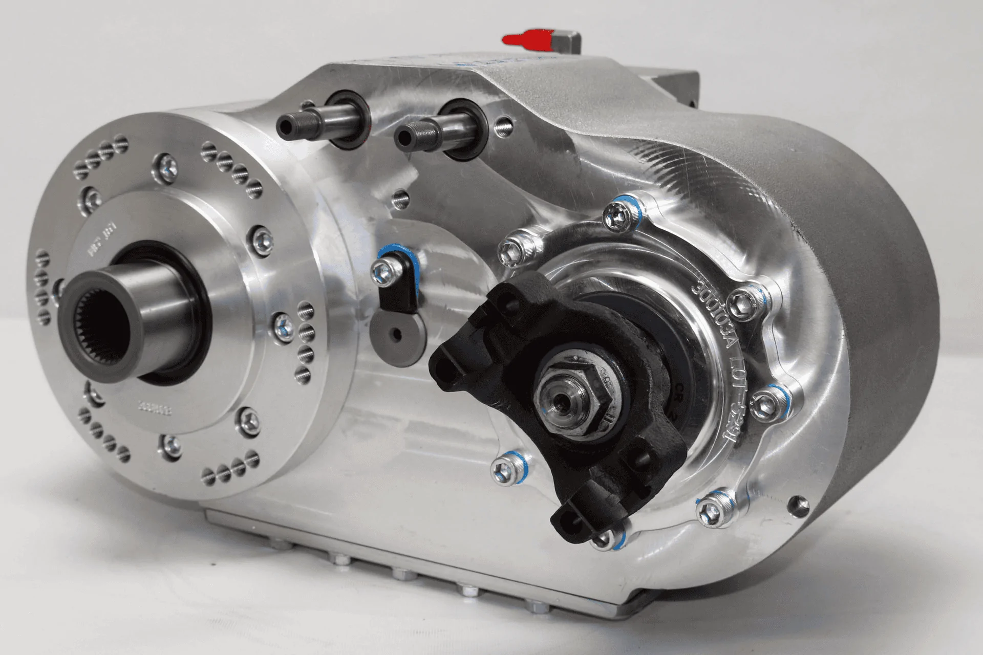

Atlas 2sp twin stick T-case is out there for us now, I believe.
Check out advance adapters
https://www.advanceadapters.com/atlas-transfer-case-jeep-jl-2sp-builder

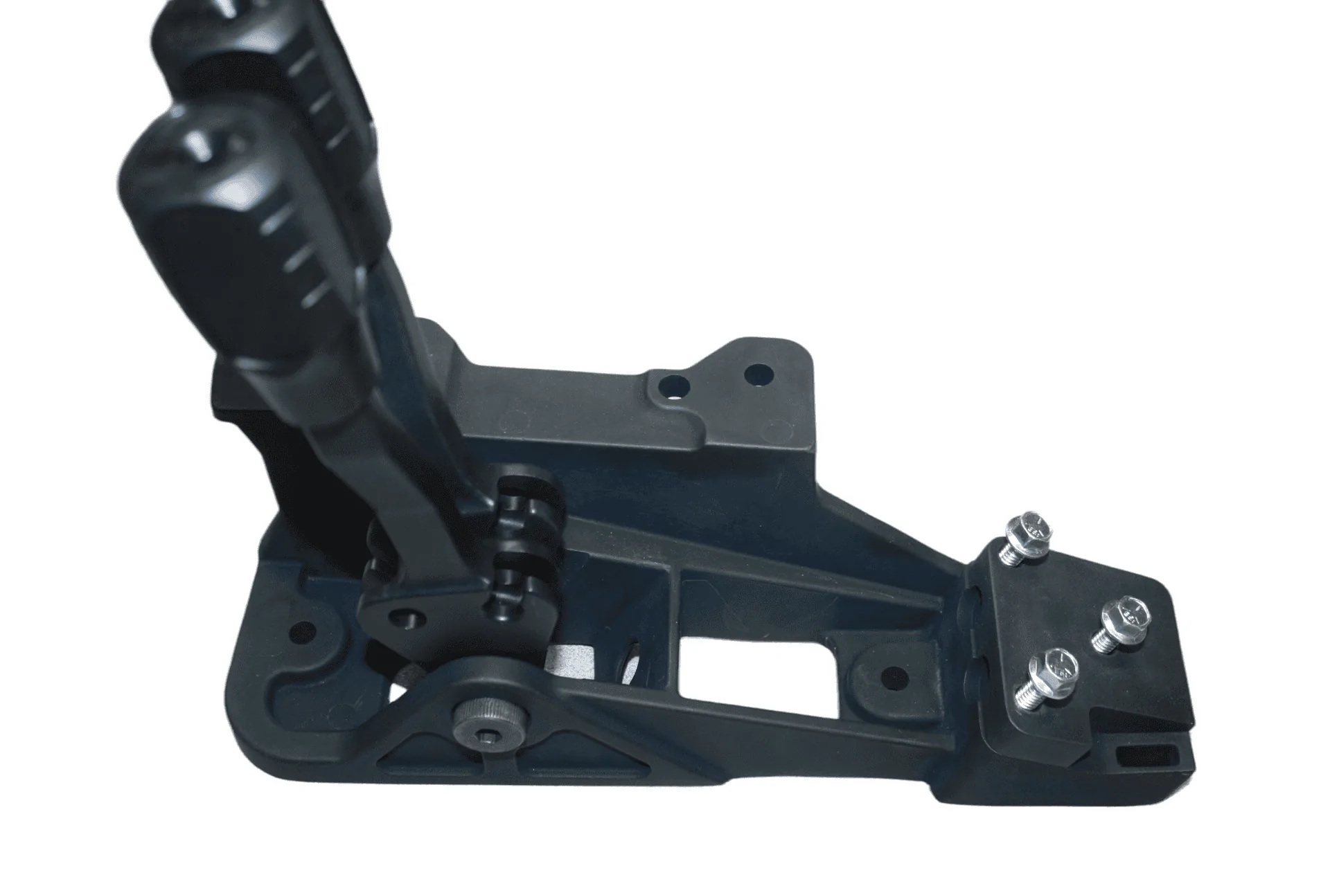

JL/JT shifter
https://www.advanceadapters.com/jl-jt-cable-shifter-assy-atlas-2sp
Im afraid this might be the only option. Its not really a way I want to go. Hoping theres just some type of 2lo kit like how teraflex has for my TJ
