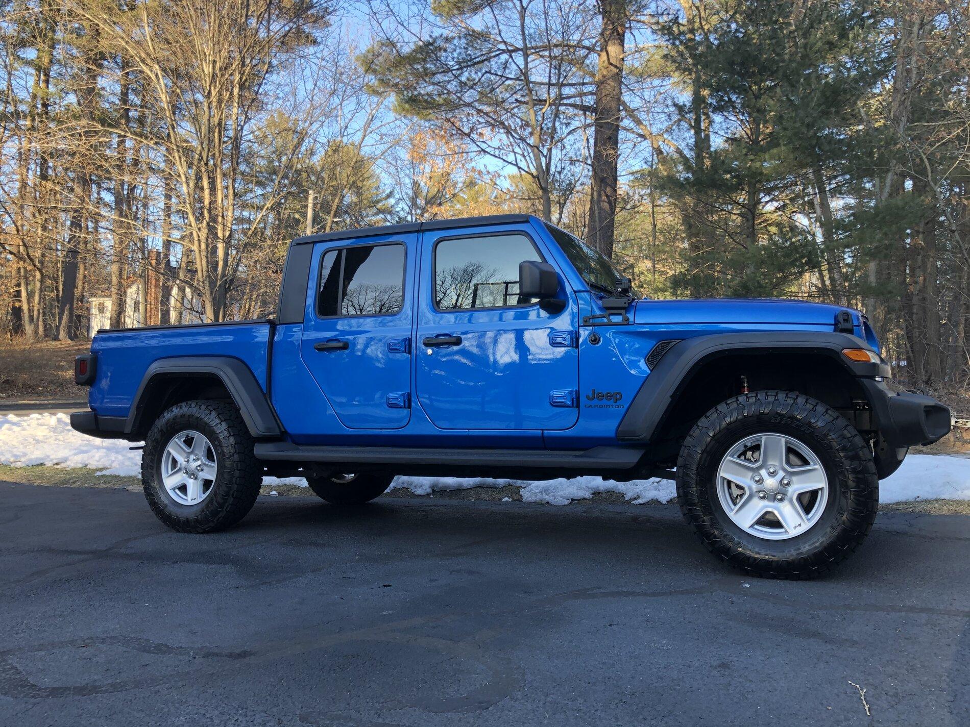

I put a set of Rubicon take off springs on the front, 340 and 343 as well as the shocks F and R, springs raised the front a little over 1”, I added Daystar 1.5” front and .75” rear spacers, Mopar LCAs, Daystar lower spring correction pads, and Rubicon Express shock extensions. I am running 285/75/17s, it is a good setup for my use, just waiting for my Fox TS steering stabilizer to come in then I will be done.

Looks good! I am hoping for s little lift out of the rubicon springs and shocks. I think I'm going with a 1 inch spacer in the front so I keep a bit of rake, thanks for the pic.

Did you order the long control arms from the 2 inch lift kit?
