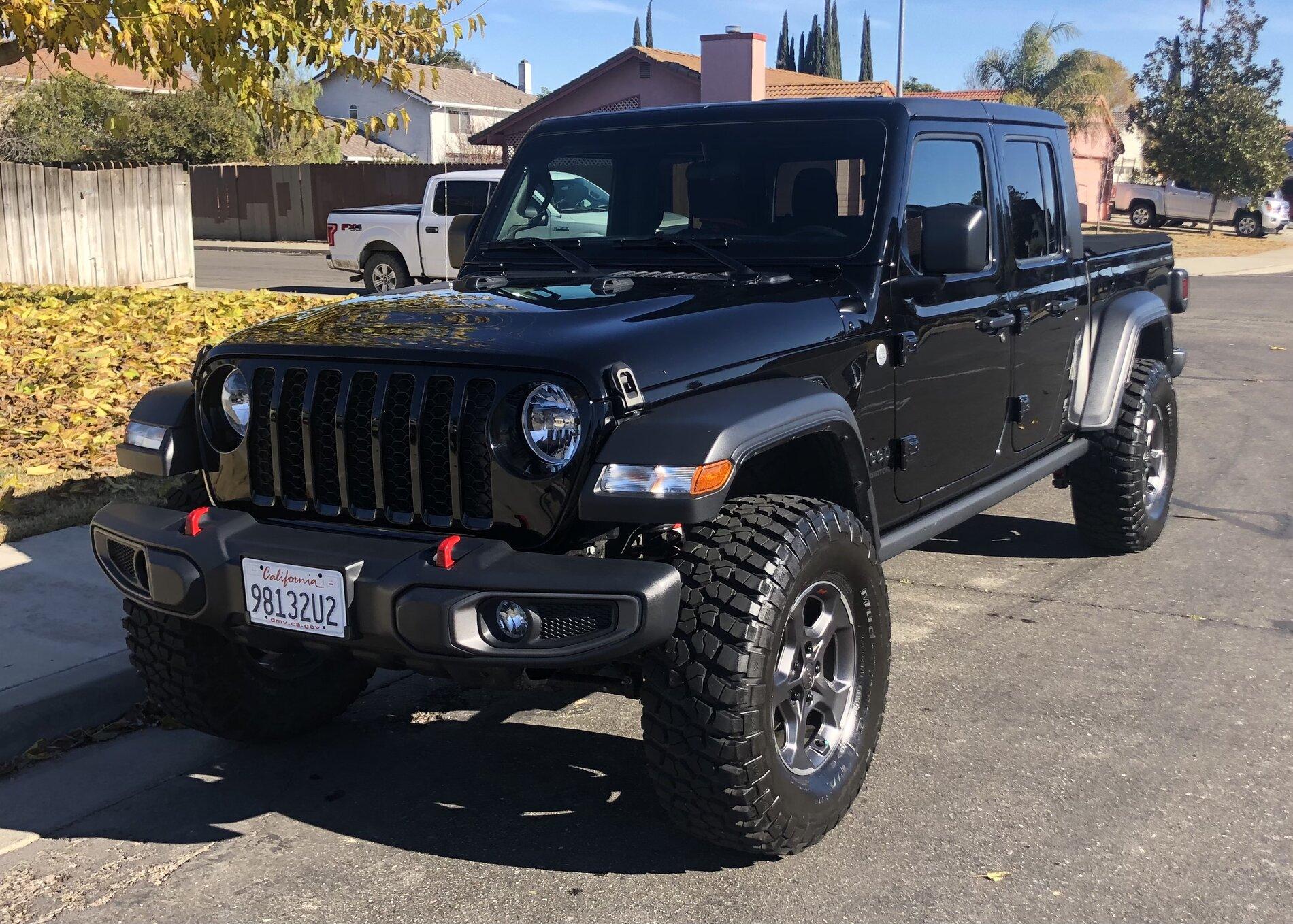

Very happy with 1.5” above a rubicon front coil (2” above stock max tow) and a 3/4” in the rear, retaining the stock max tow rear coils. This is however with rubicon fox shocks.
Jeep Gladiator 2021 sport s max tow with 2" mopar lift - looking for recomendations for 3/4"  or 1" level spacer 791E2471-8FD4-4051-BEE4-5C61C1FD0904
