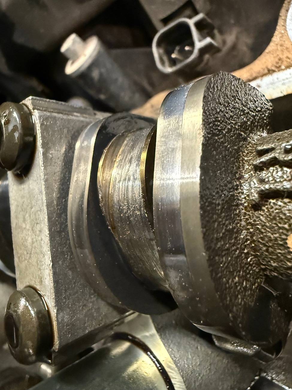

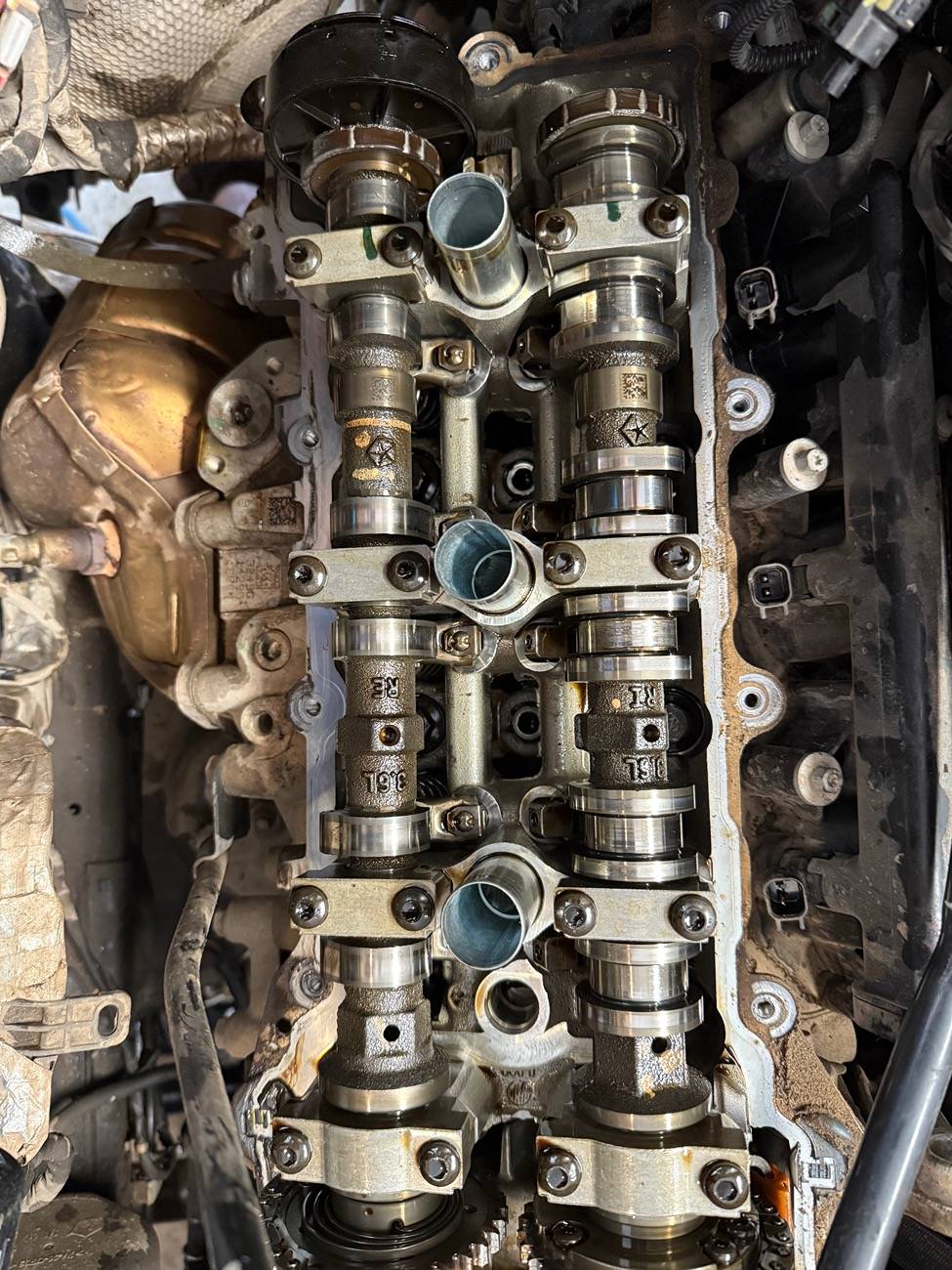

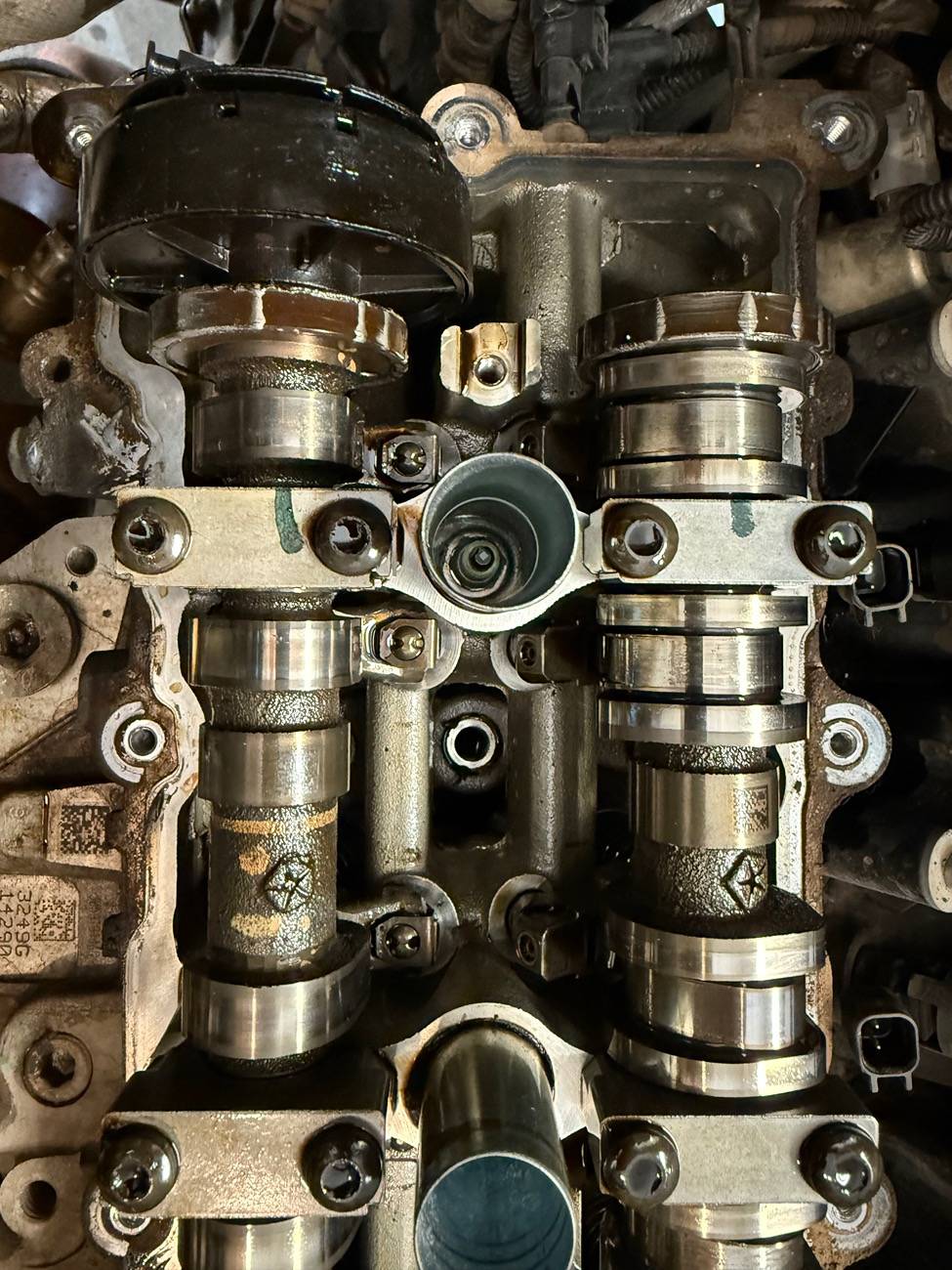

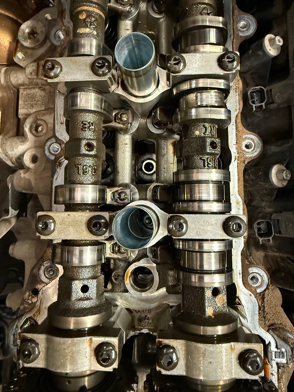

I bought the parts expecting to need to swap camshafts. Now it’s torn apart and doesn’t look that bad. Passenger side.

Looks like the #3 cylinder cam lobes but had #1 misfire codes reporting. I am betting the shavings stuck to the cam reluctor wheel marks messed up the computer to think it was the #1 when it should have been the #3 reporting the misfire.
I’ll take a better pic but there were 3-4 lobes worn down.
