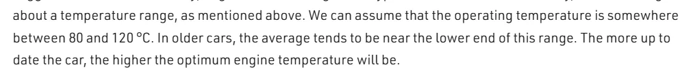

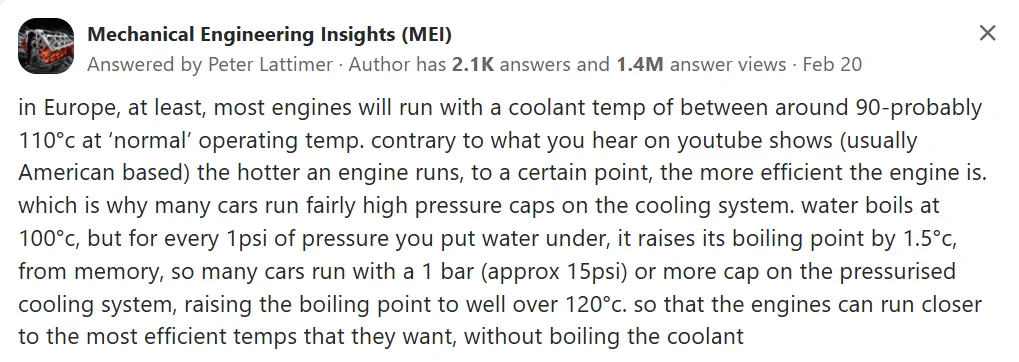

110C is 230 F - 110 at normal operating temp as shown below.
It wasn't unusual years ago, it's normal today. But people freak out over it. The heat is for efficiency (power) and emissions..
The block is die cast. It's a lot better than before.

You seemed to suggest that 270 was acceptable. 250 isn't even acceptable. 230 is riding the line of acceptable, as even in your screenshot it's the "peak" of what MEI suggested operating temp. Both of my 3.6 motors in the wrangler would run the temp up as high as you let it.. well beyond 230.
A properly made iron block is significantly stronger and more durable than even modern aluminum blocks because, even "modern" aluminum suffers from still being... aluminum. it's not even debatable. The switch to aluminum was for weight and economy reason, increasing those MPGs and reducing emissions when emissions standards were being set in the late 80's-90's. lol

No, I said that with coolant and cap, you didn't need to even consider anything boiling until well over 270, closer to 300 for these with the 21 psi cap. So there's no risk of boiling - which some seem to really be concerned about.
230 isn't riding any line of acceptable - not at all.
These are talking about modern aluminum engines -

120 C is what, about 240F? So, it's not a disaster to be running 230-235. The issue isn't because "these run too hot" because they don't.
It brake, that's bad, a disaster for the person it happens to - but it's not a design or heat issue.
