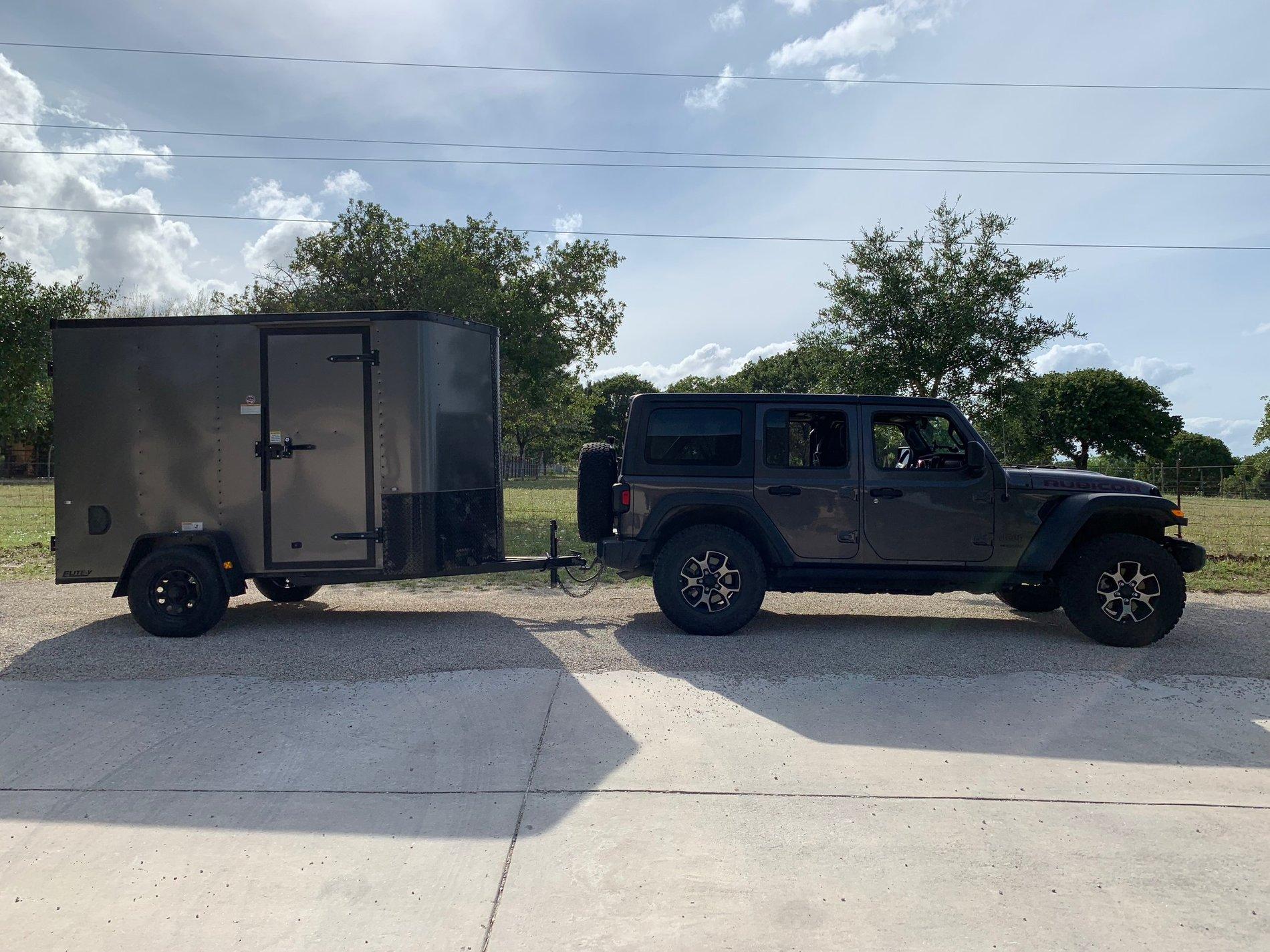

I've owned a 3.8L JKUR, a 3.6 JKUR, and now a 3.6 JLUR - and I gotta say, I don't find it slow at all when you compare it to other small trucks or other SUVs that aren't tuned for speed. I am running the 4.10 gears in mine, so it has lots of pep - so much that I've caused the rear tires to chirp on take off many times.
I towed a fully loaded 5x8 Uhaul (only about 5ft tall interior) from Seattle, WA to San Antonio, TX over 3 days and my 2014 JKUR with the 3.6 and 4.10 gearing towed fantastically - not a single issue that entire trip, including through mountain passes.
I now regularly tow a 6x10 trailer with about 3,000lbs of gear in it for my band without trailer brakes or weight distribution hitch using my 2018 JLUR. At first, I was totally upset with how it towed - completely different experience from my 2014 JKUR. I thought I had the gear loaded properly in the trailer at first until I bought a trailer tongue scale and found that I was grossly overweight on the tongue. After moving my gear around, I was able to get the tongue weight down to about 350lbs and it tows fantastic - up hills and all. This band trailer is single axle, no brakes, and 6.6ft interior - it's a very tall trailer.
I have zero qualms about towing with my JL, and I know the Gladiator will be just fine as well. If you're unsure about your tongue weight, spend the ~$125 and get a nice tongue scale off Amazon. I'm so glad I did, no regrets on that purchase at all!
