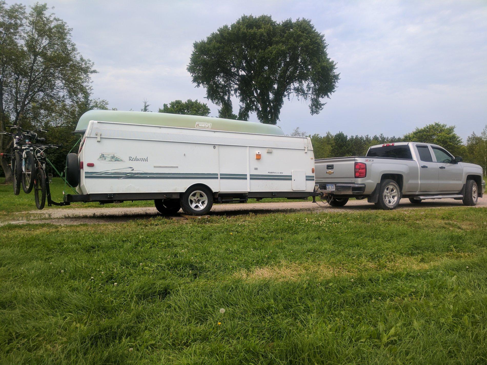

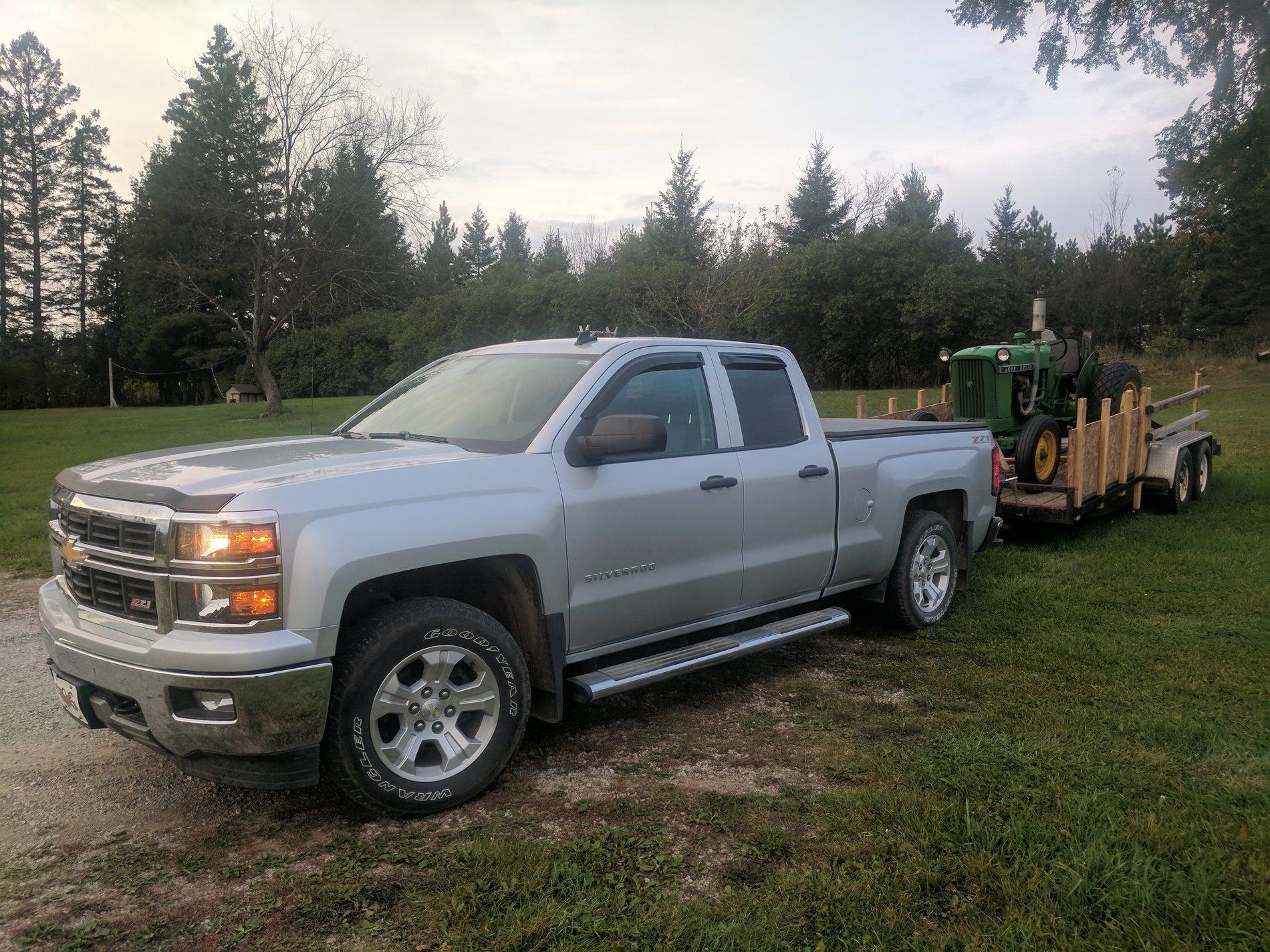

On paper compared to my 2014 Silverado with the 4.3 v6 makes 285hp and 305 ftlb of torque and weighing in at approximately 5140 lbs curb weight. In the other corner the Gladiator specs at 4650 at base trim. Im ordering a sport S with manual so this comparison is fine for me. Both trucks have 3.73 gearing. I don't anticipate any issue.
Math shows about 18lbs/hp and about 16.9lbs/ftlb of torque for the Silverado. I tow a exceptionally heavy pop-up camper that has a Max GVRW 3800lbs then load up the truck with firewood and coolers toss bikes and a canoe on the camper. Fairly certain the camper is over weight. Never any issue compared to hauling with the v8 avalanche before. Also no issue pulling a John Deere 1010 about 4000lbs plus trailer.
The gladiator looks to be fairly comparable with 16.3lbs/hp and 17.5lbs/ftlb. Noting lower numbers are better so it does lack some torque but with the low first gear it should be able to get moving pretty well.
Aside from pulling the camper a couple times a year I don't feel like I would have a problem. Also note that I have not driven a gladiator as of yet so I can make hypothesis based on research and past experience.
