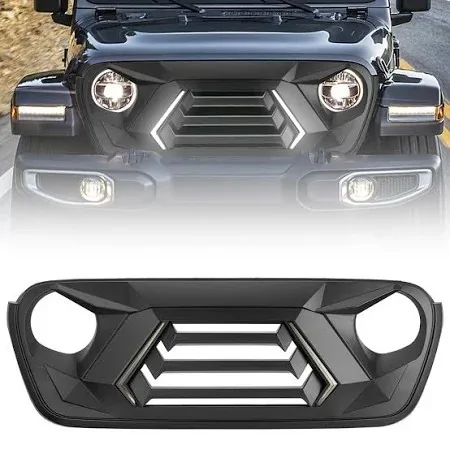

I’ve never heard of a systemic cooling issue with the 3.6, even after an internet search. Must be something unique to your setup…
"Whys is my Jeep suddenly running hot?"
lmao that's pretty good.
I have a factory grille though and kept the engine stock for reliability and ease of repairs.
