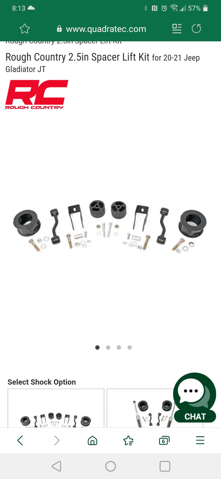

Yep. I did this Rough Country 2.5" leveling kit. Overall I am happy with the quality of it, and the ease of install.
