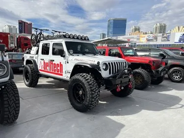

Not mine but he is a forum member. He's at the 2021 SEMA show. Curries with 40s
Jeep Gladiator Dana 60s for 40 inch tires questions 195088-5804d8cffd509f61c17f44cd610be75f
