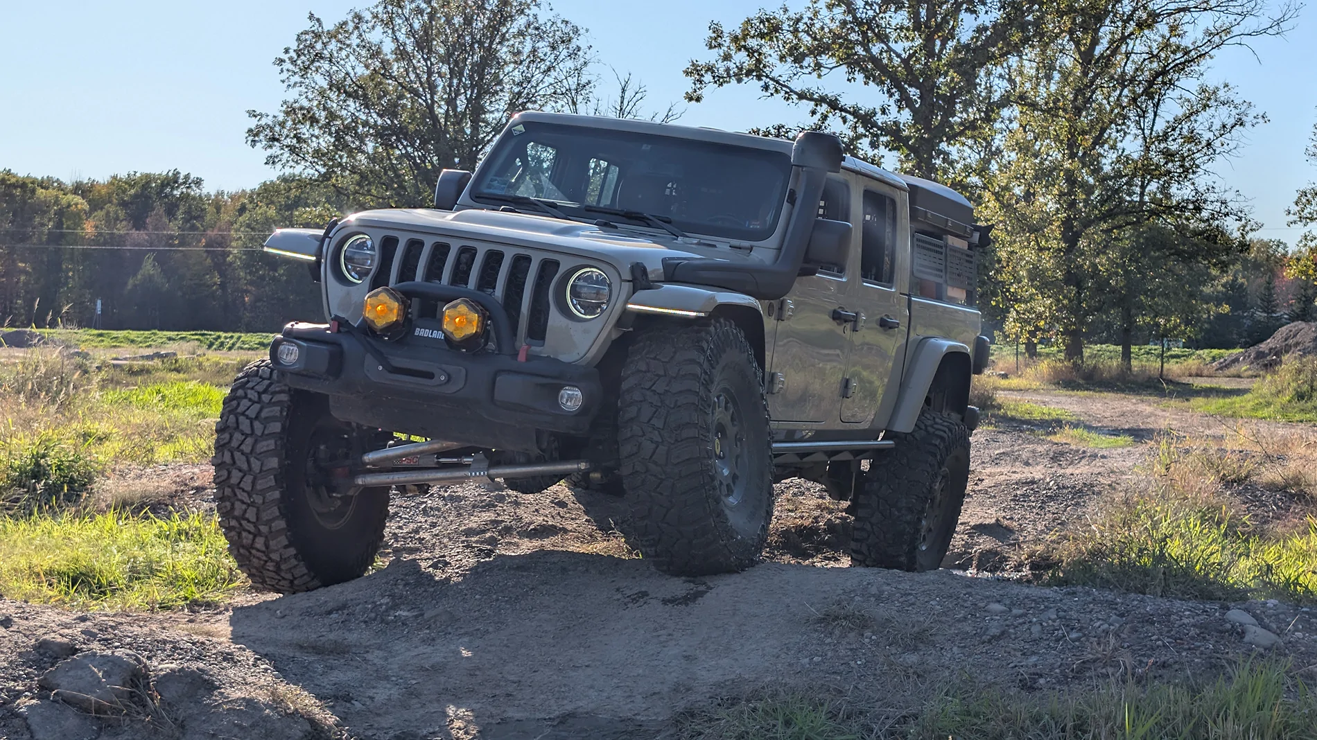

I've been running 40s for a year now, hydro-assist is a necessary upgrade in addition to the obvious axle shafts etc imo
And also I think 40s don't fit. 39s maybe. 40s get into structure without excessive bump-stopping
