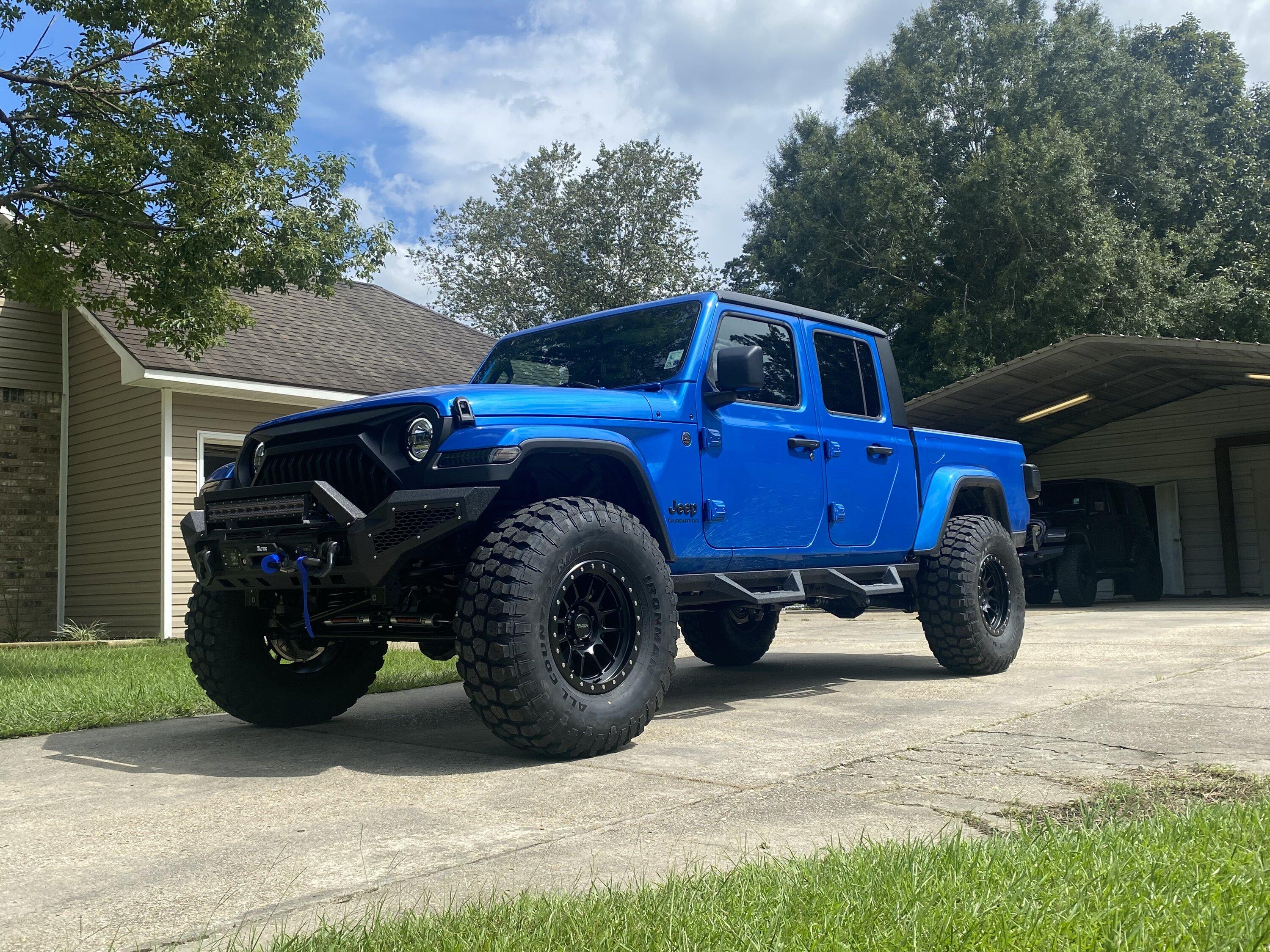

Good looking setup.
What lift do you have?

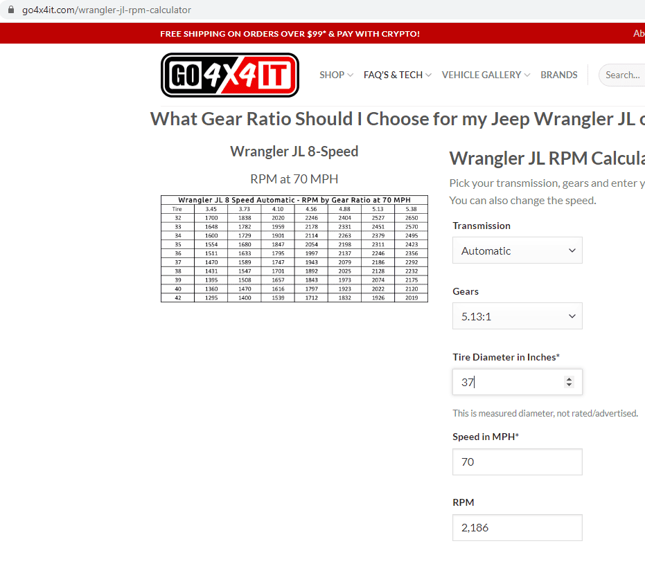

Go with the 5.13's, unless you drive like a pissed off 16 year old and routinely do 90+ on the interstate... The extra weight of the tires and even less aerodynamic leads to the deeper gears. Plus this engine likes to rev up, Peak torque is right around 2300
I see my Jeep as a brick, it doesn't do interstate well, and no amount of gearing/ect... is going to make it shaped less like a brick. I'm find doin 70 for the short interstate stretches I drive. Plus I do plan on towing with it.
