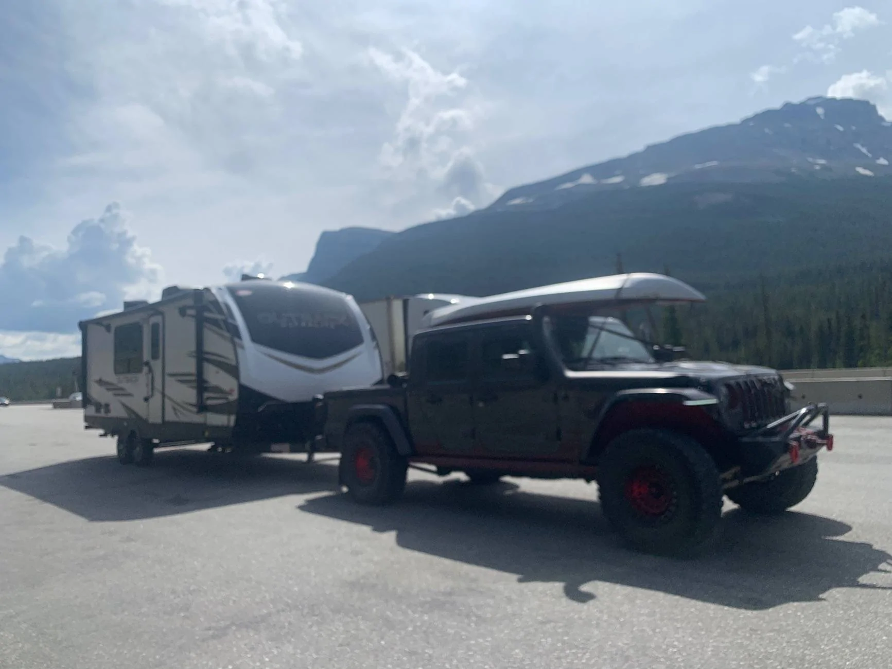

I was running 37’s on my old Gaser and went 5.13’s and towed my trailer weighing 5,200 dry and blew up my rear end on a trip to a family reunion, limping into the campground. If you’re towing, 4.88 would be the better choice. When I upgraded the gears, towing wasn’t something I’d thought much about.
This was caused by improper gear setup not the mechanical advantage

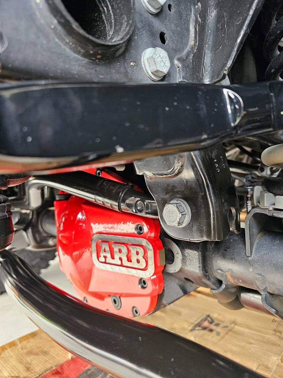

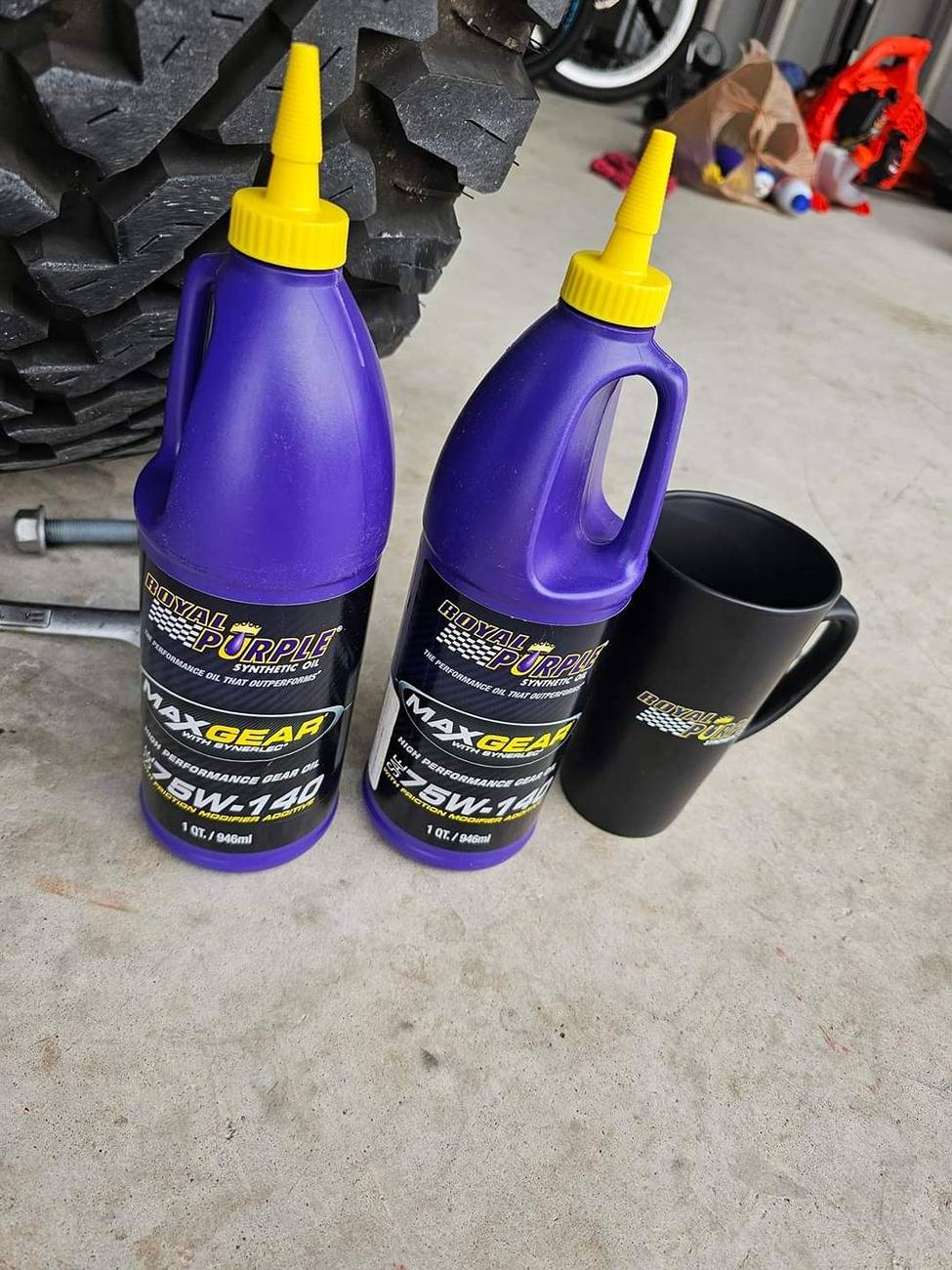

I just had Revolution 5.13's put in a few weeks ago. Going in tomorrow for my 500 mile diff oil change, and new diff covers.
Oil change is included in the regear price, and they are going to put on the new diff covers (Metalcloak) at the same time. Should take about an hour.
You won't be dissapointed.

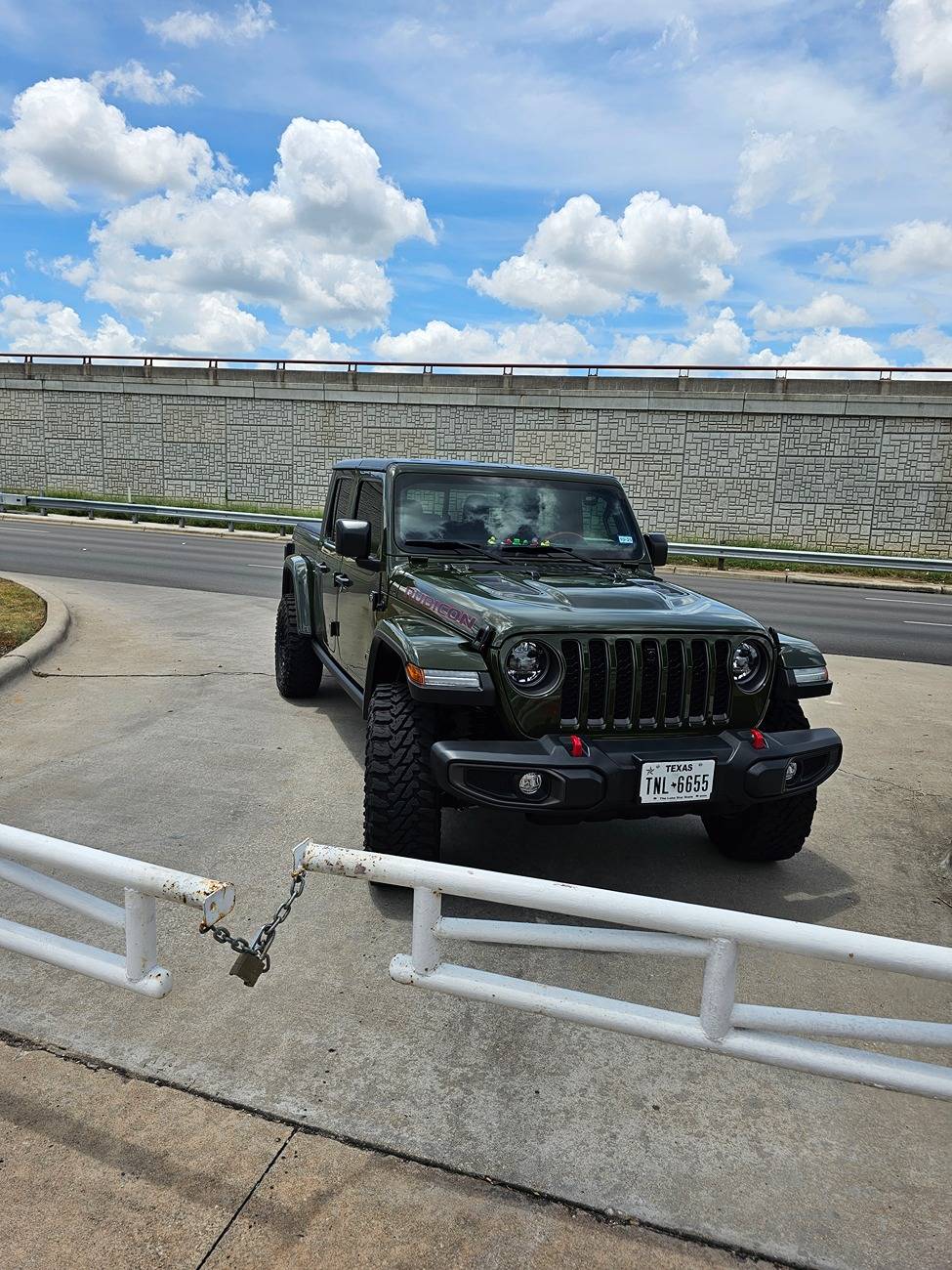

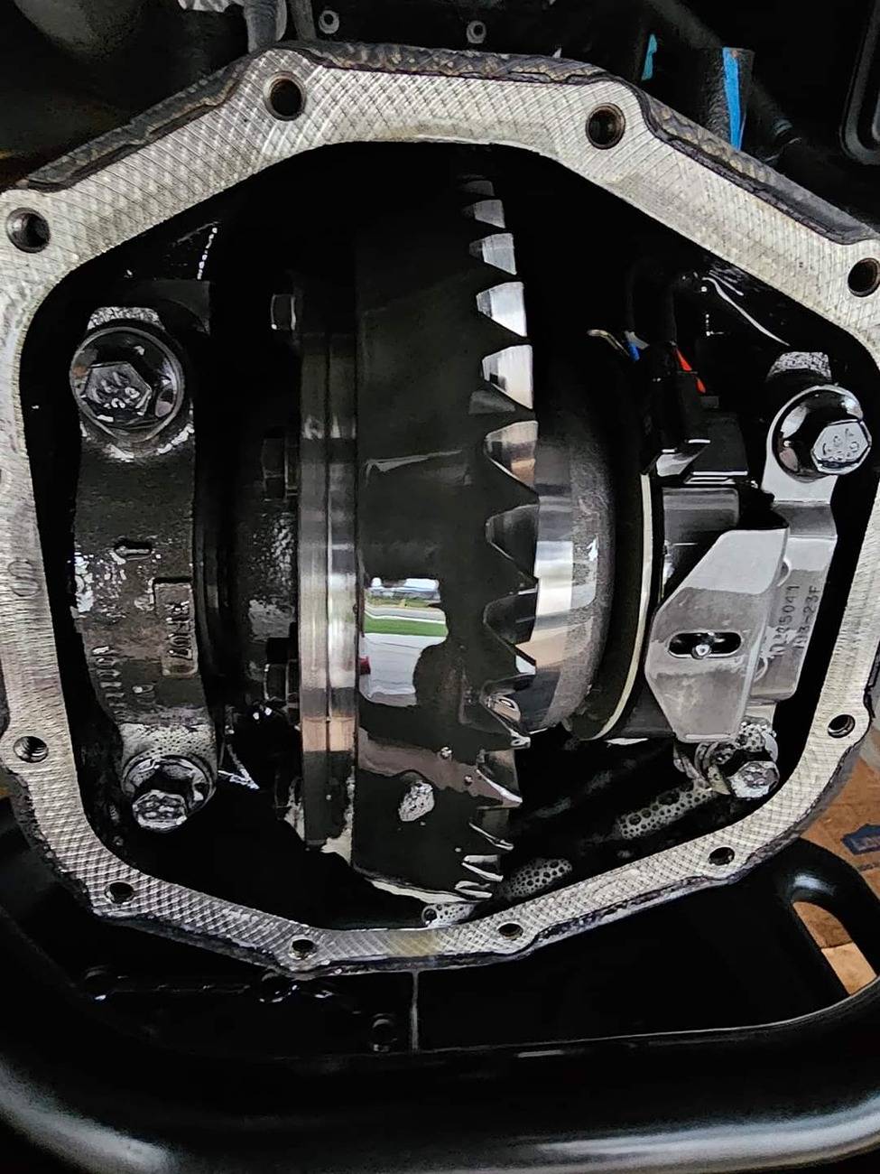

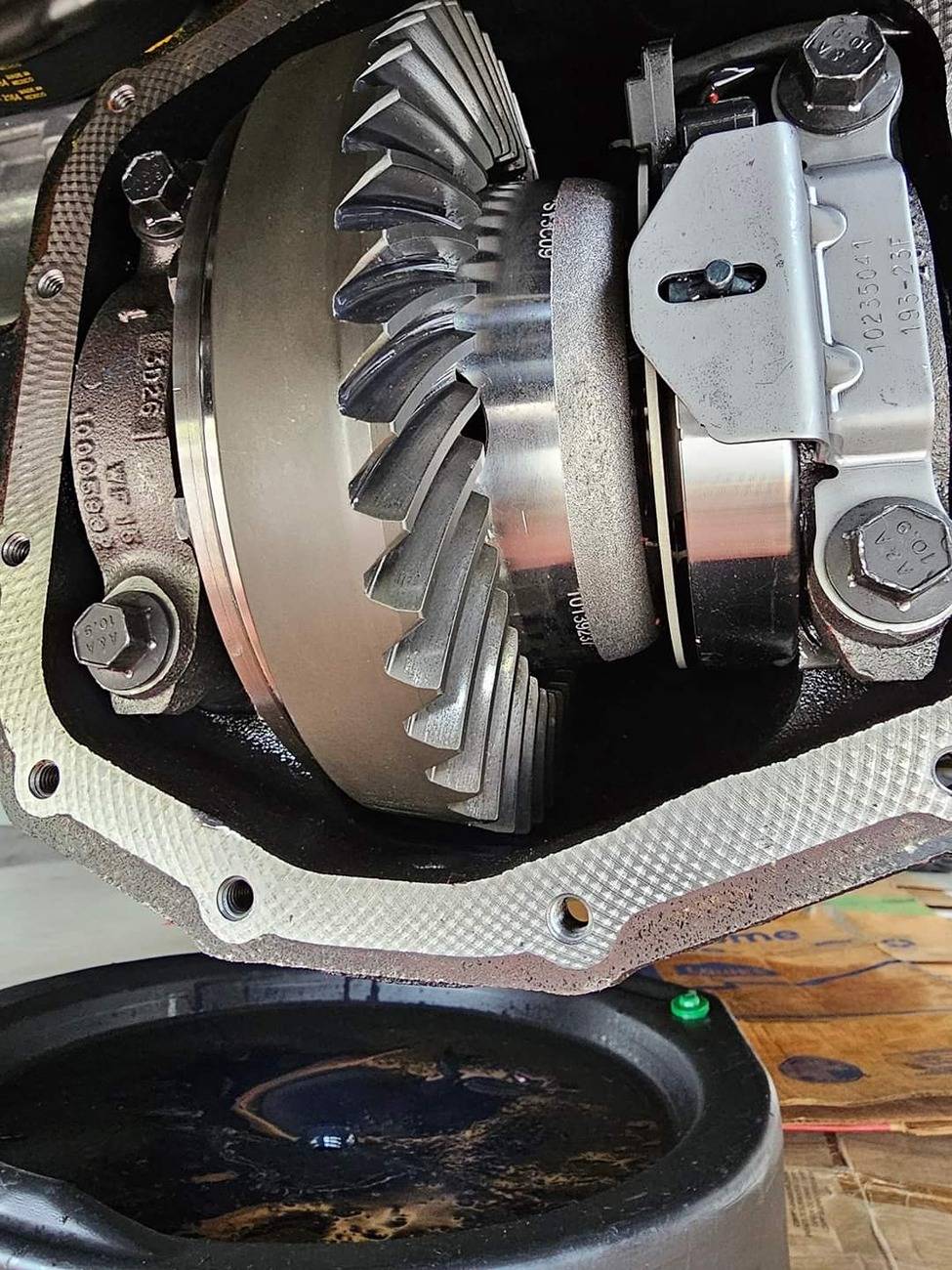

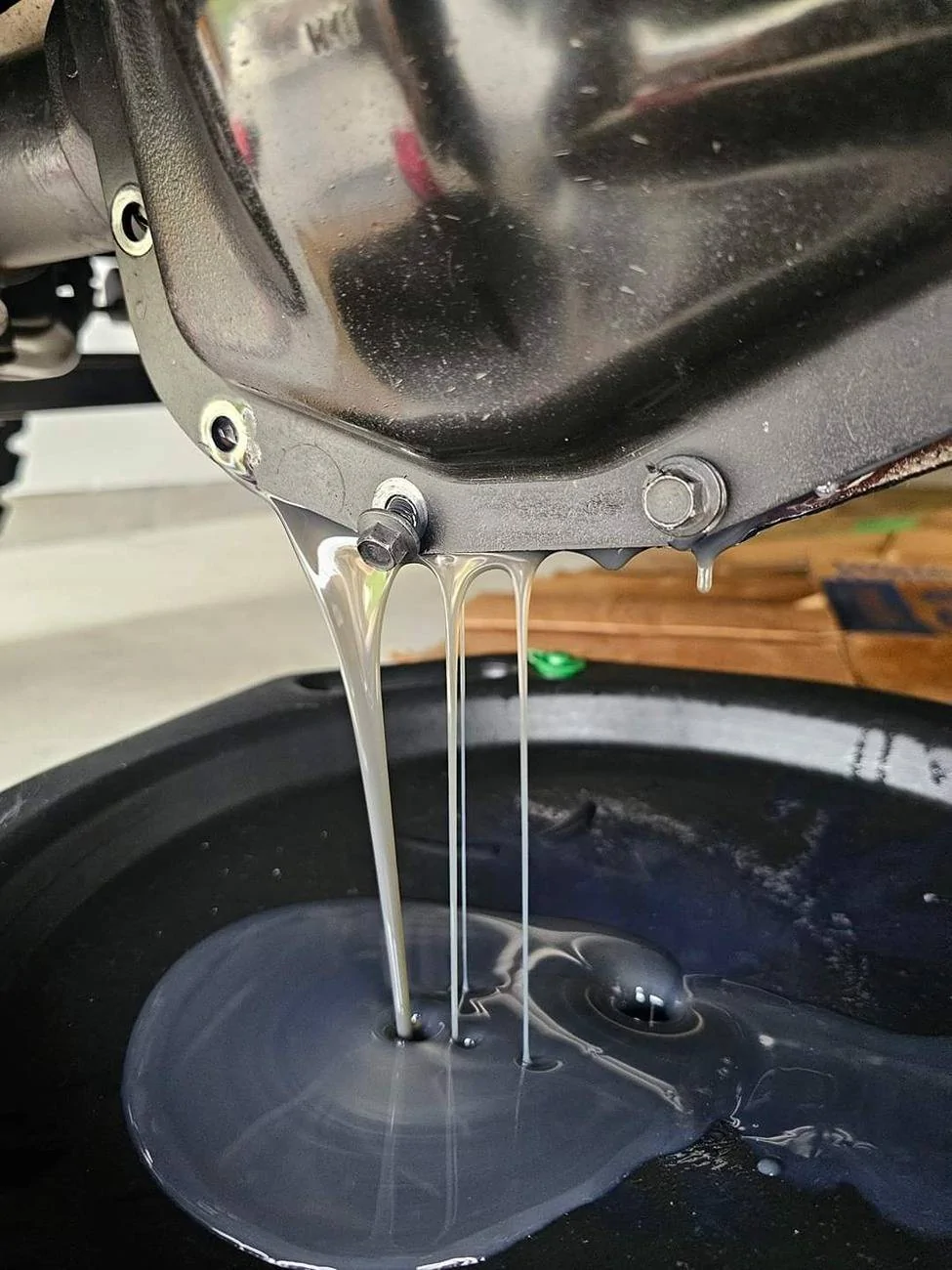

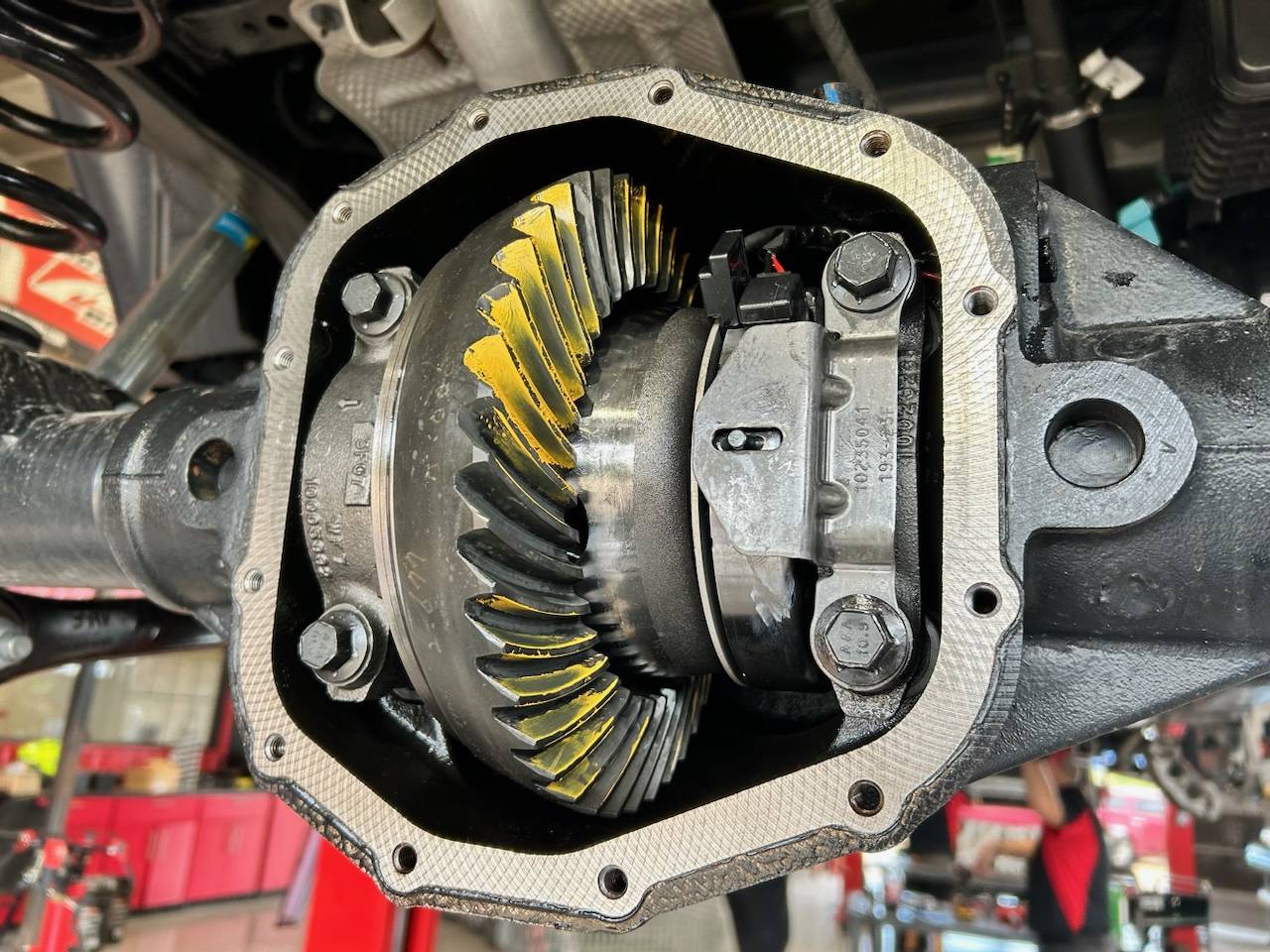

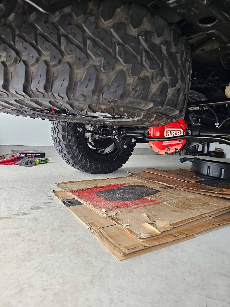

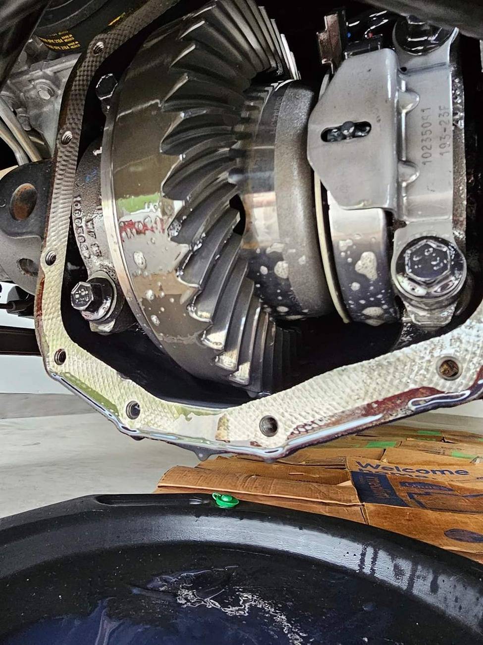

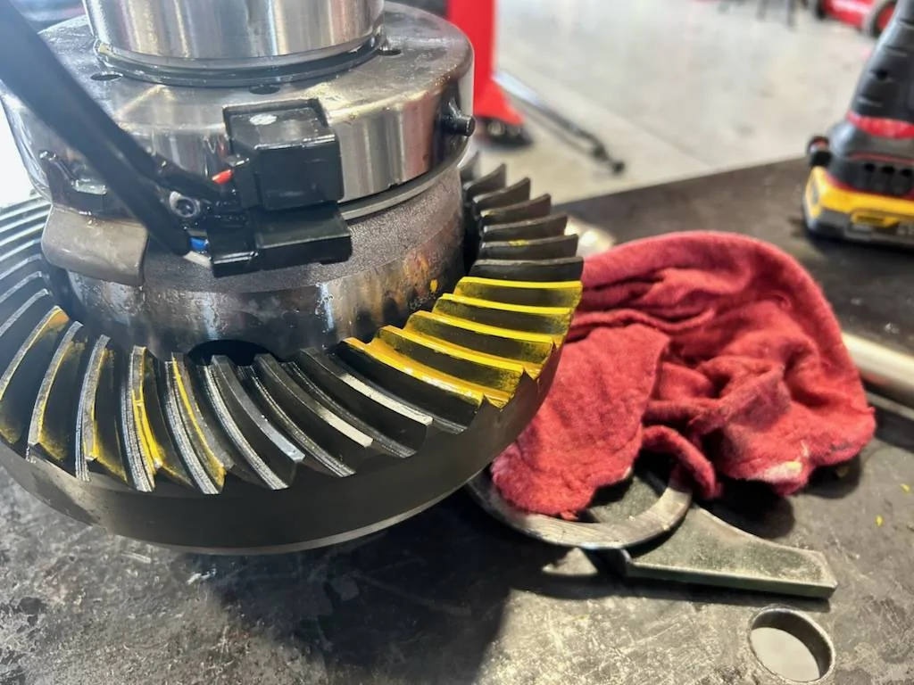

Anyone on the fence about 5.13s don't be. 4.88s are a waste with the 850RE. Feels like a Ferrari compared to the 4.10s. She has low end torque now. Will definitely chirp the tires easy on dry pavement if you aren't careful.
Jeep Gladiator 4.88s or 5.13s IMG_4284
Jeep Gladiator 4.88s or 5.13s IMG_4285
Jeep Gladiator 4.88s or 5.13s IMG_4286
Jeep Gladiator 4.88s or 5.13s IMG_4287

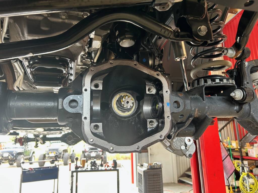

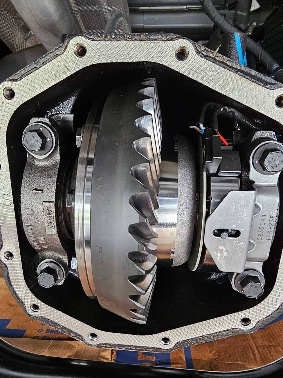

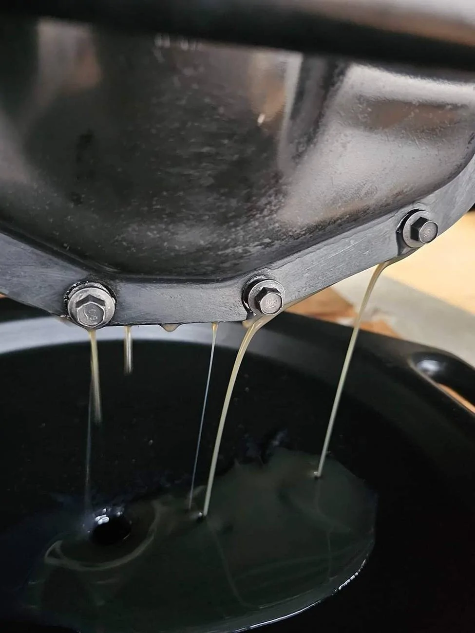

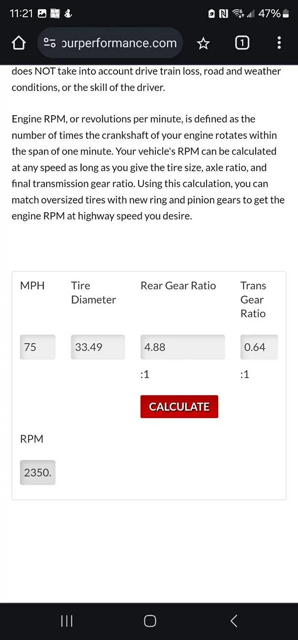

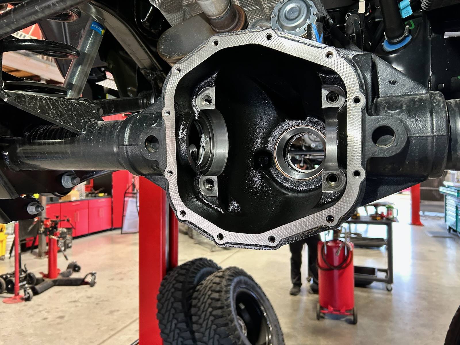

Break in completed. Love the added performance over the mall crawler 4.10s. The Pentastar really loves to be around 2200 to 2600. Under 2k zero power to hold 8th gear and depending upon speed even 7th.
Jeep Gladiator 4.88s or 5.13s FB_IMG_1725863223381
Jeep Gladiator 4.88s or 5.13s FB_IMG_1725863226063
Jeep Gladiator 4.88s or 5.13s FB_IMG_1725863228948
Jeep Gladiator 4.88s or 5.13s FB_IMG_1725863231723
Jeep Gladiator 4.88s or 5.13s FB_IMG_1725863235256
Jeep Gladiator 4.88s or 5.13s FB_IMG_1725863237868
Jeep Gladiator 4.88s or 5.13s FB_IMG_1725863240551
Jeep Gladiator 4.88s or 5.13s FB_IMG_1725863246695
Jeep Gladiator 4.88s or 5.13s FB_IMG_1725863253152
Jeep Gladiator 4.88s or 5.13s FB_IMG_1725863650853
