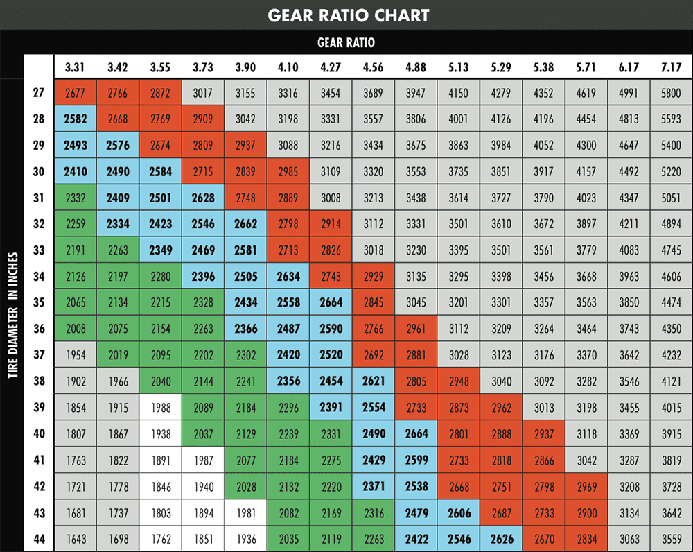

For quick comparisons.
Tire weight, extra drag from height, tread etc. not included.
Guys that complain about not getting into 8th or even 7th with tall tires are running the same effective gear ratio in 6th or even 5th.
The above chart figures at 1:1
to find your rpm in a given gear at a given speed, multiply by the gear-
A/TM/T
1st
4.71​
5.13​
2nd
3.14​
2.63​
3rd
2.11​
1.53​
4th
1.67​
1​
5th
1.28​
0.81​
6th
1​
0.72​
7th
0.84​
8th
0.67​
If you really need low gearing for rock crawling or lots of city driving go for the 5.13's, if not then 4.88's are probably fine even if you hardly see 8th gear. Looking at hp/torque curves, these things want to rev.-note not picking that argument here, this is a gear thread.
