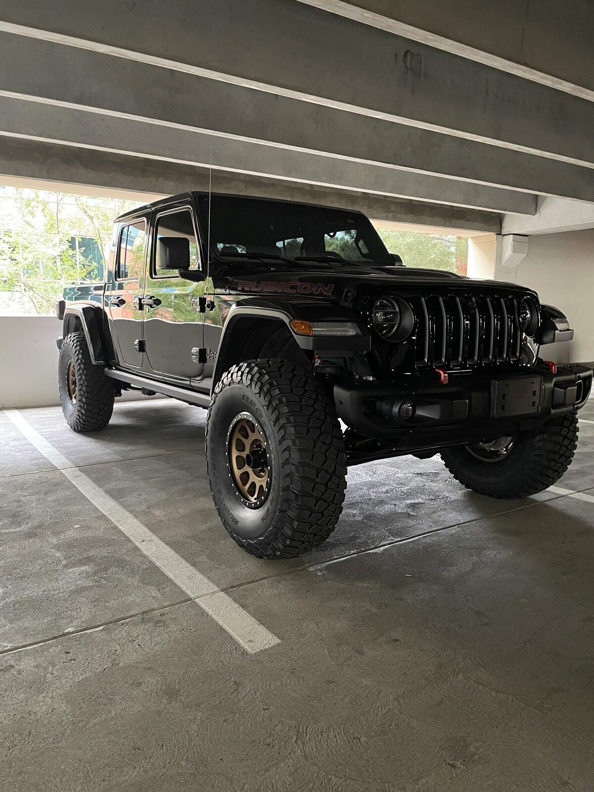

Hello Gladiator forum! I wanted to get some good advice. I would consider myself “green” to the off-roading world. Your input is appreciated!
I have a 2020 Gladiator Rubicon, with a Metalcloak 3.5 inch game-changer lift. I went from 35 inch BFG 35 inch KO2 to 39 inch BFG KM3.
Re-gearing to 5.13’s will happen next, however, I do have some concerns with axel strength. From what research I’ve done, a truss on front/ rear, RCV axel shafts, could help. But would it really make a difference?
I appreciate your responses!

what are your rim specs?

I have nothing to add except your truck looks totally badass.

What’s the overall height on your jeep? Just curious if 39 or 40” would fit in my garage.

Tbh, I’ve never measured! It fits in 6ft 4 parking garages and I have about 2 inches of room left before I smash the roof haha... it fits in my small townhome garage 🤷‍♂️
