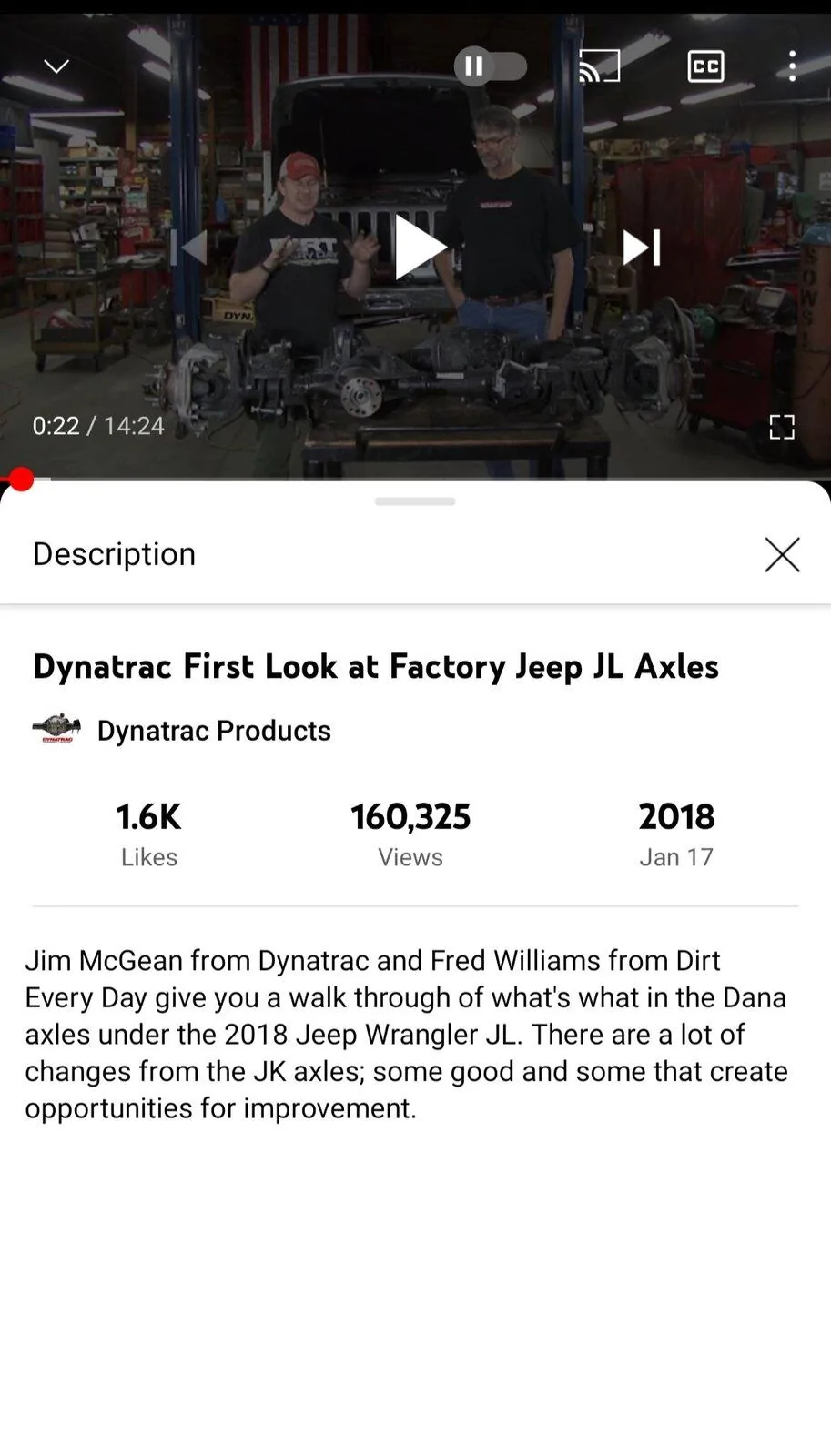

I've seen/heard it in a couple of places. One of them was an interview with an engineer when the JT launched two years or more ago now. Unfortunately, finding that link today would be like trying to find a needle in a haystack. But apparently it is true, the axle tube thickness increased to handle the additional payloads and trailering weights they were targeting with JT design.
The part that has been so confusing is the difference between the standard and "wide-track" axles. A list of differences between the two that's 100% accurate has been impossible to find. There have been rumors of higher spline count axle shafts in the wide-tracks, thicker axle tubes only on the wide-tracks, larger ring gears, etc. Nothing has been shown with proof.
The only thing we know for a fact is that certain parts of the axles were made smaller to acquire higher MPG for CAFE scores. So we ended up with weaker parts so that Jeep could save 0.002 MPG on a highway cycle test.
