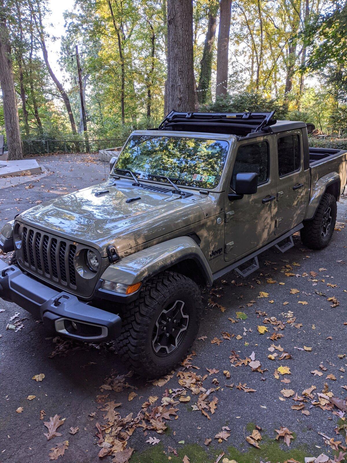

Jeep Gladiator Regearing and Tire Size PXL_20201018_135907156
So I have the 3.73's and have moved up to Rubicon takeoff Falken M/T's. I believe they're around 60 lbs, off memory anyway. You'll feel the truck works a little harder with them, especially up hills, but absolutely still love the ride and love the look even more now. The tire/wheel weight would matter with regearing since the vehicle has to work harder to move more weight, but I have no plans on regearing. If I did, I might as well try to find some rubicon axels since I'd get lockers with it. Jury's still out on how much more wear and tear this will cause, but I'd consider within the capability of the truck. I wouldn't go much bigger than 33's with this set-up, but I'm sure others do and I'd let them speak on that.

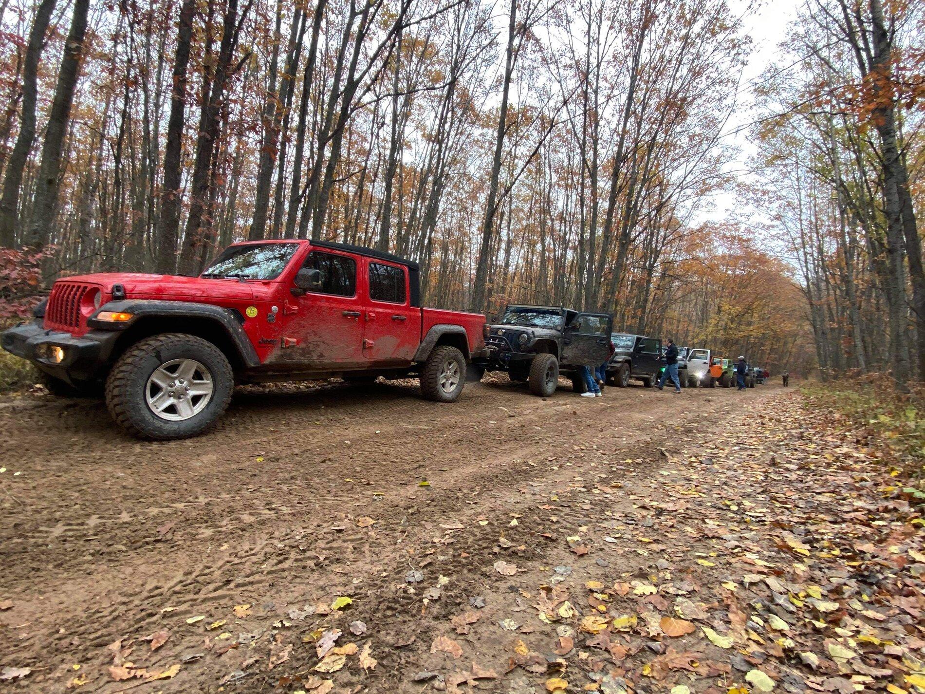

Added a Rubicon suspension (shocks&springs), then put on some 285/70/17 Cooper Evolution M/T on my stock rims with 1.75" spidertrax spacers. Love the ride quality of the Rubi take-off suspension and it's a better look IMHO.
But I have also been considering going to 4.10 or 4.56 gears because I do want to tow a 3300lb trailer and the larger tires are a drag on the trans at highway speeds.
