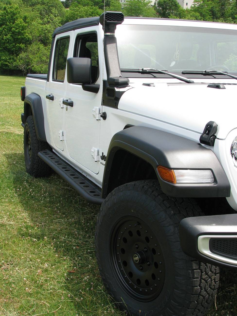

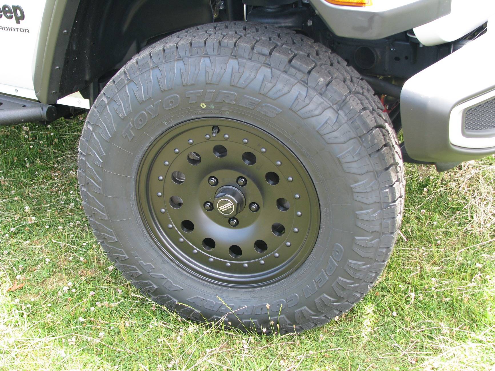

I played it safe and stayed close to one tire size above stock. Toyo Open Country AT3's in 255/80R17 With only 3:73 gears I don't want issues. They fit well.
the Sport.
